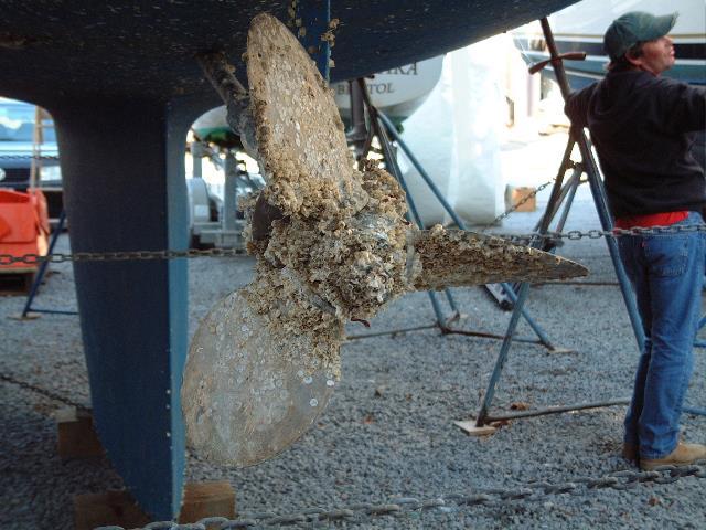

Do I need to paint my prop with some kind of primer and some kind of anti-fouling paint?
I have a new prop, the one in the pic is broken. And I have a new shaft.

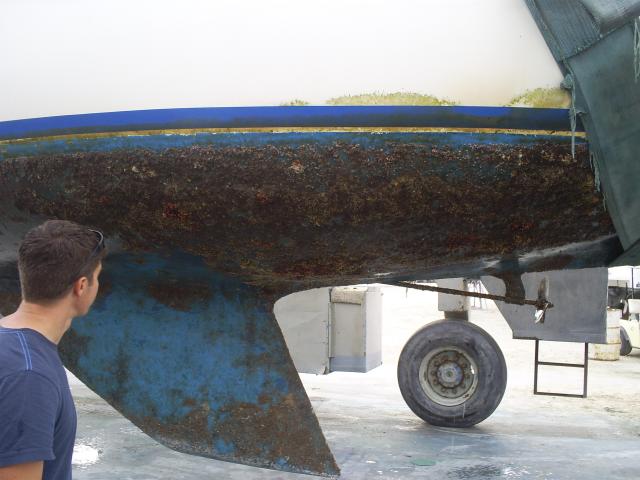

I scraped the bottom of my boat in the water and the pic of the side is what it looked like 4 to 5 weeks later when I hauled it. I have ablative paint but I am worried it will get blasted off of the prop quickly. I am worried that marine growth will unbalance the shaft and/or prop if I don't paint it with something.

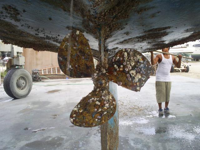

I've attached a pic of my prop (and bottom) the one year I did not paint it ...:dance: For some reason or other, I didn't do well in the Wed night races that year. Seriously, I paint my bronze prop and shaft with Interlux Primocon primer and then two coats of whatever hard modified epoxy bottom paint I have on hand. This "sort of" works in that by the time the boat is hauled, most of the paint, but not all, is gone. I typically only have a few barnacles on the prop. I don't thinik I can do better than this....

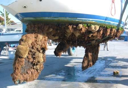

The last time the boat was bottom painted was 5 to 8 years ago. AND, no exageration, the growth I scraped off was very similar to the growth in those obscene pictures Warren posted. Except the growth on my boat was more like a coral reef. You see the stuff in the pics, it was like that but more coral, there were shrimp living in the growth. I had to scrape it in the water because I had to motor it 40 miles to a boat yard.
