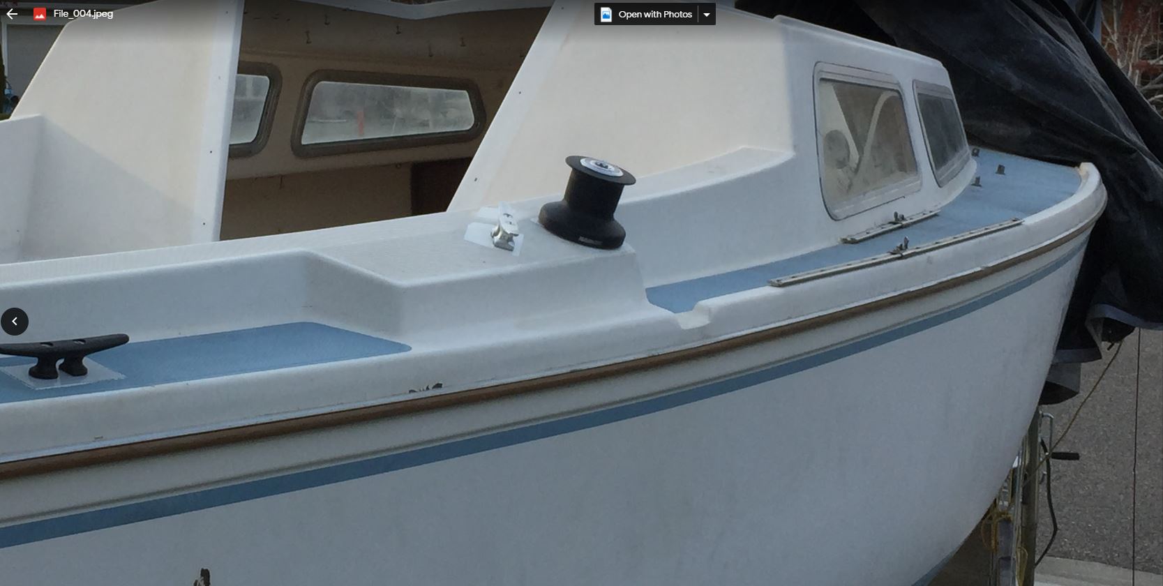

@AaronD -- serious question, you really don't use your outside track? I think my go to headsail is my big 150 -- granted I don't get a ton of wind on average and rarely use my smaller 120 , 110 and 75 -- but I love my outside rail for shape and if I could get someone (anyone?) to sell me an asym or drifter I know I'd use it even more potentially.
The only time I've opted off my outside rail is with the tiny storm jib , which I've done infrequently and usually just to see it fly. Think I might vote for keeping it around just to have the flexibility ?
Old pic-- but referential on where mine happen to land- I assume they are '73 stock locations

Thanks, @pclarksurf. Those are pretty close to my locations too, although I don't think the inside track was standard for my '81 - my outside track is the standard (if strange) Catalina 15/16" track, and the inside is a 1" with spring-loaded pin-stop cars. And agreed about using the outside tracks with a 150%. But our 150 is stashed away permanently, in favor of the code 0 - 284 ft^2 vs. ~170 ft^2 for a 150% - and prettier, too :).

Just an FYI those do not look like inside sheeting tracks. Those inside tracks in the picture look like they are more for a Bimini than sheeting cars. An inside track on the Original design (never standard and always added by a PO somewhere) typically come back 1/2 or so the way to the winches. The sheeting car position is somewhere near the aft window corner (depending on conditions) and those tracks look a little short for where the block would need to be. Just an FYI.
