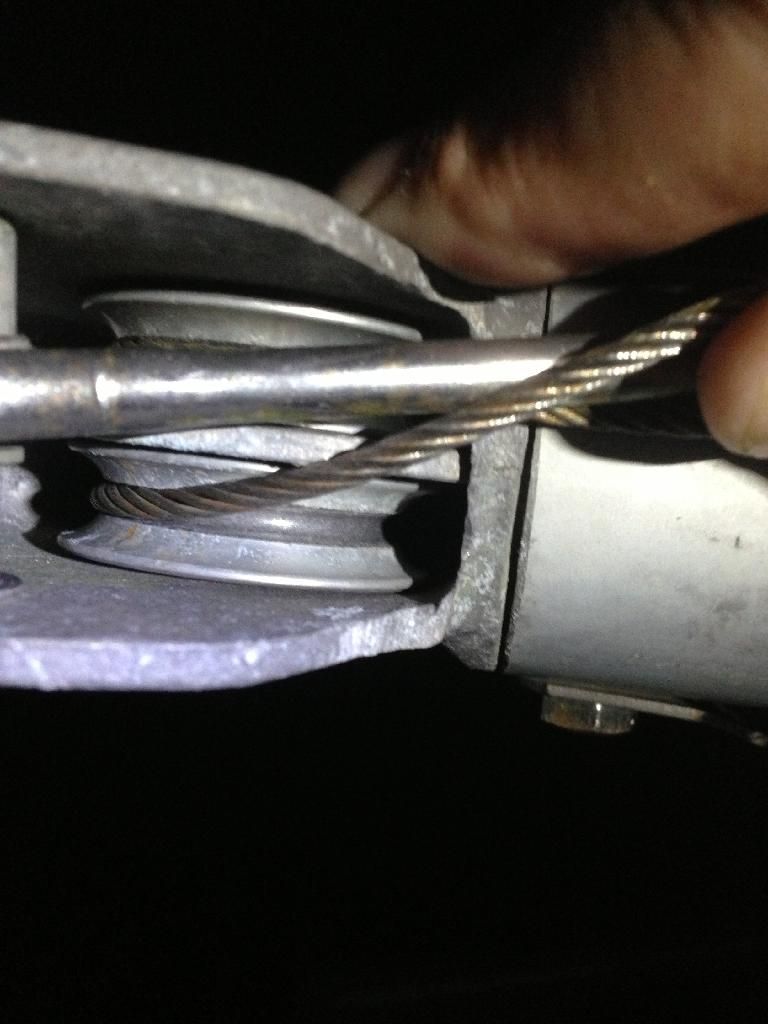

Do I need new sheaves for all rope halyard?

My current sheaves aren't "v" sheaves but they are clearly designed to accommodate wire. Will this cause excess chafe if I were to run an all rope/line halyard?

From the roughness I see at the edges of the wire groove, yes I would replace.

Those sheaves are designed to accommodate both wire and rope. There is no need to change the sheaves because you're going all rope. However, if you feel Mitiempo's comments apply I suggest you remove one for closer inspection. You could polish it with a wire brush, perhaps. The most important thing is you use the correct size rope.... it should fit snugly within the large groove, but not too large that it will ride up the sides if the halyard is pulled to one side or the other.

If it were my boat I would change them out. My thoughts are that the wire grove in the sheave would cause excess wear on the halyard.

I would change them too. Yes a rope will run in it, but you can see the 'problem'.
It goes back to a physics adage that doing two jobs, it won't perform either one well. That is, a sheave that is cut to run rope or cable.

As Joe says the sheeve is designed to work with line or wire well. And remember this is a Balboa 20, not a Farr 40. The loads are light.
The only funny part will be using a line correctly sized for that wheel, by modern line standards it will be HUGE for that sized boat.

Change them. When you tension your halyard you will be forcing the outer braid into that groove and it will be at the exact same location every time. That will definitely shorten the lifespan of your line.

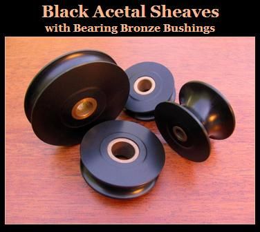

"Bringing in the Sheaves..."
When we changed out the old wire halyards to low-stretch line in our boat we only had one of those old double-groove sheaves to change and so we changed it.
If you need new sheaves, contact the guy at
http://www.zephyrwerks.com/Sizing.asp
For as small a load as you'd see on a 20 footer, 1/4" line would be fine - nearly overkill.
Heck, we have used 5/16" for over a decade on our 34 footer.

I am in the leave them be camp. Inspect them for rough edges, smooth where needed, but on a 20 foot boat the loads are just not going to be enough to have a noticeable impact. KISS.

Joe, Jackdaw, & Higgs are absolutely correct. Continue to use them UNLESS they are damaged. Going to new wire to rope halyards solves nothing, costs more, and has no benefit. Change out to rope as you planned.
I agree with Tim. These sheaves were NOT designed to have the load of a fully loaded sail and the halyard under that tension. When the halyard is fully raised the cable is in the groove.
Loren
would you go up the mast on one of those sheaves made by zephyer....
We changed out our rope/wire halyards to all line about twelve years ago on our J/36. Since we didn't feel like climbing up the mast to change them, (it's a long way up) we left the sheaves alone. We've been watching the halyards for any signs of wear/chafe/distortion/elongation ever since.
We race 'round the buoys and moderate distances (overnight), and have cruised from CT to ME twice, with trips to MA between. Plenty of wind, wave, wet. Nothing in the way of problems with the halyards or the sheaves. We haven't even end-for-ended them yet. Your axle pin that the sheaves turn on is more likely to wear out from age and wear than anything else. Rough edges on the sheaves would have been caused by the wire -- which you're getting rid of. Any roughness should eventually be worn away, and not be an issue. As stated above, you're not dealing with an 80' mast and huge loads. Making work for yourself is not what sailing is supposed to be about. Switch out the halyards and go sailing.
