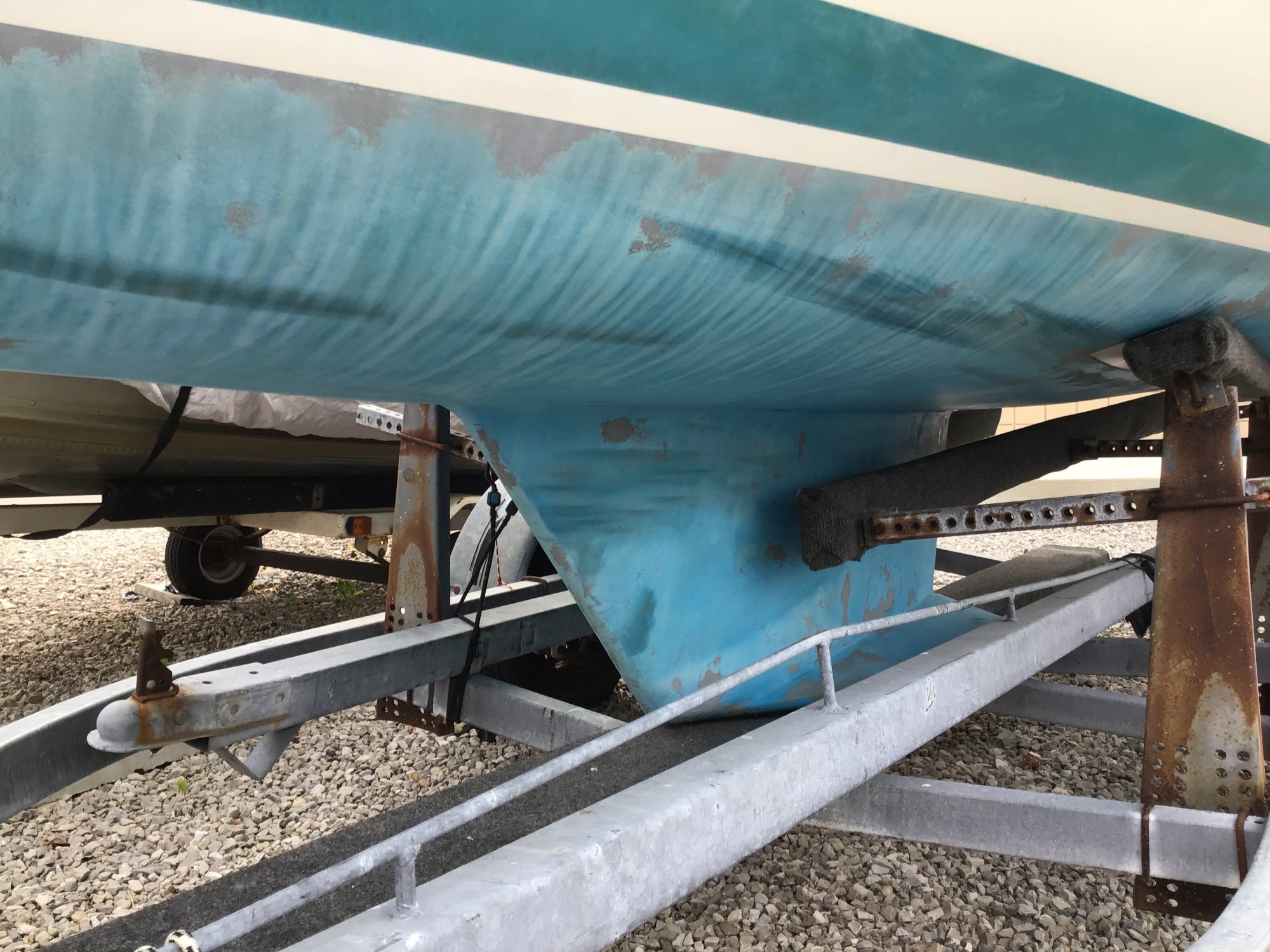

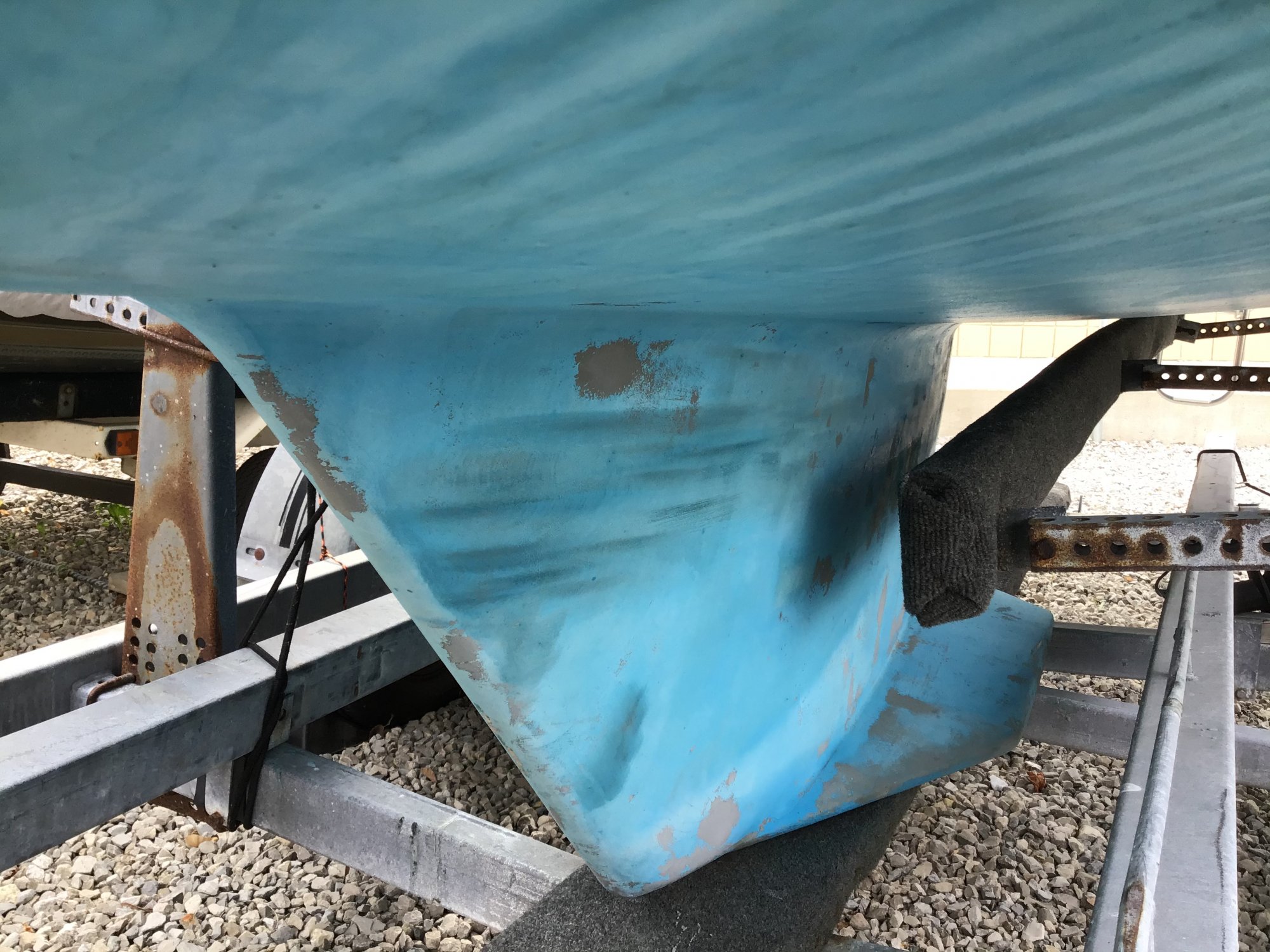

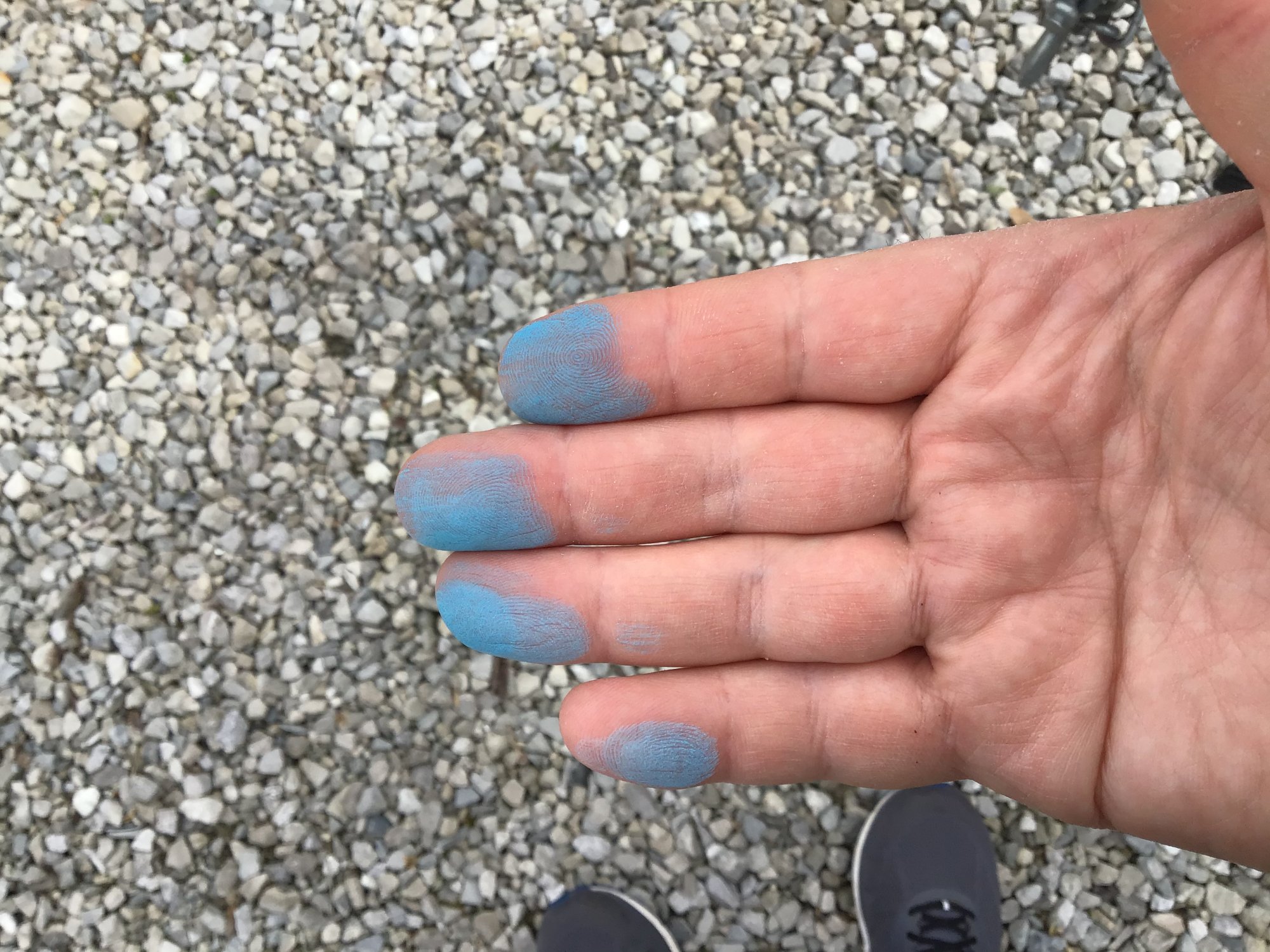

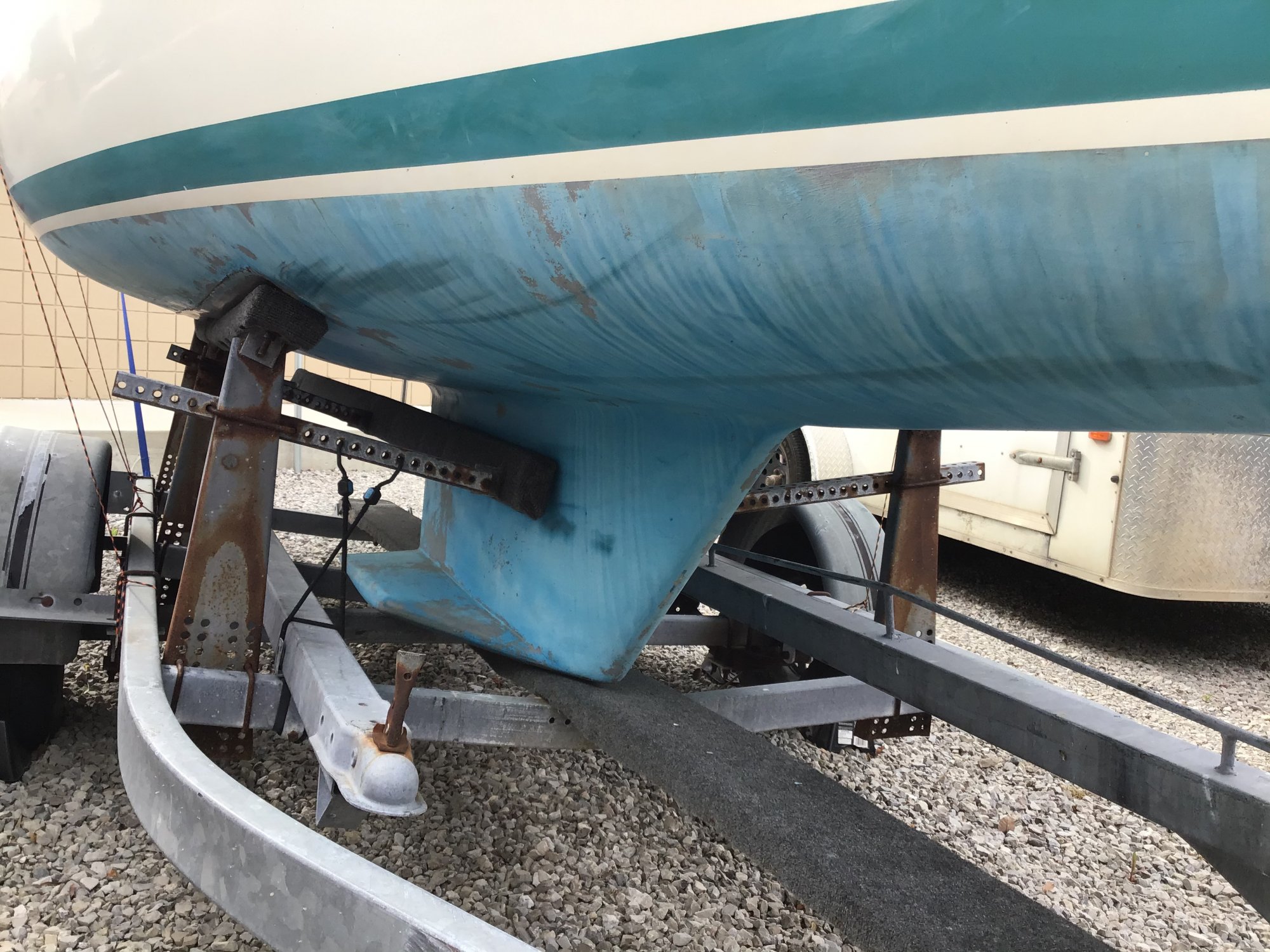

Here are some pictures of my bottom (that’s not a phrase I ever thought I’d write in an internet forum!).
it is very smooth and even. Other that there is paint on it, I would say it is ready for paint. Previous owner said other than one season in the Florida keys, it’s been a Michigan boat it’s whole life.
Not knowing anything at all about bottom paint, the last picture is the reason I believe it to be ablative paint.

Looks like ablative to me. Your bottom (the boat) looks growth free. Should be able to paint over it but product compatibility might be a concern.

Thanks for the photos....now we have a clearer idea of the paint condition and it needs a bottom paint job.

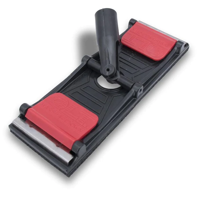

I would put some 80 or 100 grit on one of these...
Give it a quick once over to knock off the really loose stuff... then put a sheet that you don't mind destroying under the boat and give it a quick pressure wash. The sheet will catch what gets knocked off so you don't pollute the environment with toxic stuff. Let it dry out and paint the bottom then wrap the sheet in a plastic gag and toss the sheet. Then go sailing.
