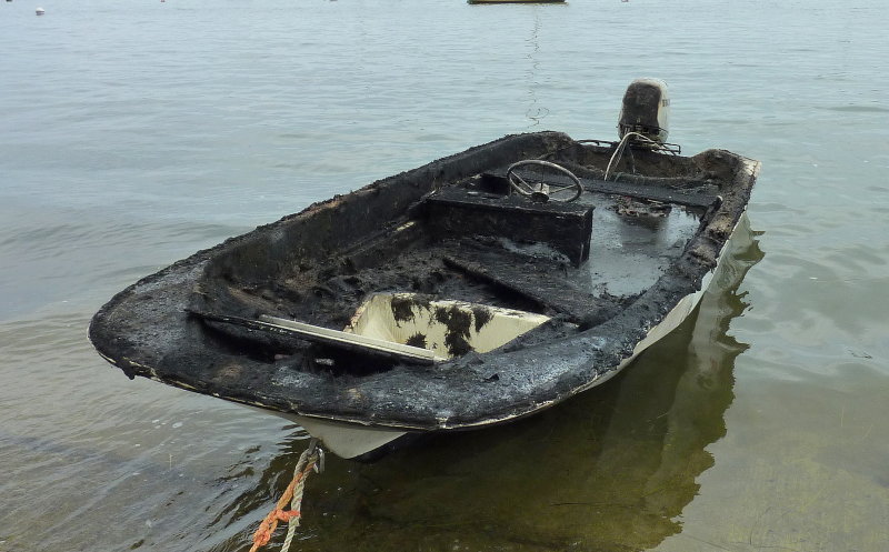

15' Boston Whaler, single group 24 battery, outboard motor - electrical short:
3 minutes prior to this fire four 8 year olds in the junior sailing program had been on board this "chase boat" They and the coach stepped off onto the dock, the coach turned around and a fire was erupting from under the bench seat where the excess length of battery cable was in a coil. Apparently it may have been stepped on or chafed just a bit too much and the single group 24 battery drove enough current into the short to start a fire and total the boat.

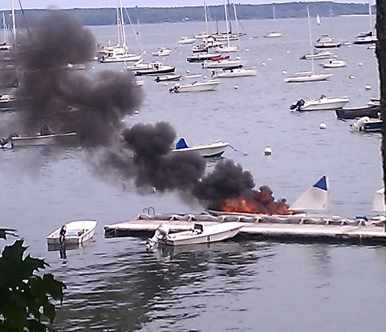

My daughter races in this program so it hit very close to home. I was there when the fire happened and was able to snap some photos. Scary stuff!! It happened extremely quickly. From the time the smoke was noticed under the seat to the fire/inferno erupting full bore was less than 20-30 seconds, according to the coach. They rushed the kids off the dock, sails still up on the Opti's, and eventually pushed the burning Whaler off the dock to save the other boats. There was no time to reach for an extinguisher when trying to focus on getting he kids off the dock. Remember these boats are "not required" to have battery switches or fuses.:doh::cussing: Not required does not mean it is not a good idea it just means it is not required. If you have a battery on your boat it is a very good idea to have it fused or to have the cables extremely well protected.
Batteries have IMMENSE CURRENT CAPABILITY!!

It could easily be our dock in the picture and we often have up to 15 Sunfish on the docks being loaded of unloaded with kids and a couple of our safety boats tied to the same docks. Thanks for the pictures. I plan to show them at my next committee meeting and I will advise others to fuse their outboards. I certainly will fuse ours.
