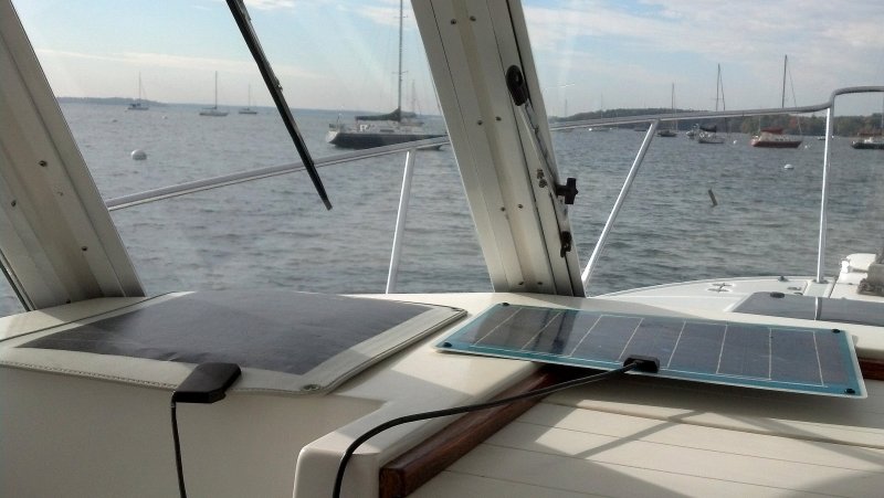

Here we have yet another bank of batteries destroyed by controller-less solar. This owner left these two panels connected and on the dash of his power boat when not there. He initially had only one but thought with the shade and all he'd add another panel. He also read, on the net, that he did not need a controller for these panels.
When I measured the battery voltage, in October in Maine, the batteries were at 14.8V at about 11:00 in the morning and one of the panels was partially shaded.....
These panels were direct connected to the house bank of batteries, about 230 Ah's.. The start battery, same age as the house bank, was not charged by the solar and remained isolated from the solar charging. The boat is stored on a mooring and only charges with solar and alternator. Alternator is set for 14.4V and ran all of 42 hours since the batteries were installed.....
Test Results:
The start battery still has a CCA rating of over 800 CCA, or nearly perfect, the house batteries, as a bank, were registering just 85 CCA or deader than dead..
Again, please be careful with controller-less solar. Even inside this cabin these panels were capable of driving the voltage over 15V...
Sorry for the bad picture all I had was my phone....
