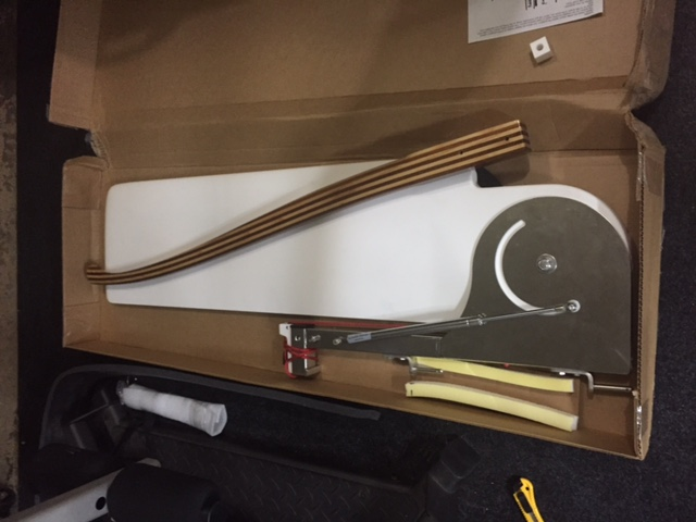

Reference the broken pintal casting a few posts above, the new toy arrived today. Glad I went with a whole new rudder instead of just ordering a new rudder casting. Will take a closer look at my gudgeons though.

Don, my existing tiller is practically brand new, and it's teak, which I prefer over laminate. AND it already has a pin epoxied in place for the autotiller. Will this tiller work with the new Ruddercraft rudder, or will I be forced to use the laminate tiller? I notice your tiller is hardwood (hickory? ash?) but it looks like you have spacers installed on either side of it?

My tiller is oak, but your existing tiller will work just fine. As you could see in the photos, I drilled another hole a little further forward for the Rudder-Craft kick-up rudder. I use the same autopilot pin on the tiller that I use for the fixed rudder. Yes, the pin is slightly not square, but I haven't had any noticeable difference in the operation of the autopilot. But, I have several spare pins,(you have to buy a bag of 5 or 6, can't just buy one, so let me know if you need one), so one day I will install another pin. As the photo also shows, I used some thin fiberglass stock to make a spacer on the tiller where the heavy duty straps are. Not really needed, but it just relieved the pressure so I can remove the tiller easier for trailering. The tiller goes in the cover and is stored in the cabin because the rudder never comes off the back of the boat anymore.
