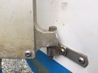

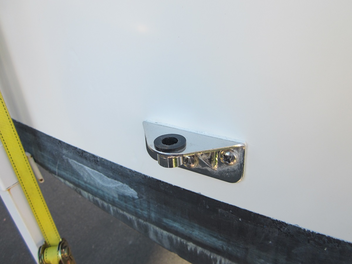

I've installed the heavy duty gudgeons on my C-22, but actually, they are from the C-250. They have a nylon, or some type of plastic bushing, and they eliminate any play in the rudder. The tiller really feels nice and tight, and secure. Plus down the road if you purchase the Rudder-Craft kick-up rudder, they are heavier, so a stronger gudgeon can't hurt. I keep the rudder on the boat all the time now and have the optional mast crutch that fits on the Rudder-Craft kick-up rudder, so with the additional weight of the mast, the extra strength helps. I have several extra sets of bushings, but after probably 5 years of use, I've never lost one, or had one fail.
I have seen 3/8" pintals fail a couple times at the C-22 Nationals I've attended. But don't forget, the racers stress the boats, and the factory rudders, especially the kick-up versions, steer like a barn door.
The attached photo shows my fixed rudder on the transom and you can see the heavy duty gudgeon with the plastic bearing.

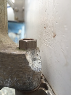

I just ordered a Ruddercraft kick-up rudder too. At the end of last season, I found the casting for the bottom pintal cracked and broken (see pics). I talked to Catalina and they informed me they no longer make the casting for the Catalina 22, but the thicker Catalina 25 casting would work - for $500. So a new kick up rudder for a few hundred bucks more was a no brainer, especially since my original 1984 rudder was looking its age. I went with the original 3/8" pintals though. Hmmmm...

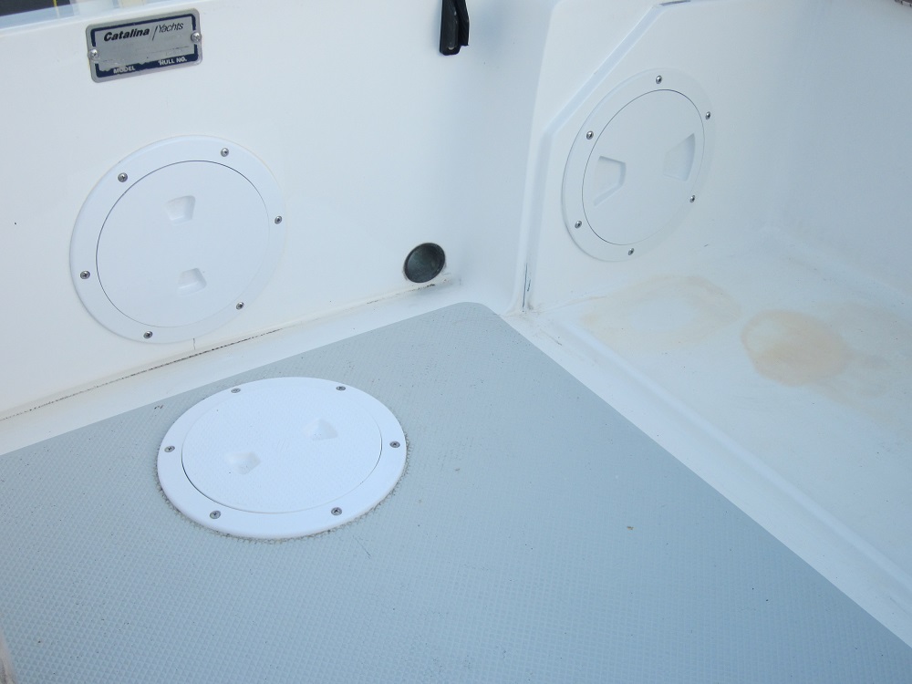

For anyone who has replaced (or even just rebedded) the gudgeons on a C22 ... did you have to install two inspection ports to access the nuts, or just one? And of what size?
Nov 19, 2008
2,129
Gene,
The rudder gudgeons screw into a piece of ~1/4" brass stock. The factory does a half-ass job of slopping some resin to hold it in place. Sometimes all you have to do is unscrew the machine screws to remove the gudgeons. Take it easy replacing the screws so you don't push the brass stock off. It's worth a try. BUT! no big deal, I have installed access ports, just don't get the cheap West Marine brand ones. Here is a photo of access ports I installed in a 1996 MK-II for access to the rudder gudgeons, and the bolts for the motor mount inside the gas locker. The better access ports are shiny smooth plastic made with UV resistant plastic. They are stronger, and the port cover screws in place for a nice water tight fit.
Here are a couple photos of the project.
Don
AH HAH, thank you for that info! That's certainly good to know BEFORE I go installing ports I may not need!

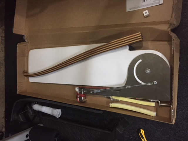

Reference the broken pintal casting a few posts above, the new toy arrived today. Glad I went with a whole new rudder instead of just ordering a new rudder casting. Will take a closer look at my gudgeons though.

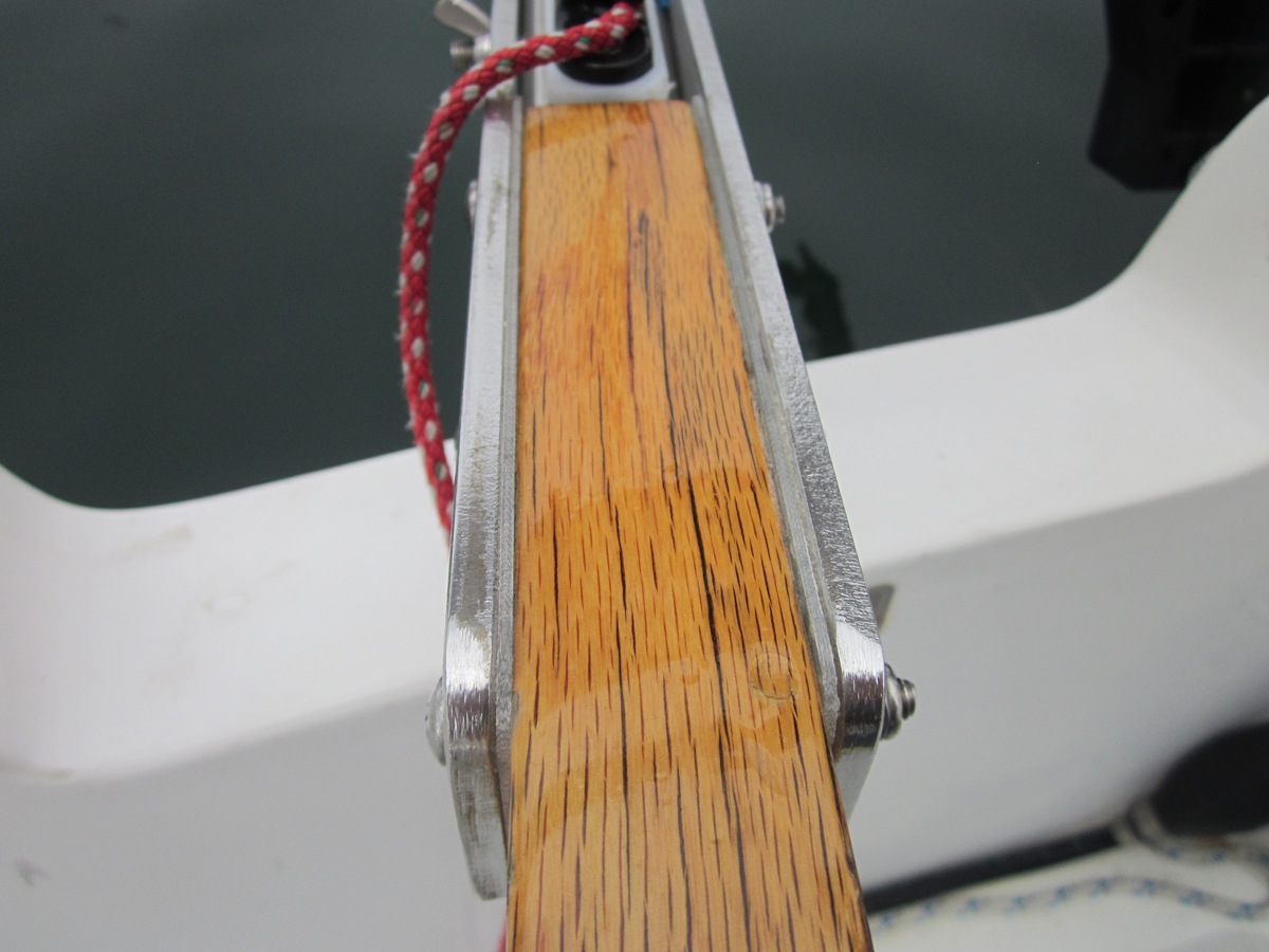

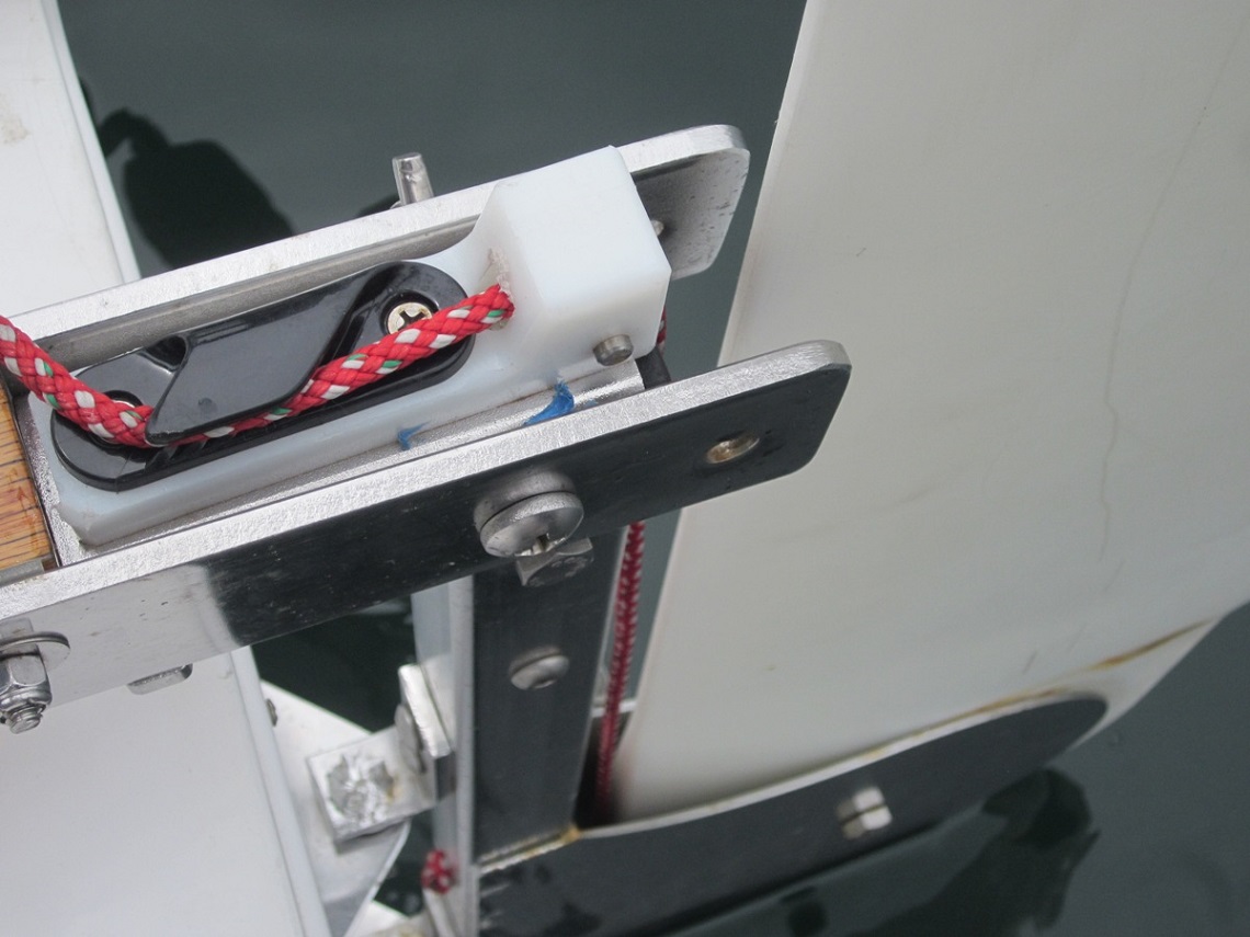

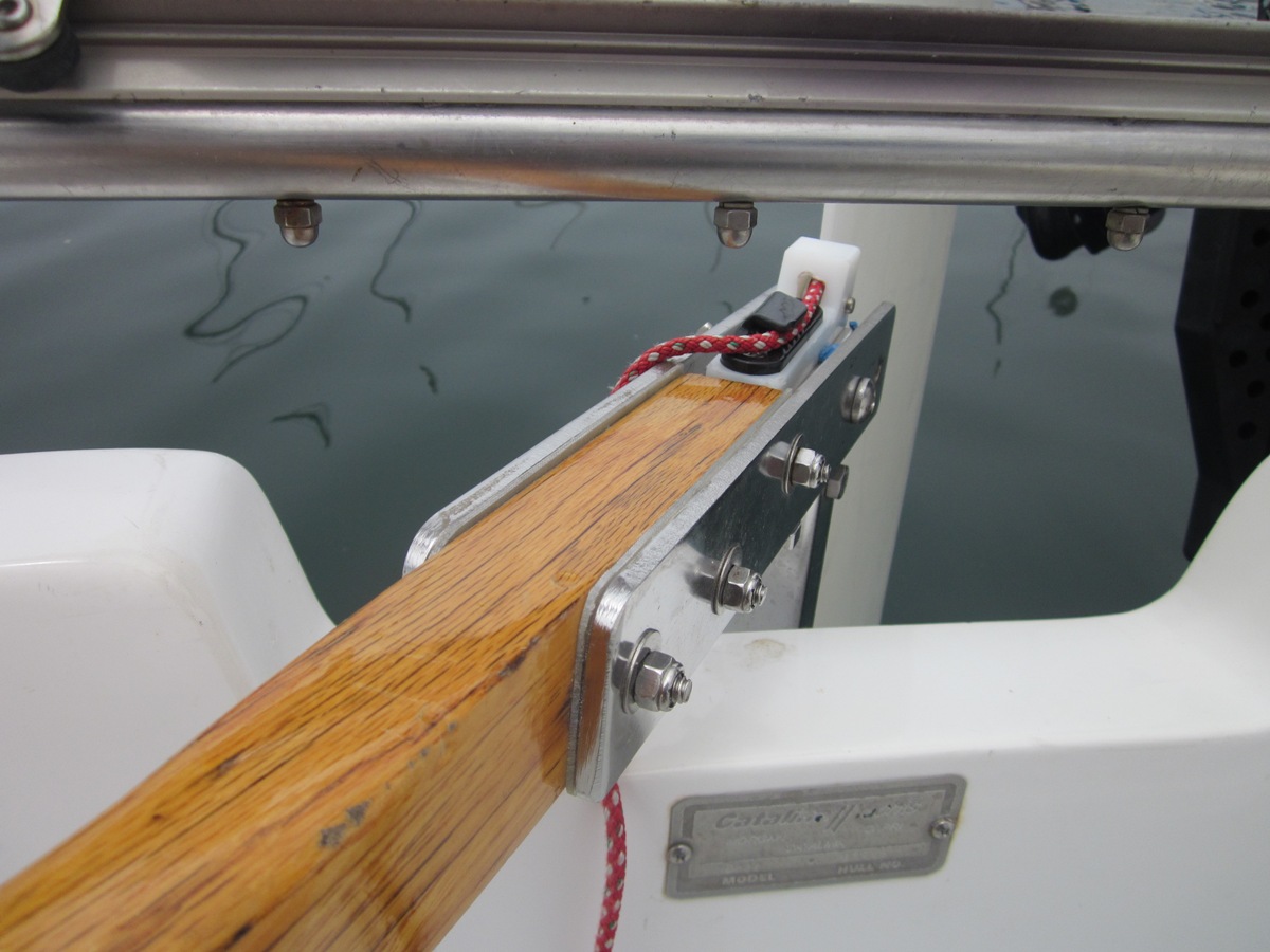

RDJ.....To make a slick installation on the Rudder-Craft kick-up rudder a set of the heavy duty tiller straps from Catalina Direct works GREAT. Unlike the factory rudder, which uses a little nub to hold the tiller up, the kick-up rudder has two little tabs on the side. They won't touch anything on the tiller, but, with the heavy duty straps, they will rest on these tabs and hold the tiller up nicely, just like the factory rudder. I did have to install some thin fiberglass scraps so the tiller would be easy to remove. You can also see where I relocated the mounting hole. This way the same tiller can be used on my fixed blade rudder and my kick-up rudder.
You're going to LOVE the difference the Rudder-Craft rudder will make to the boat!
