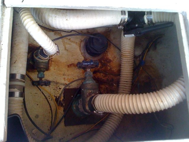

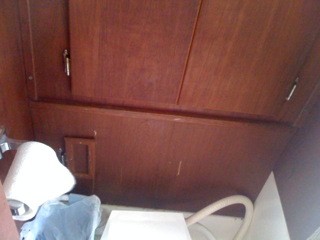

1. The tank is much smaller than I had suspected. I don't have access to it without taking out some panels, but it appears to be 9" x 30" x ?" -- I can't yet see how deep it goes, will figure that out another day.
2. The tank was over filled and coming out the vent line after all.

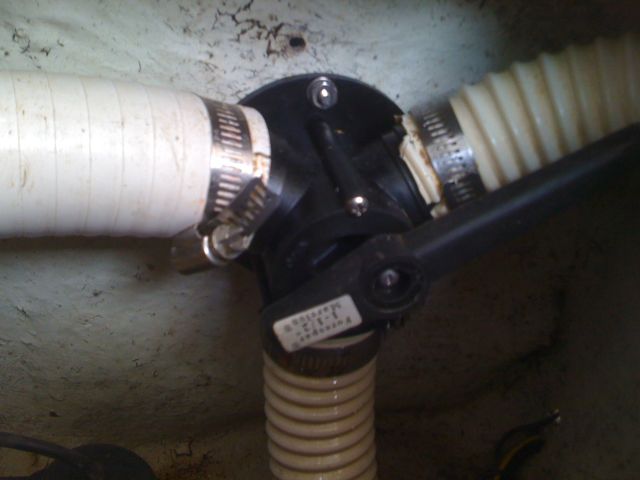

3. Ship yard simply rendered the y valve locked in the holding tank direction with a screw in the handle to prevent movement.
4. The setup has a raw water intake thruhull, an overboard discharge line and a line to the holding tank -- y valve is mechanically set to only flush to tank, via a set screw in the lever of the y valve. Fair bit of rust staining and corrosion on the thruhull valves, as seen in photo below--will clean them up and reassess their viability, however it looks like they are fitted to the hull with plywood. After I clean up this compartment I'll be able to see if there are occasional water leaks. Everything looked dry at first glance.

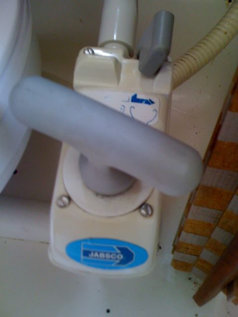

5. Jabsco flushing mechanism, I think I saw some paperwork indicating the potty as a Raritan, but I'll have to confirm that later.
Might be easier to install a tank monitor than dismantle the cabinetry to place a light in the tank compartment to aid in seeing the fluid level.

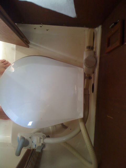

Here are some photos for starters.
I have added vegetable oil in the bowl to lubricate the soft components, and have added some tank treatment (don't recall what it was, it was there from PO). That's all the maintenance I have done (to the head at least ;)) since purchase.
Does this look like a Raritan?

You'll wish you had a Raritan, that's a Jabsco, or so says the label.

from looking at your pic's it seems you have a jabsco tolit and i also noticed you have gate valves on the through hulls......just a heads up the gate valves are not a good thing to have on through hulls ....might want to put replacing them on you haul out list ...not trying to imbarrise you just inform you

I agree I would change to proper ball valves.
The rust you see is not from the bronze valves though.

Thanks all for clarifying that the pumper being a Jabsco means the whole unit is also Jabsco -- for better or worse, a Jabsco!

Toilet is a Jabsco...a fairly old one.
You might as well throw out the manuals for any other toilet...'cuz there's no point in keeping manuals for equipment that's no longer on the boat.
Jabsco isn't a very good toilet...but it's what you have. So as long as it still works and isn't leaking water into the bowl, lubricate it, replace the joker valve and call it done as far as any TOILET maintenance is concerned. Just don't put any MORE money into it than the price of a joker valve. But the corrugated hoses I see in your photos really do need to go...among other VERY good reasons, they have to STINK!

Turns out the tank calculates out to a 7 gallon capacity. I thought I was looking at the upper half of the tank, and that there was more below. Nope! The panel where the observation port is marks the entire tank length and height (16" long x 8" high x 12" deep). I expect I could place a larger tank in the cavity in a vertical orientation ( perhaps 16L x 16H x 12D)--add that to the wish list perhaps (or to the next boat's list!)

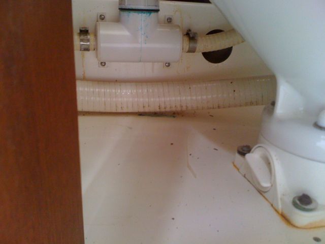

Thanks for looking at the photos and commenting on the hoses. Looking at the SBO Store, what hose brands should I be looking at: Sealand (plus), Trident, or Vetus? any to avoid? For that matter, should I replace those hoses now or wait until on the hard and replacing the thruhulls? That may not be for another year though.

Hose: Trident 101 or 102 (identical except for color).Trident Marine: Sanitation Hose
