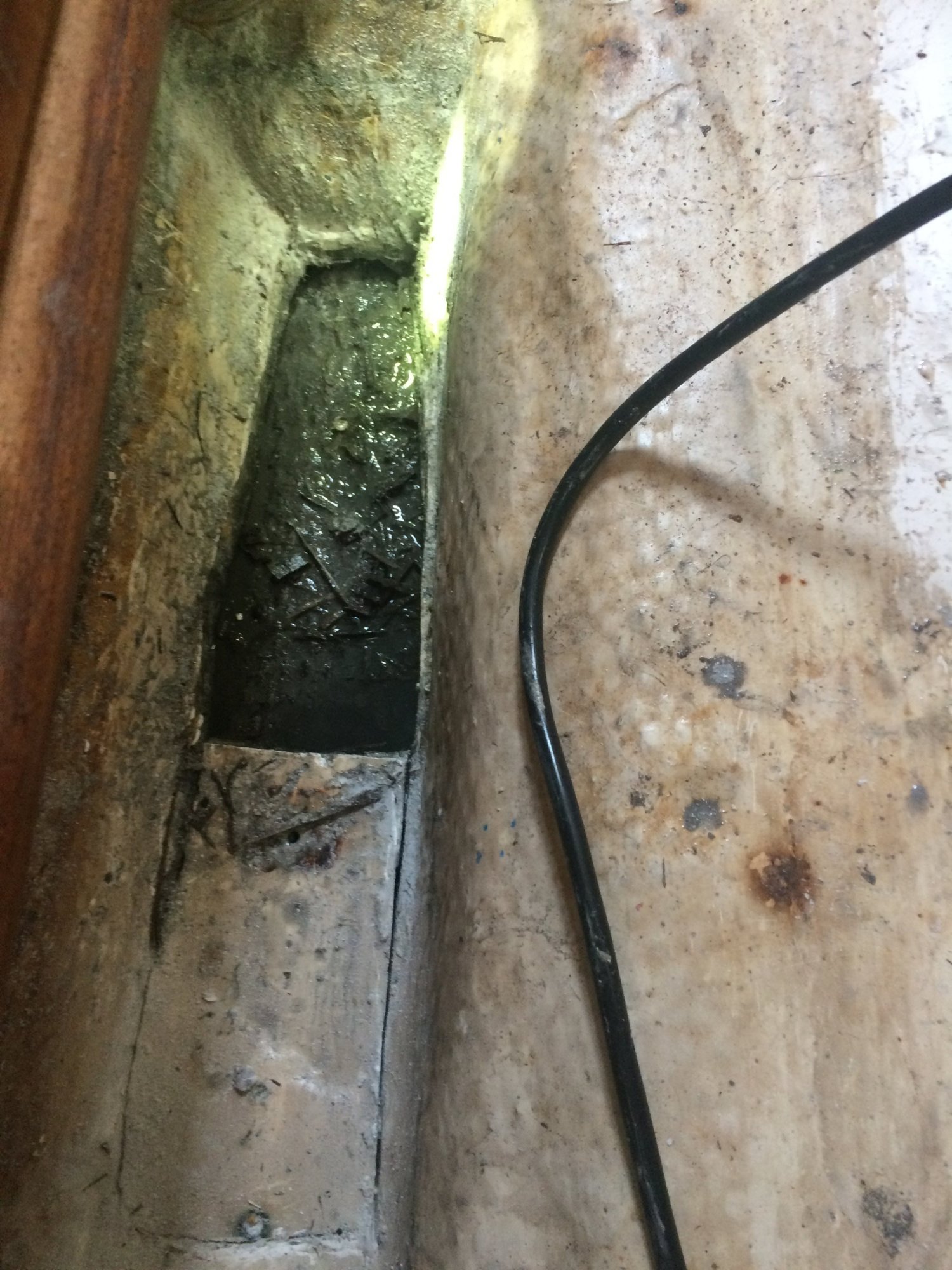

My H34’s false bilge was mostly comprised of rotten/wet wood. However some areas were solid 5200 (or some sort of hardened epoxy). So, u may have drilled into that hard stuff.
I cut mine out with a oscillating tool.

I would venture to say all the H34s were built the same way. There is a gap beneath the "sump" area that you drilled through. If that area below is already full of water (probably) it won't drain anywhere. In my case the trapped water was higher than the level of the sump bottom. After I drilled through, water began welling up. It really stank as well. After cutting through the sump bottom I found a rotten piece of plywood adhered to the bottom surface. Washing and rinsing has left no residual odor. I'm glad I did that project. BTW the hull of the boat in that location right above the keel is 1-3/8" thick. I used some very short screws to secure the bilge pump.

I’ve done this on my ‘86 H34. There is some hardened 5200 between the two layers. On mine, the 5200 covered about 30%, and still remains. The remaining portion was rotted wood which came out easily.
One day, I’ll grind out the 5200.
