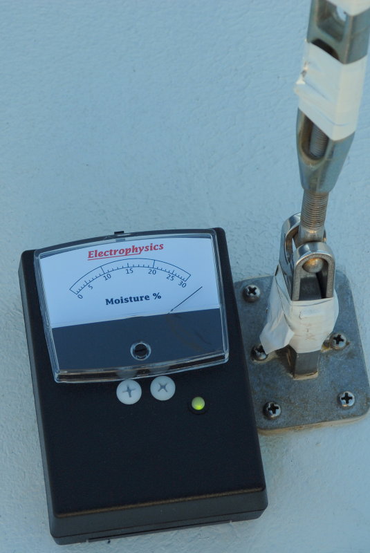

For a long time I have been a proponent of boat owners, especially those in the buying process, owning moisture meters. It's been a few years but I finally got around to doing an article on DIY use of a moisture meter.
Moisture meters can be had for well under $200.00 and will pay for themselves ten fold over your boating life. In fact they are free usually after the first use.
Please don't buy the hype and scare tactics used by "surveyors" about how "difficult" using a moisture meter is. It is fairly straight forward and easy for how and why you would want to use one. By owning a meter you are NOT circumventing the need for a real survey but you can use one to "rule out" certain boats or to create a map of the moisture in your current boat and monitor it's worsening or stability or to effect repairs in moist areas.
I know sailors are an overly "cheap" lot of folks but moisture meters, like almost any tool used by a DIY, are FREE! Think about this:
You bring your wife to look at a boat and she and you fall in love. The boat looks good and it has been cosmetically maintained and has new sails and low engine hours. You make an offer subject to survey. On the day of survey you find serious deck core rot and delamination in some critical areas and decide NOT to move forward with the deal.
At the end of the day you still cut a check to the surveyor for $500.00+ dollars and have nothing to show for it but an empty wallet!!!!:cry::cry:
If you owned your own meter you would have saved $300.00+ dollars, a day of your time, plus had a meeter to show for it that you can use on the next "specimen" in your search! On the next specimen you "rule out" you'll save the full $500.00 dollar cost of a survey and so on!
Feel free to read the article. The basic understanding needed to rule out "basket cases" or "money pits" is easy stuff! Anyone in the boat buying process, or buying a boat for more than 10k, should seriously consider a moisture meter.:)
P.S. I have zero affiliation to Electrophysics but do find the CT-33 to be the current best value in a DIY moisture meter. I used to own a J.R. Overseas GRP-33 but after I dropped it off a boat onto a tar parking lot I replaced it with the very similar CT-33. The GRP-33 had paid for it's self about 30-40 times over by the time I stupidly dropped it by not zipping my pocket!
Understanding The Moisture Meter / Electrophysics CT-33 (LINK)

I was just about to ask if a moisture meter could be used to check for water intrusion around deck fittings. Apparently it can.
We didn't want our deck pressure washed for fear the pressure would damage the bedding of fittings on a relatively new boat. The yard went ahead and did it anyway. With a meter I can keep an eye on any water that gets in and stop it before rot starts.

Using the CT33 has worked out pretty well... The results were not as I really "expected"... but that is why you get it... I could identify moist.... wet.. and CENTER of wet pretty good.....
It really has been useful for estimating what I need to do.... I went through a LOT of magic markers...
