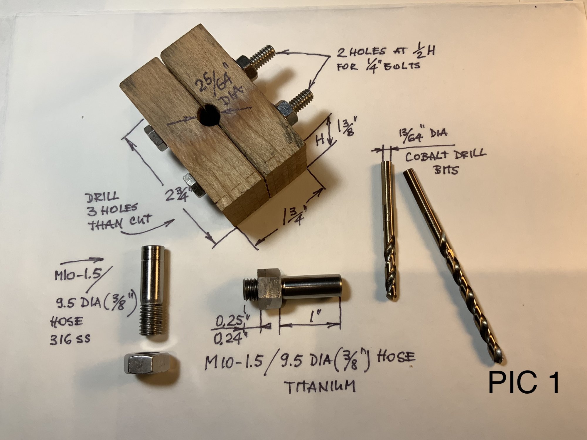

On PIC 1 are shown all required dimensions for the Ti fitting, Drilling Jig and drill bitts. Drilling Jig is made from a piece of hardwood cut on a mitre saw and holes drilled on a bench drill press. After drilling, the wood was cut by a hand saw.

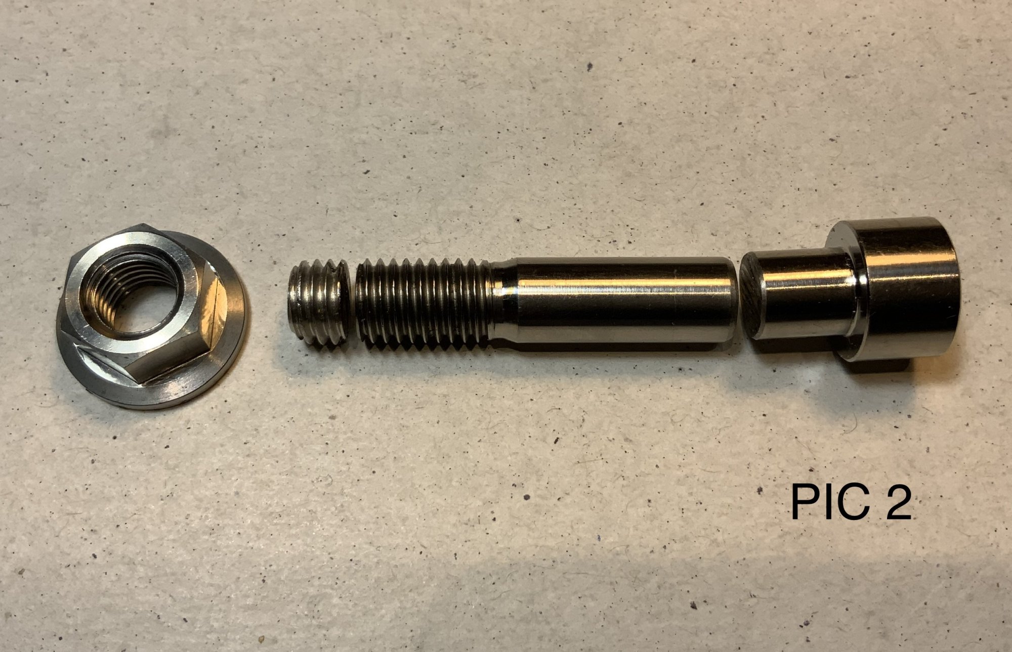

PIC 2 shows ordered 70mmTitanium bolt and flanged hex nut. Bolt was cut with a hacksaw. Both ends of the bolt were finished to required length on a bench grinder. Flange of the Titanium nut was also removed on a bench grinder.

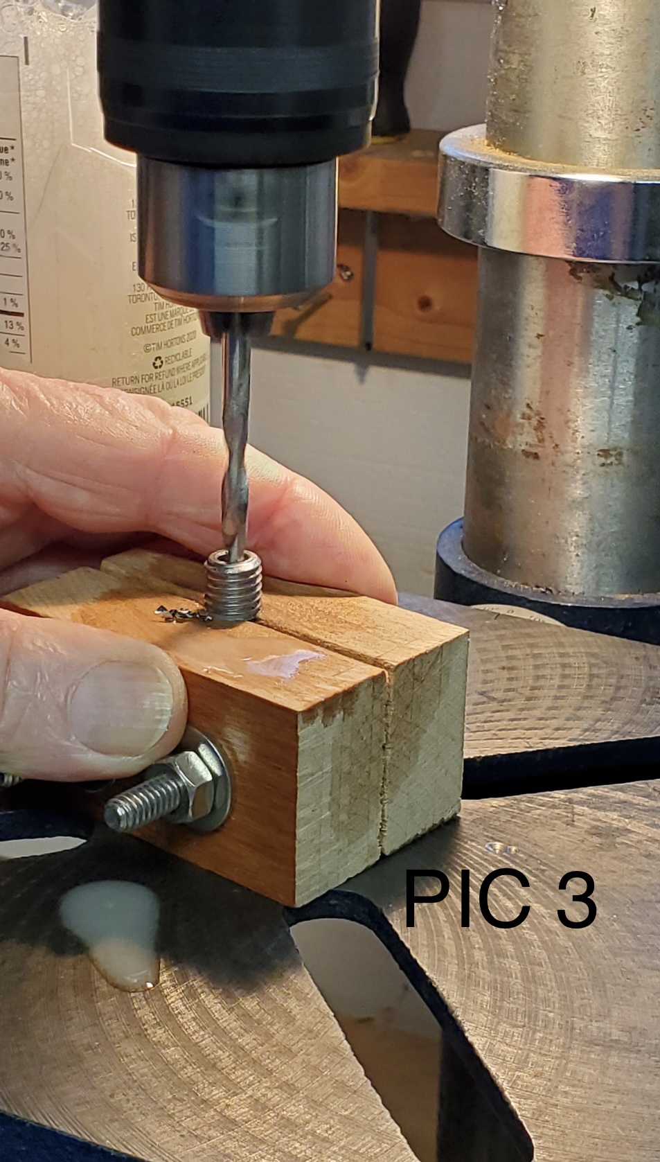

PIC 3 shows drilling hole on a drill press using Drilling Jig. This is most difficult task in modification of the bolt, but possible:
• Use lowest RPM in the drill press
• Buy Cobalt drill bits
• Make VERY FREQUENT PECKING to remove chips and to cool the drill bit with a cutting fluid
• Drill 1/2 depth from both sides to reduce heat drilling deep hole and to drill from the other side when broken drill is stuck in the hole

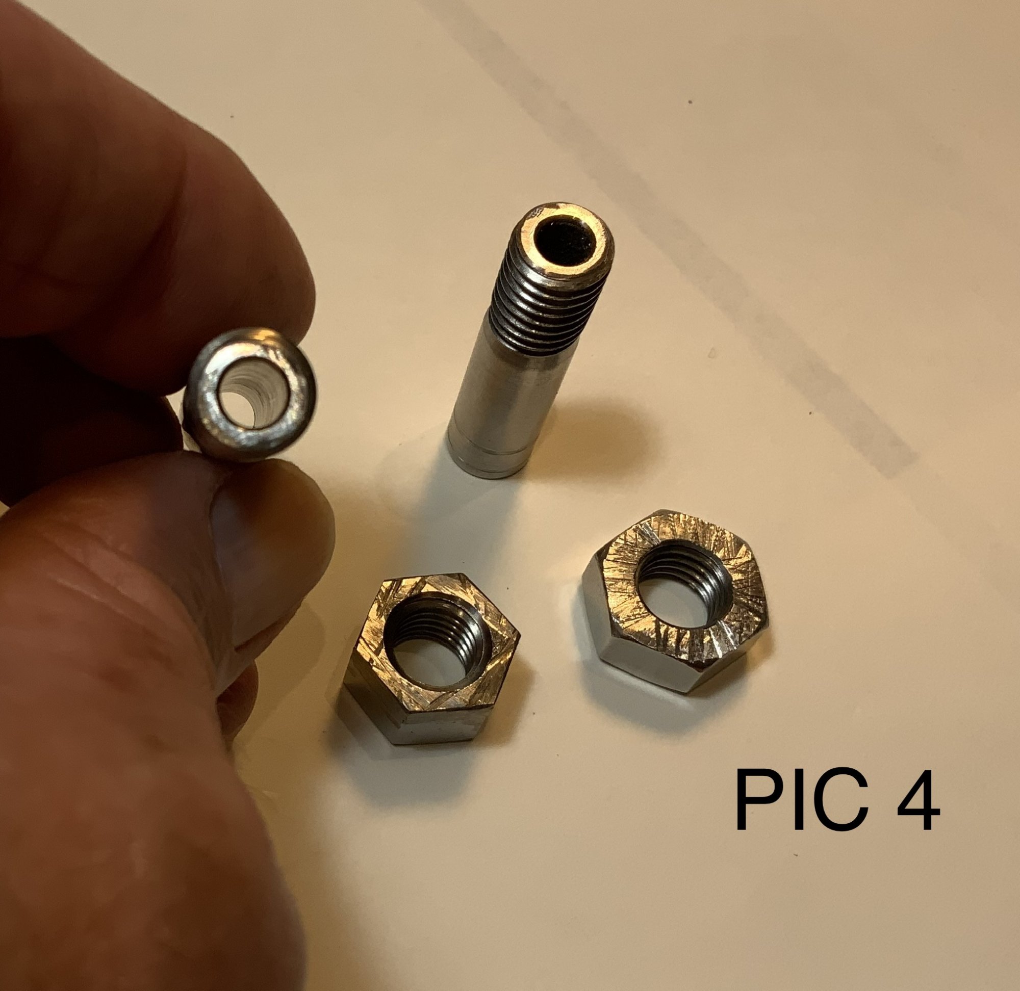

On PIC 4 are finished fittings made from Ti and SS. Score bottom of the nut and lower sides of the hex with a hacksaw. There is no need for barbs on the hose fitting; hydrostatic pressure at the depth of the fitting is lower than 1psi, and 3/8” DIA hose should be pulled-off from the fitting during haul out to check for calcium/salt blockages.

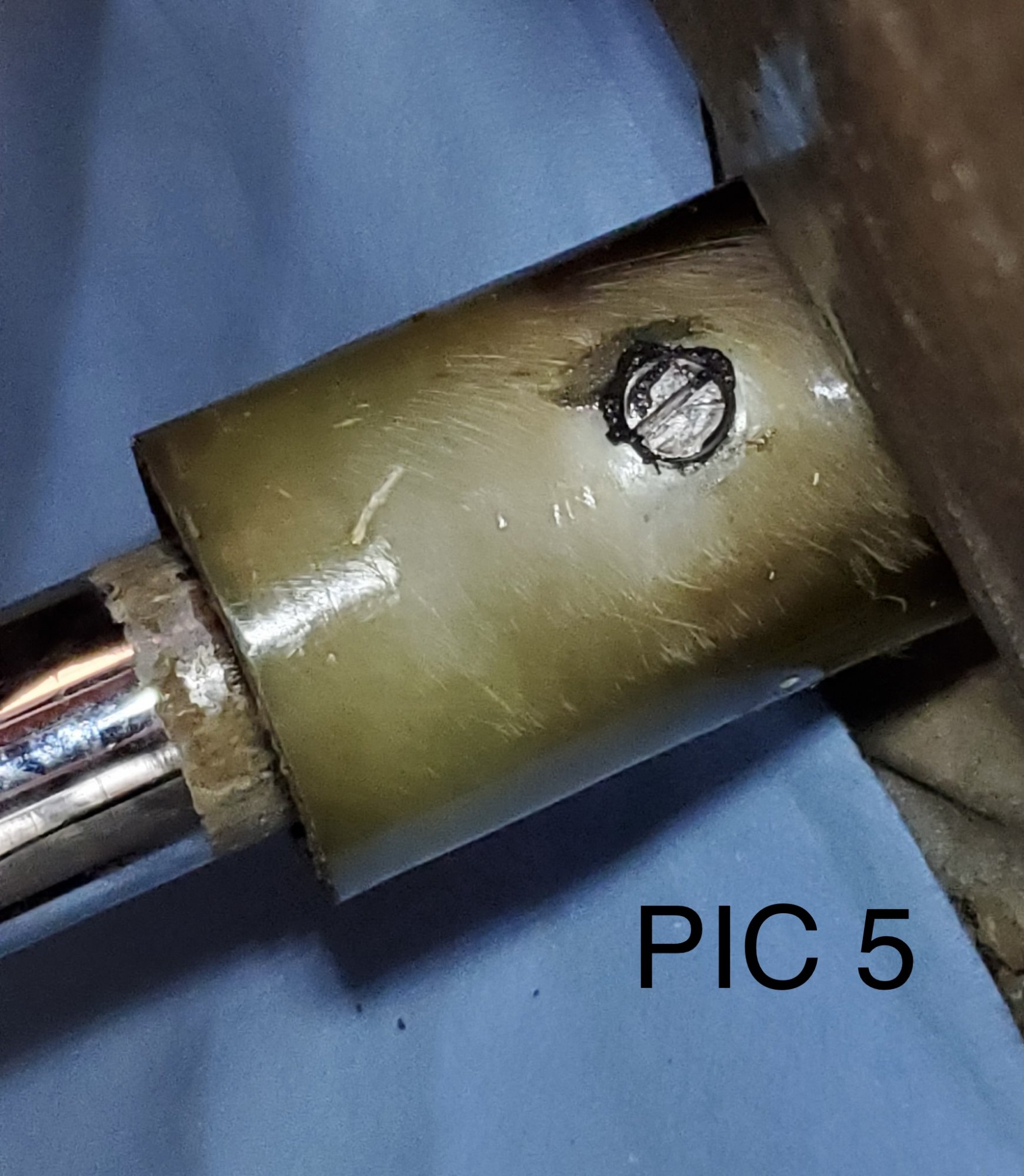

5. I did not know what thread is used and did not received response from Beneteau US. I also assumed thread is 1/8” NPT: shops in US and Canada are selling and replacing broken fittings with automotive Brass 1/8” NPT - 3/8” hose fittings (Brass contain up to 30% Zn!). After removing OEM fitting in my boat I verified thread is M10. Atached PIC show stern tube plugged with M10 screw and epoxi on the 30 year old Beneteau First. I help also to plug broken M10 fitting in Beneteau First 32.5 build in 1994. In 2020, on this Forum, BigEasy published imported OEM fitting from France which visually had M10 corse thread.

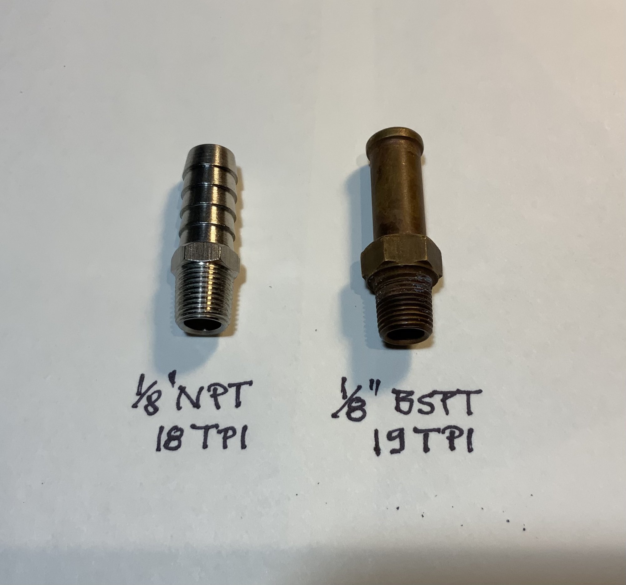

One more thing: If the stern tube in your boat is supplied with sea water from the Yanmar heat exchanger drain port and you need to replace this hose fitting, be aware that Yanmar is built in metric system. ISO adopted Imperial BSP pipe threads. The hose fitting installed in the Yanmar heat exchanger has 1/8”BSPT thread (British Standard Pipe Tapered thread). The thread is very similar to 1/8”NPT, but is not compatible. Taper and OD is the same in both, but 1/8”BSPT has 55 thread angle and 19 Threads Per Inch. 1/8”NPT thread has 60 thread angle and 18 TPI.
