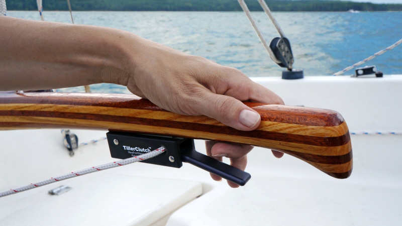

I used the Tiller Clutch.
I found it simple to use. Effective at holding a tiller position. Often times when I drifted, it was due to poor sail balance/wind gust/currents/waves all of which needed to be corrected by a hand on the tiller.
Best DIY tool was surgical tubing.
:plus: I have one. I was hesitant to drill as well but this turned out to be one of the best things I've ever bought for a boat. Worth every penny and then some
Yep, I used that on my O'day 25. Worked very well.
