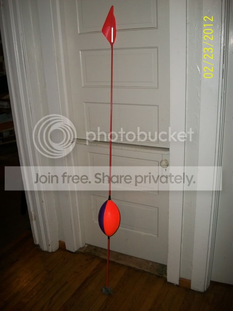

I mentioned I was going to try to build one and someone asked to see the finished product, so here it is...
Made it out of a 6' fiberglass rod ($3 Hdwr store) and a "Nerf like" foam football for flotation ($2 at dollar store) a chunk of lead for ballast (about a lb/free) and a chunk of vinyl flag for visibilty ($1 dollar store) so for about $6 I have a lightweight MOB pole.
Plan is to store on boat rail and deploy with Life Ring with about a 6' rope tied to pole to keep them together, so MOB can locate ring and Boat can locate MOB...

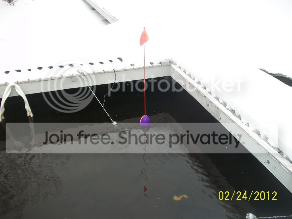

Not alot of open water here this time of year, but I do know a pier with an aerator so Ill get some water shots tomorrow...I remember the footballs floating pretty good when we played in the lake, but will see how that works in the morn...
I left the lead a little big so I can trim it down, and get balanced floatation if neccessary...
Not much is going to stand upright in 30 knot winds, including that $700 inflateable, but it's better than nothing...and if I was in the water with that pole I'm betting I would be picking it up and waveing it for all it worth...

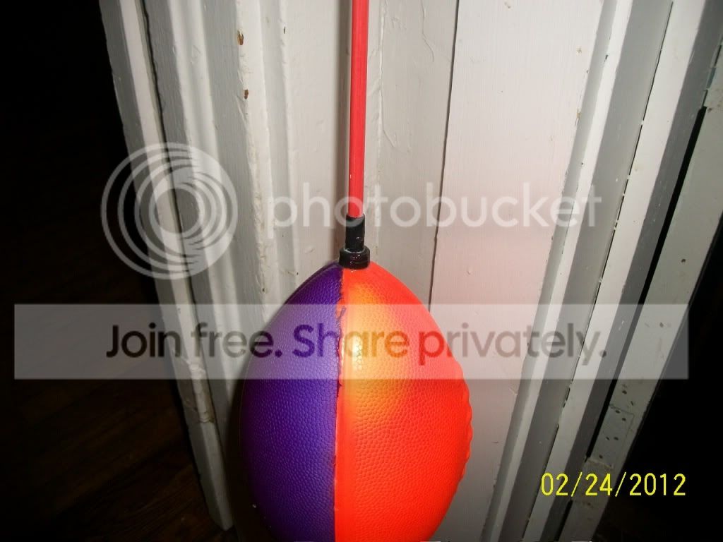

Seems to float well, a little high actually, so I'm going to add another lb of lead to help stability..."football" was in the water for a good 10 minutes and showed NO signs of water ingress, but I'll be putting a coat of clear sealer over it for added protection...
Football was attached to pole and ends sealed with 4200 adhesive/sealant, and then rubber gromets were slipped on and secured with small section of heat shrink tube...shouldn't slide up the pole...

Just below the flag is a white reflective tape (see top picture)...
Pole was made to mark out driveway edges for snowplowing/locating...
