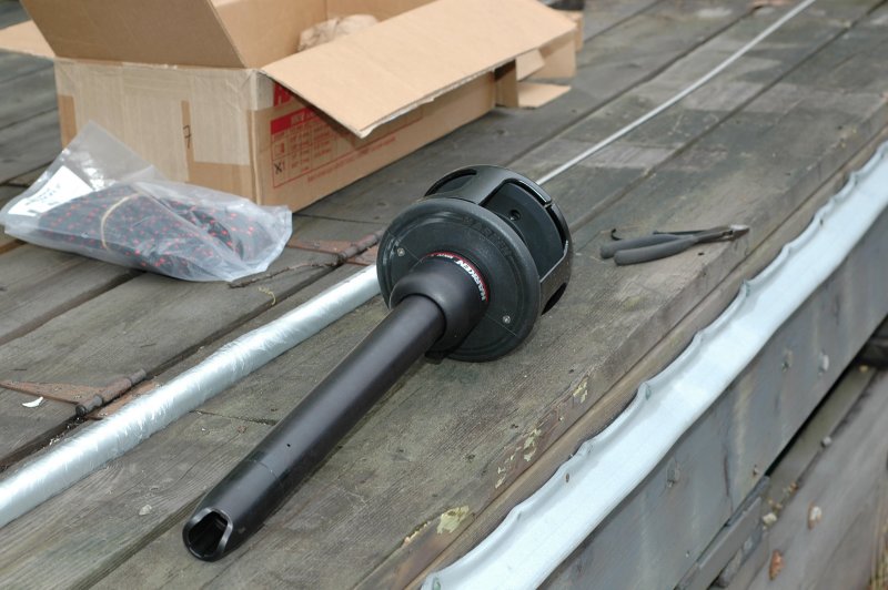

When I get a chance I will load some photos of the Harken install. I had NE rigging swage the top fitting of the head stay then I assembled the foil/furler over the new stay and installed a Norseman. Very easy and very straight forward with some good measuring you'll be all set.
Installing the Norseman fitting:
Lower unit:
The drum can slide up and it's easy (step 1):
Step 2:
Step 3:
I'll get some photos of the foil assembly when I get back to my office..
P.S. Why it furls so well..
