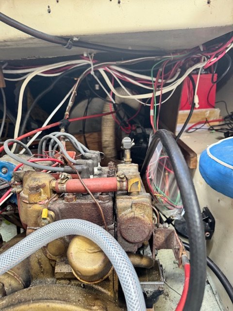

Hello all, I am looking to make a cable tray for the electrical wires going over the engine.
It won’t be long less than 3 feet long.
I want/need to tidy up in the engine bay and make it easier to work on as well.
there are a few options on the market but all are expensive.
I was thinking about using a 2inch abs pipe, the melting point is well over 300f so I don’t think it would be a problem, I would like to have our opinion on this, I believe it would be good and simple to use

I would like to instal it on the forward edge of the fibreglass panel on top

Yep, Fred you need cable management of some sort!
As for high temp resistance, anything will give your wiring better protection than what is there now, so I wouldn't fret about ,"the melting point is well over 300f so I don’t think it would be a problem, "
Also if you are concerned about code, what you have now is not in the ballpark.
Forget the Pipe idea. Feeding wires and exiting would make it more trouble than the savings.

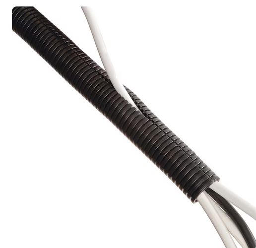

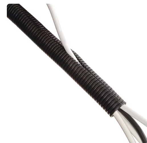

Split tube. Cheap easy and you cane separate your wiring, i.e. engine and house

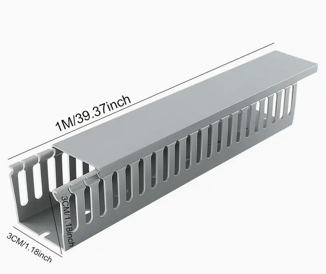

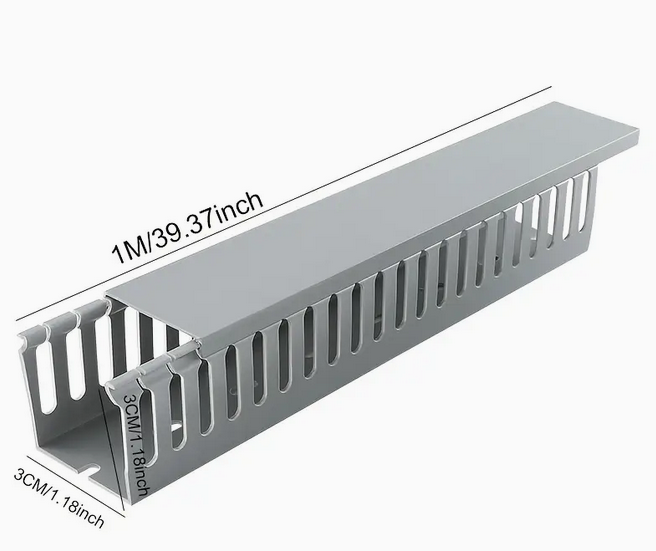

Plastic Tray easy to enter and exit wiring.. Available in many sizes.

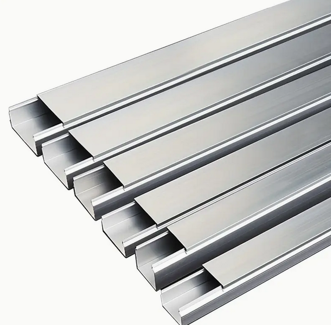

Industrial aluminum tray. Strong but would need plastic grommets to exit enter points.

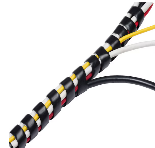

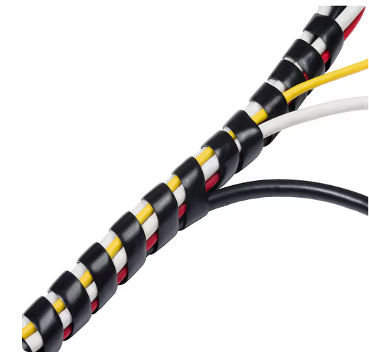

Spiral wrap.
Easy cheap and quick to attach

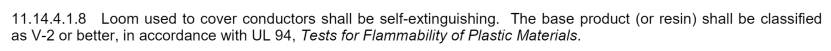

According to ABYC E-11 "AC and DC Electrical systems on Boats" - all conduit must be fire retarding. See below:
I'd suggest that all of the above suggestions be reviewed for fire retarding properties.
Fire on boats is really serious stuff.....

ABS pipe can be an issue if there are connectors on the wires/cables. This is when the split tube excels. You can add cable ties to the split tube for more security if you wish.

Ancor split loom is advertised as fire resistant, their spiral wrap is not advertised as such. However, spiral wrap is not a loom and is well ventilated, maybe that makes a difference?
That's a great question that I don't know the answer to.
But I like to keep fire potential as far from my boat as possible.

Buy a bag of 8 inch tie wraps to gather wires together in their common paths to sort out what you need to do. Split tube will probably give you the best overall look once you decide where everything needs to go without replacing and rewiring your equipment. Remove the tie wraps before putting them in the tube.
