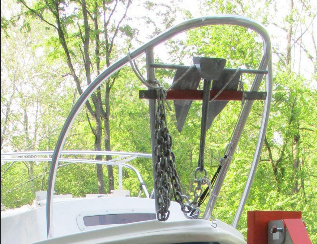

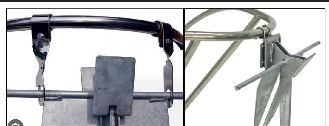

I'm looking to hang it along these "lines".. but with rope. Anyone done it or have ideas for it?
My Danforth is about the size of the 2 larger ones pictured.

On our j be oat we have something like the pic with 2 types on it, we have the left side type.
It works very well and I believe it’s not that expensive, this is somewhat the system that I tried to explain in rope format
One side is just a loop that the rod goes through and the other side is a clip that open to hold the other end.
I think I recall seeing one that the clip end was actually a spring clip tied to the pulpit.

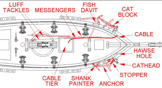

"Let go yer cat stopper, likewise yer shank painter..."
A line from Spanish Ladies; you know, the song Capt'n Quint sang as they were casting off the lines of Orca, on their way to hunt for Jaws. The cathead was that heavy beam that stuck out from the bow, just behind the bowsprit on a ship-o-the-line, from which they hung their anchor. The cat stopper kept the anchor from banging on the hull, likewise the shank painter. You had to let those two lines go to drop anchor.
