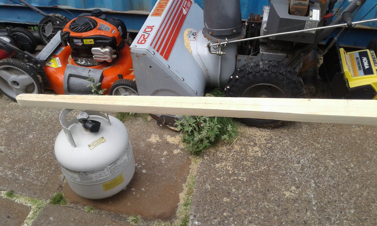

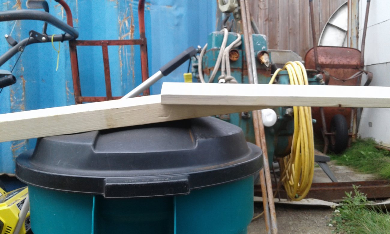

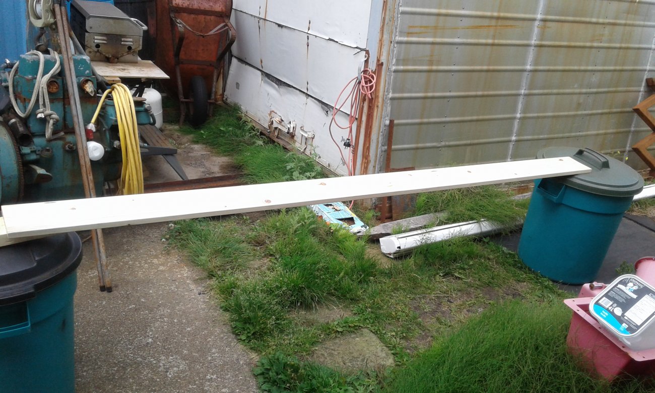

The plan called for regular off the pile 1 ea. 2X4 8ft. and 1ea. 1X6 board 8ft building supply crap put together with tight bond III waterproof glue suggested as a second choice was a weld-wood powdered glue, I actually have some but 40 plus years old and urea formaldehyde stops me there.
I used the best from the pile almost clear premium spruce 2X4X8ft. for the handle portion and a 1X6X8ft. pine board with only a couple of pin knots and I changed the angle to the Chinese best of 8 degrees from the plans 11 degree angle of the paddle blade. Now if I could only find 1 of my 2 skill saws to begin shaping the handle portion before I'm forced to buy a third to find the other two my dad did that a lot. I know where my router is to do the finish rounding of the handle however shaping must come first. An axe might also work to shape if all else fails
I've been told by the my friend, he says the true oars were made of mahogany finished with tung oil and very heavy.
I also figure the weight of my 26S with water ballast full to be less then a small to mid size mahogany or teak sampan.

Lost my two skill saws and my jig saw but finally borrowed one so the cuts are made but not glued up and bolted together yet then the router work to round off the handle portion and the back of the lower paddle and I think a 1.5X1.5 inch round topped spine about 3 ft long on the back of the glued joint. Yes it's an open air shop
