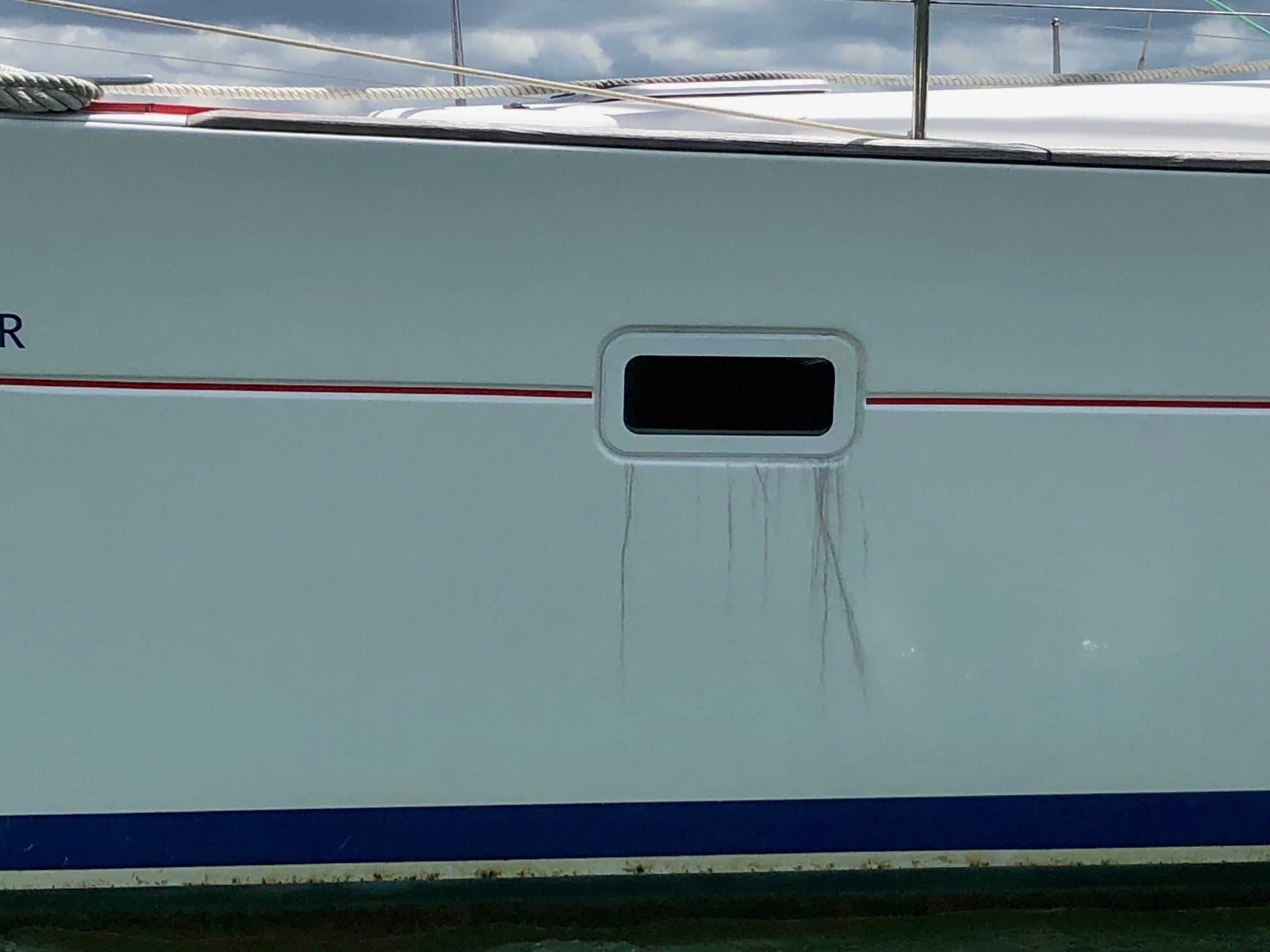

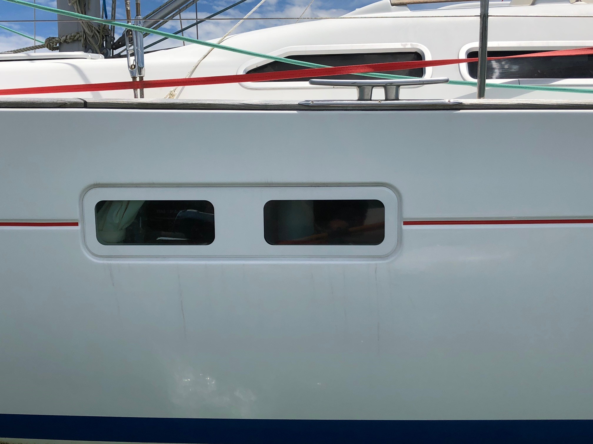

Hi there - I own a 423 (2006 vintage). She is lovely boat except for one problem - around the hull portholes over time she develops a nasty grey / black discoloration on the hull. This season I tried to deal with the issue on haul out by wet sanding the gel coat, then cut, then polish then 3 lawyers of wax. All to no avail. 6 weeks later see attached photos.
One possible thought I had is maybe it is the aluminium leaching out and running down the side of the hull? The dis-coloration will wipe off with some scrubbing and is easier with detergent but that removes the wax I painstakingly applied. In either case it still leaves a slight discoloration.
Any suggestion on causes so I can fix the problem? Any solutions on treating the symptoms other than soapy water which destroys my wax?

I looked at a couple of for sale ads for the 423, a 2005 showed similar markings but to a lesser degree.
I am incline to think there is a gasket or silicone between the glass and the hull that is breaking down. It looks too dark and too much to be the aluminum. If you see a lot of pitting in the aluminum then maybe you are right. Weather could be a factor, acid rain, smog, but if you don't see similar problems on your neighbors' boats... . Does it need to have rained or does it happen from hose water? Does water even need to be present? Is this boat new to you? Was there a time when you didn't have this problem? Can you see similar marks on the inside of the hull? Is there a sunny side where the boat is always sitting the same way in her slip? Do you get equal markings on all hull ports? Nothing around cabin windows?
Take a camera, set it on macro mode and get close-up pics of the seal where the most leakage is and see if there is corrosion, pitting, cracking, something that could be a breakdown of the silicone or gasket. That is my initial guess.

looking at the first photo, there appears to be corrosion or deterioration around the port itself. There is apparently some kind of reaction occurring there with whatever was used as a sealant.
That is far more visible than the leaching that happens with aluminum.
The ultimate solution may require re-installing the ports with a totally different sealing material.

Hi there - thanks for suggestions so far. Yes I will take a closer look at the seal / gasket (though getting a look isn't easy owing to the angles obviously).
Boat was not new to us. It's gradually built up. It doesn't happen over night but over a period of weeks after cleaning it becomes obvious. Not happening to neighbouring boats and we live in NZ away from most smog etc so don't think its environmental. Not sun based either as on a swing mooring.
Marks are not equally distributed and don't appear to be coming from toe rails.
From everything here so far suggests to me it might be the gasket...

Someone has suggested running a bead of silicon around the windows to seal off the gasket so it doesn't produce the leaks. Anyone see any problems?

Was at boat today..... just below window. Has to be something with sealant on Windows. Have no leaks with windows but in spring will inspect. Was cold today!

I think I may have found the solution to the problem. See the thread of the conversation I had with Beneteau technical services.
Dear Sir
Here are the answers of our Spare Parts Department.
Please for any other questions contact a Beneteau dealer
Thanks
Veronique
I assume that:
  1. PMMA is the glass window / porthole (see https://en.wikipedia.org/wiki/Poly(methyl_methacrylate)) è Yes, PMMA is the glass window.
  2. Colle is “glue” è yes, colle is glue.
  3. Normount tape is something like this http://www.totalplastics.com/products/386 è under the blue tape, you have the adhesive normount.
  1. I assume “polyester” is the hull itself? è yes, polyester is the hull itself.
Second, the space between the window and the hull is very small. Do you need to removing the windows /porthole to do this è if the window is not leaking, do not touch it.
If you have to remove the windows is there another solution? I am very reluctant to remove the windows as that is a big job and could create other issues.
Could we run a silicon bead around the window to seal in the glue? Would this work? èYES, this would work. You have to clean the hull, degrease and dry the area where you will do the new seal. This new seal will be of course a silicone glue allowance. You put the silicone glue on the existing PU glue.

To what we can see from the pictures, there is no seal on the upper part of the window. In consequence, the black glue is exposed to the UV and the sea sprays.
So you need to put a seal and to polish again the hull.
