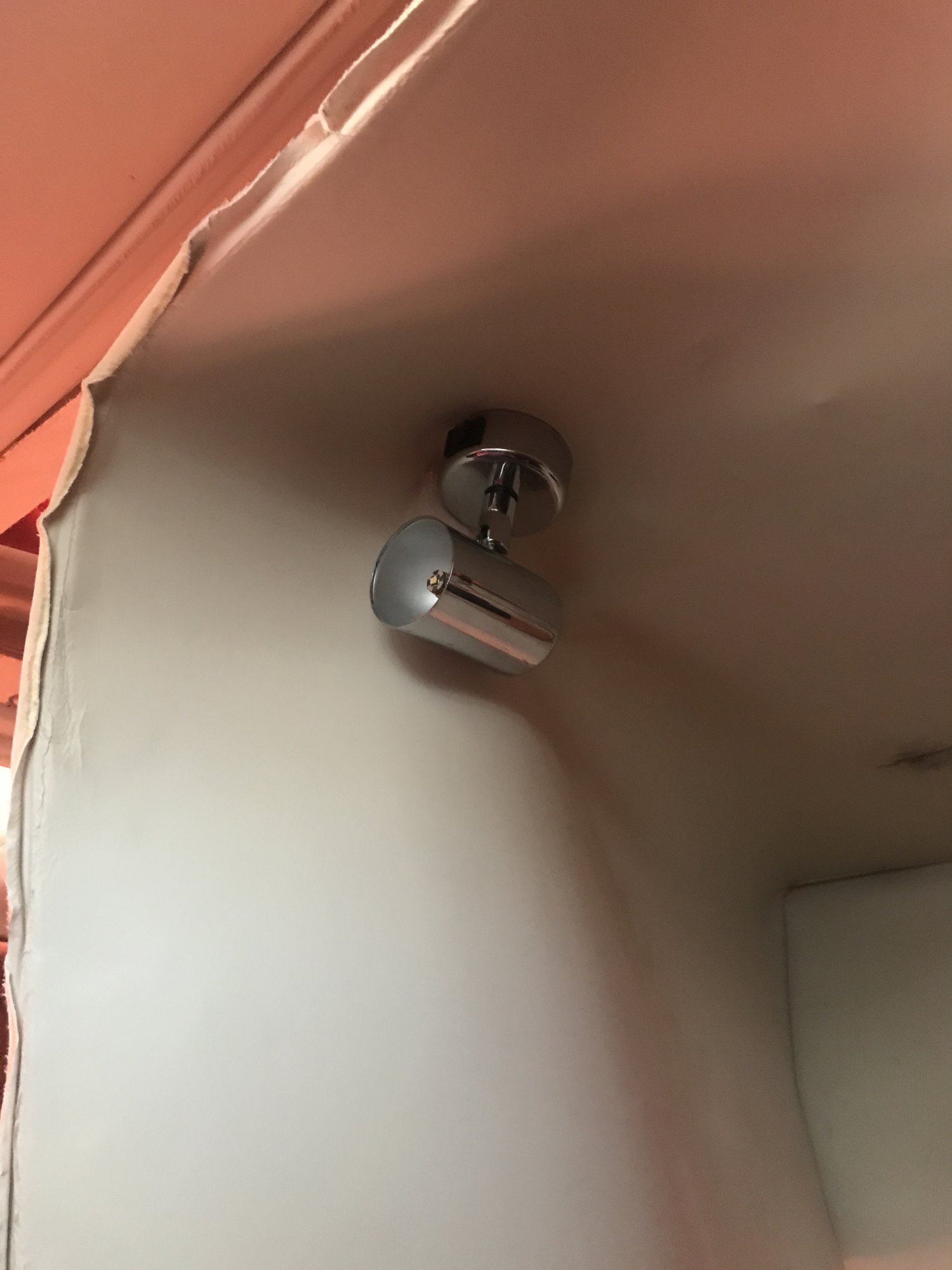

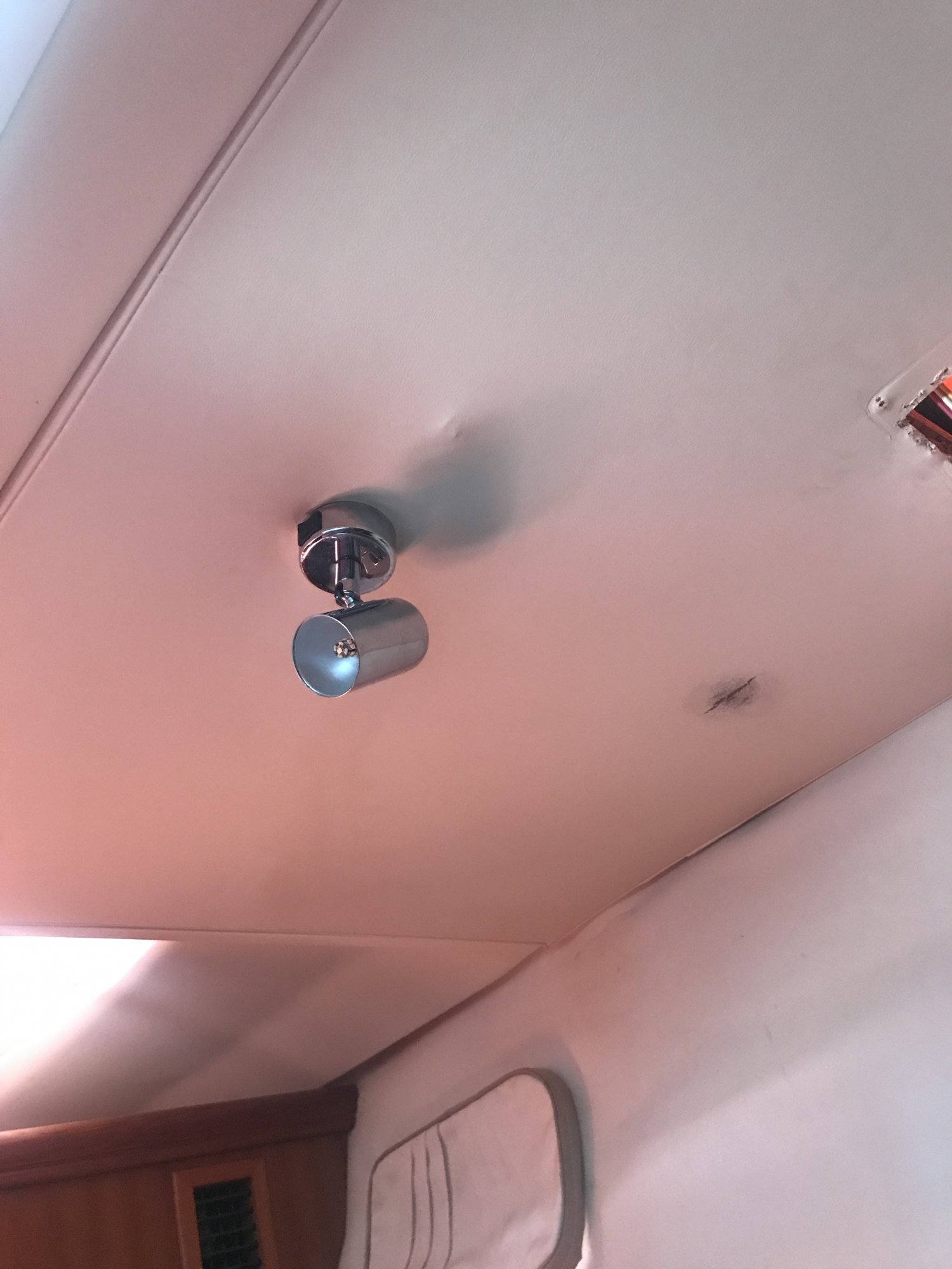

I'm working on the headliner in a 2006 Hunter 38. There are some reading light fixtures in the aft cabin and v-berth that I can't figure out how to take down to remove the headliner material. Anyone know how these are uninstalled? They are attached to a light piece of plywood behind the liner, but I can not feel fasteners or bolts on the back side of the plywood. No setscrews or other fasteners are visible on the exposed part of they fixture. I've tried twisting and pulling the light base off the mounting piece with no luck. I'm stumped.

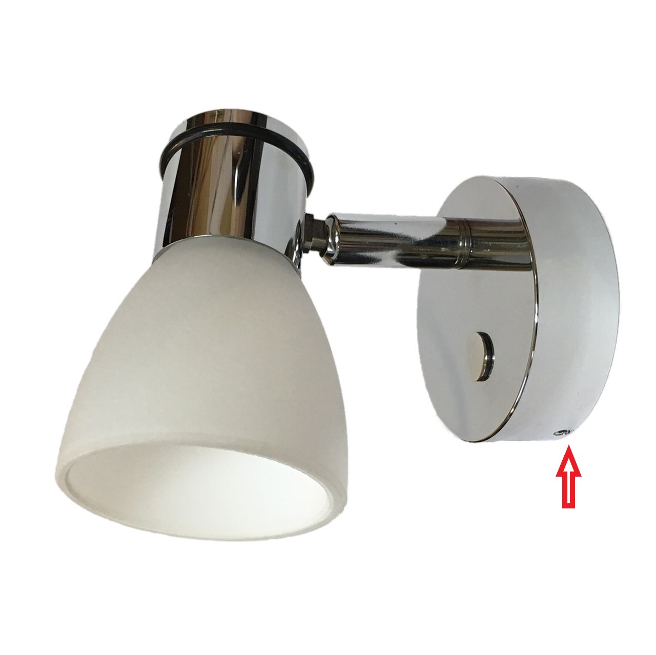

Check around the base for a possible screw to release the housing from the inner workings.
If no screw, then the base may be held in place by friction.

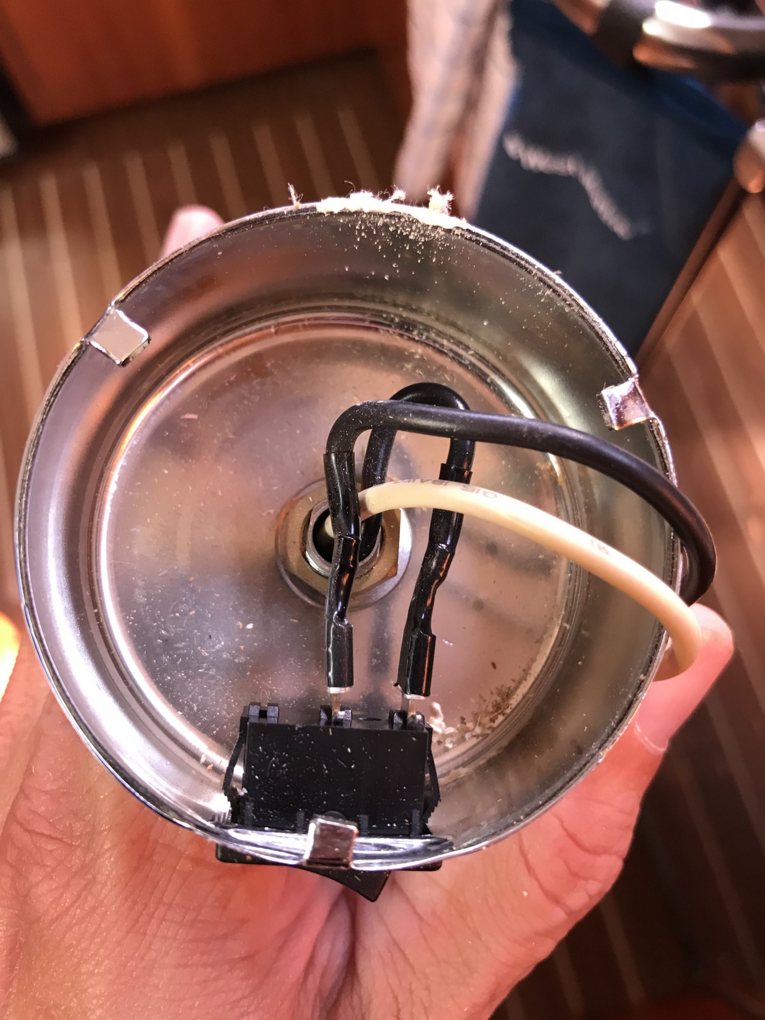

I ended up cutting the headliner material around the base of the reading light just to get the piece down and out of the way. Still don't see any screws either on the visible part or the hidden parts of the light. No screws protruding through the backside of the plywood. No bracket or threaded rod with a nut to route the wires like you would see on a lamp or hanging light in your house.

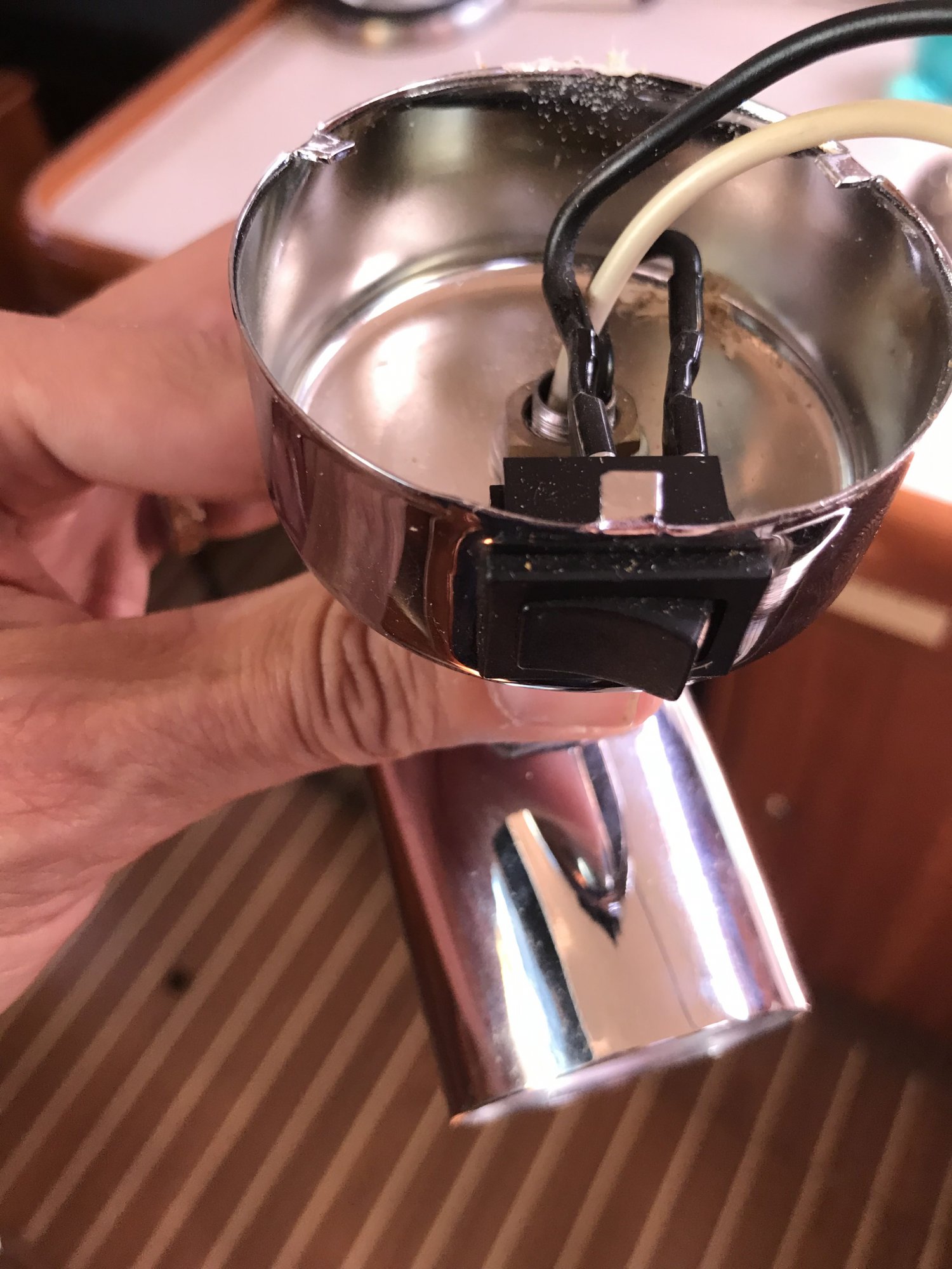

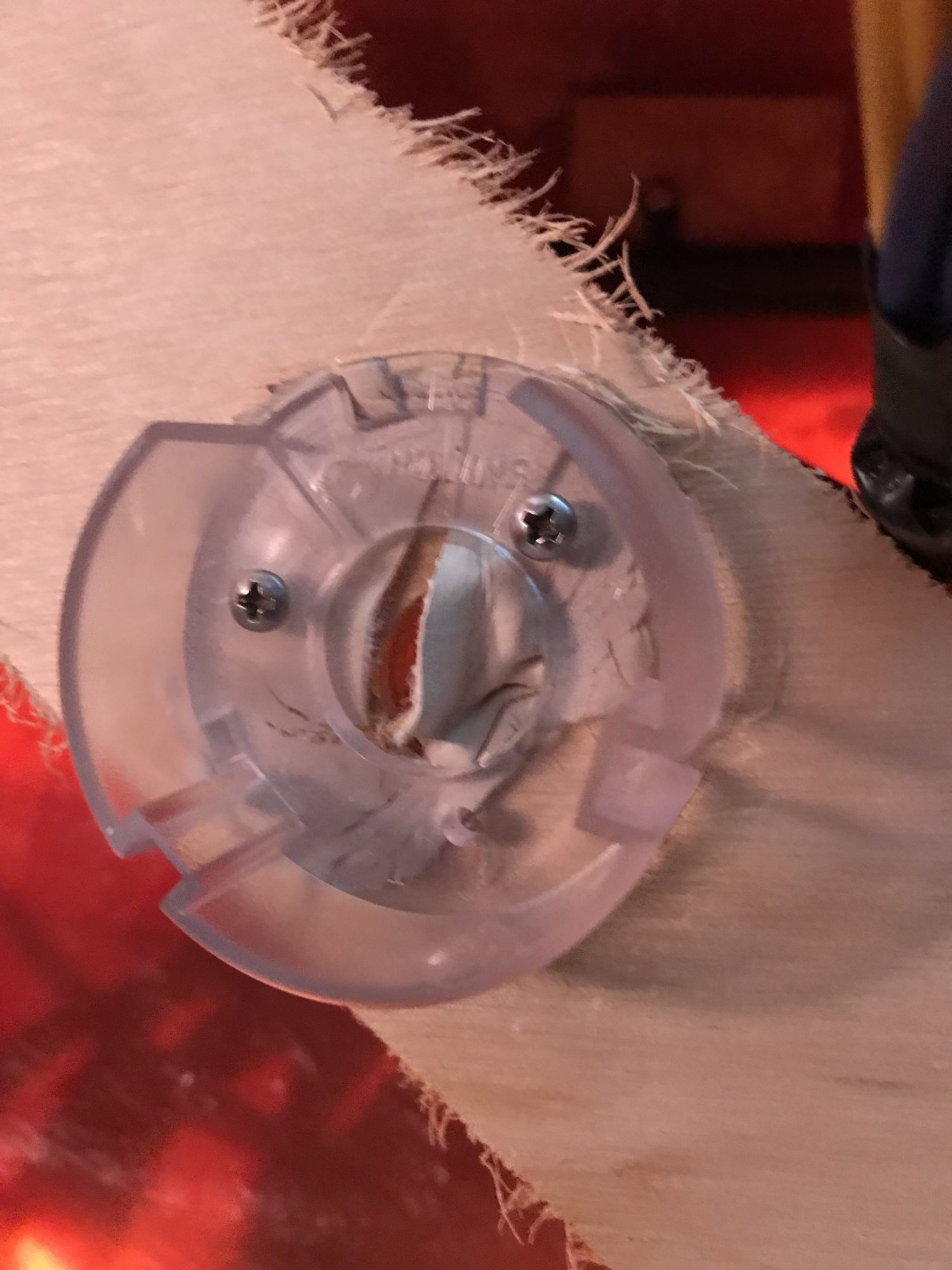

Some light prying with a plastic putty knife loosened the fixture enough to be removed. It is a twist-lock fit. A plastic base is screwed to the plywood backing over the headliner material. Three tabs on the reading light metal fixture follow a grove in the plastic base and twist-lock holding the fixture in place. Turn counter clockwise to remove. Clockwise to install. I guess time had made the fixture fast to the base. The light prying with a plastic putty knife freed it.

The plastic base is marked "SWITCH" to indicate which way to align the on/off switch when installing the light.
The base is marked "UP" on the opposite side. I guess it would matter if mounting on a vertical location.
