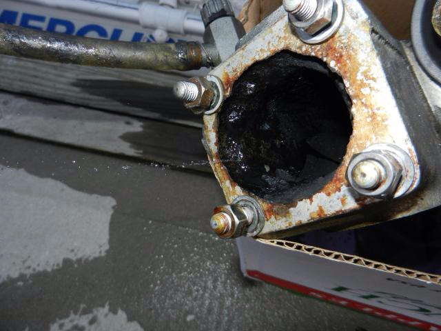

I had a similar issue on my '97 4JH-2E. The leak was happening in the exhaust manifold/heat exchanger. Yanmar designed the wall between the exhaust ports and fresh water side too thin. A pinhole had developed and the coolant was leaking into the exhaust port and going overboard with the raw water. The leak started very small and I nursed it for months until it became much larger and I had to tear the engine down to find the leak. When it started leaking badly you could smell the coolant in the exhaust. I had to replace the entire housing for about $1000. The new housing is about twice as thick in that area.
