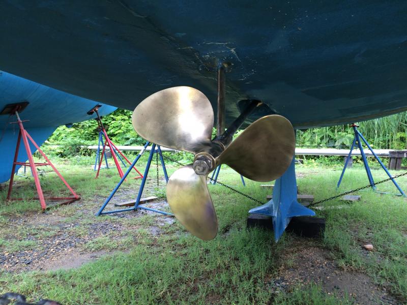

Used a grinder with a fine wire cup brush, then a fine scotch pad in my drill to polish it off.

The prop looks fantastic Jim !
