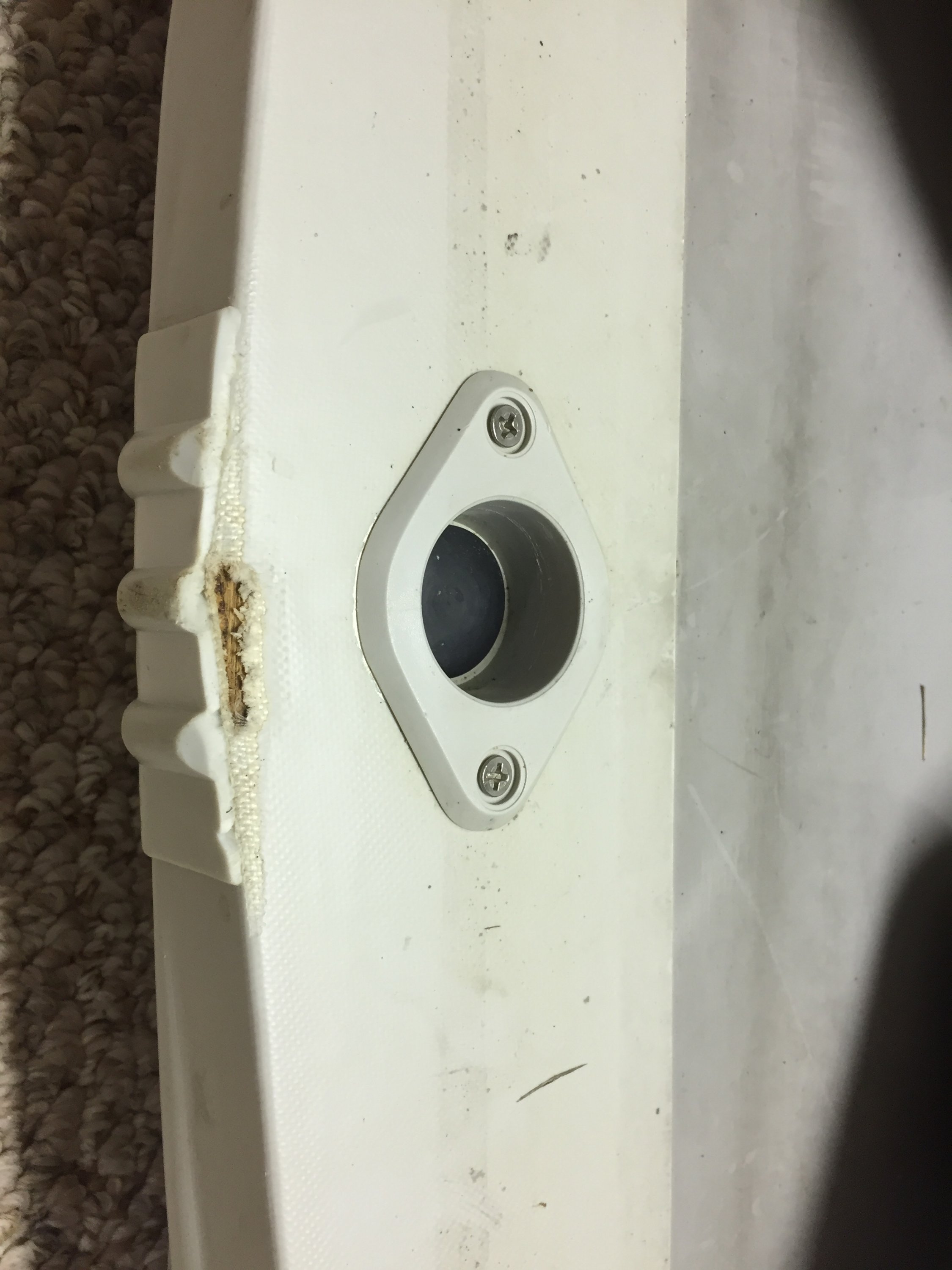

Perhaps I am being too fussy but I noticed some damage to the transom of my dinghy. The vinyl has worn off, possibly abraded due to pulling the dinghy off of the sandy beach. A) should I be concerned and B) what are recommendations for repair. It would likely be easiest to repair if I could paint some type of liquid vinyl on the affected area. Is there any such material out there?
24,519
I would be if water started pouring into the boat and I was farther off shore than I cared to swim.
Short of that. Patch it. Go forth and abraid no more.

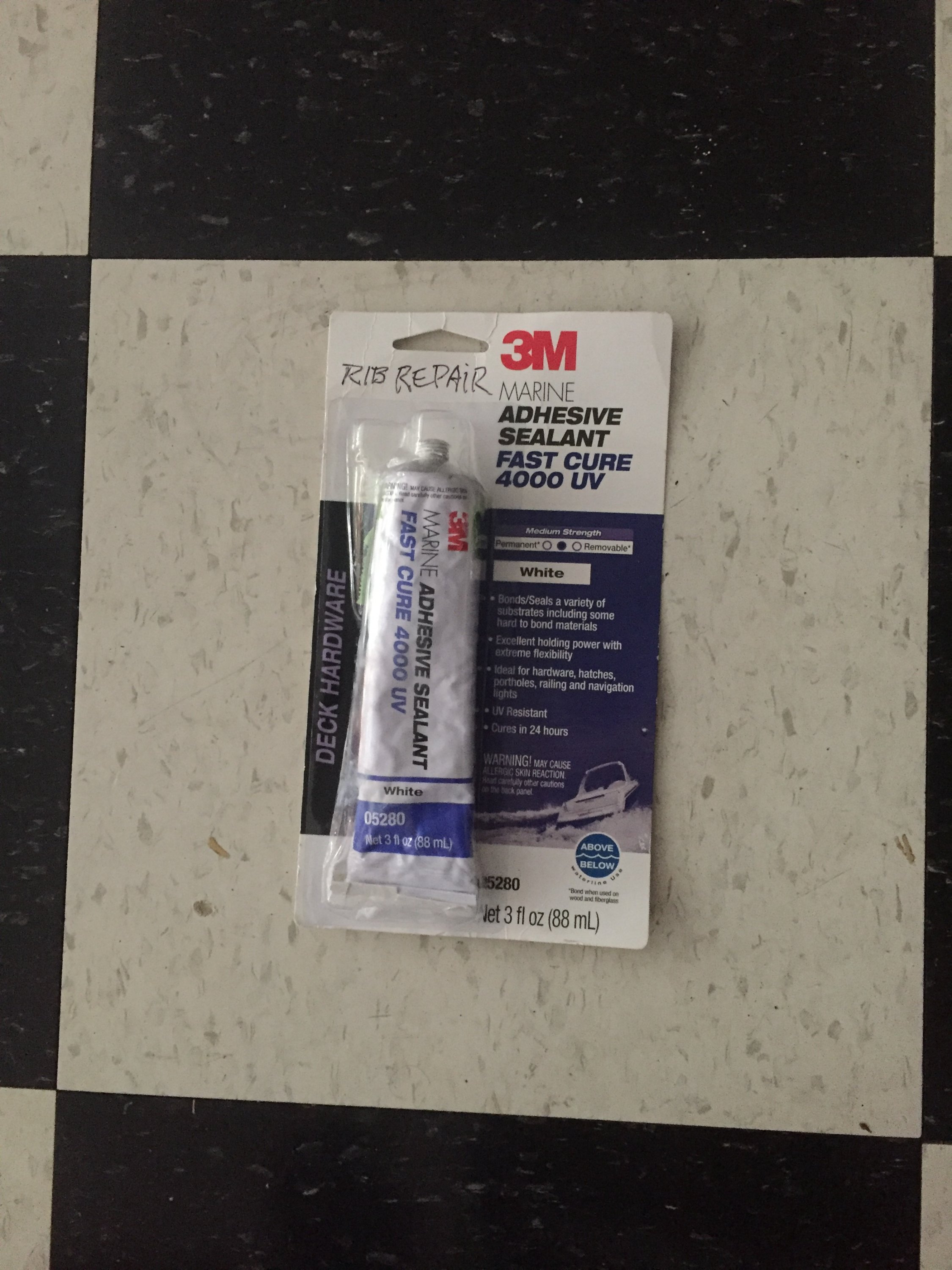

Gunni... that looks perfect. Do you know the significance of the number “4000”. I see others out there e.g. 4200, 5200, etc

5200 is permanent and will take up to 7 days to fully cure dependent on humidity and if it is in water. 4200 cures in 48hrs'ish.

4000 is a fast cure polyurethane that is very flexible and can handle being exposed to the sun. Paint it on with a small brush, a disposable flux brush works well.

I purchased and applied the 3M 4000. We’ll see how that works.

What I see is a bit of frayed cloth and some wood. Therefore, I would use a thin epoxy glue or resin to saturate the wood and keep water out. I doubt that the frayed cloth is structural and the epoxy will stop it fraying more and seal the area, leaving a hard surface that continued use won't harm.
Note; the area must be completely dry or nothing you do will work.
