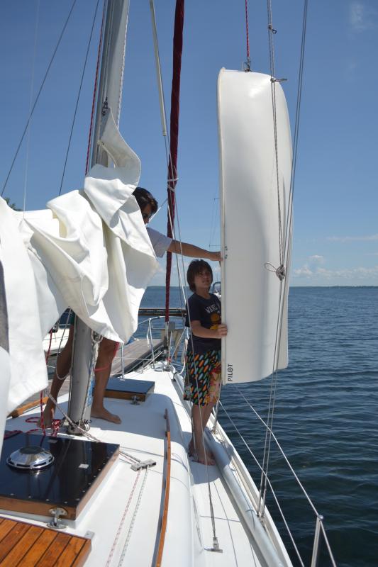

Hope it helps:
I drive a '76 Ericson '32 and use a 6' Pilot Dinghy that I mostly keep on the deck over the forward hatch, upside down, with four of those foam 'car top canoe pads' to protect the deck. I get the dinghy on and off with the Spinnaker Halyard and an extra hand to 'guide' the dinghy where I need to, place/remove the pads, and when we lower into the water we just use a small rope to momentarily hold the stern while I lower the halyard which is simply hooked to the tow hook on the bow...see a few pics.

Thanks. I realized my dinghy is actually 10ft which explains why it's so heavy. I'm doing essentially the same thing as you but using a block and tackle to deal witih the extra weight. Great idea to use the foam cushions!
