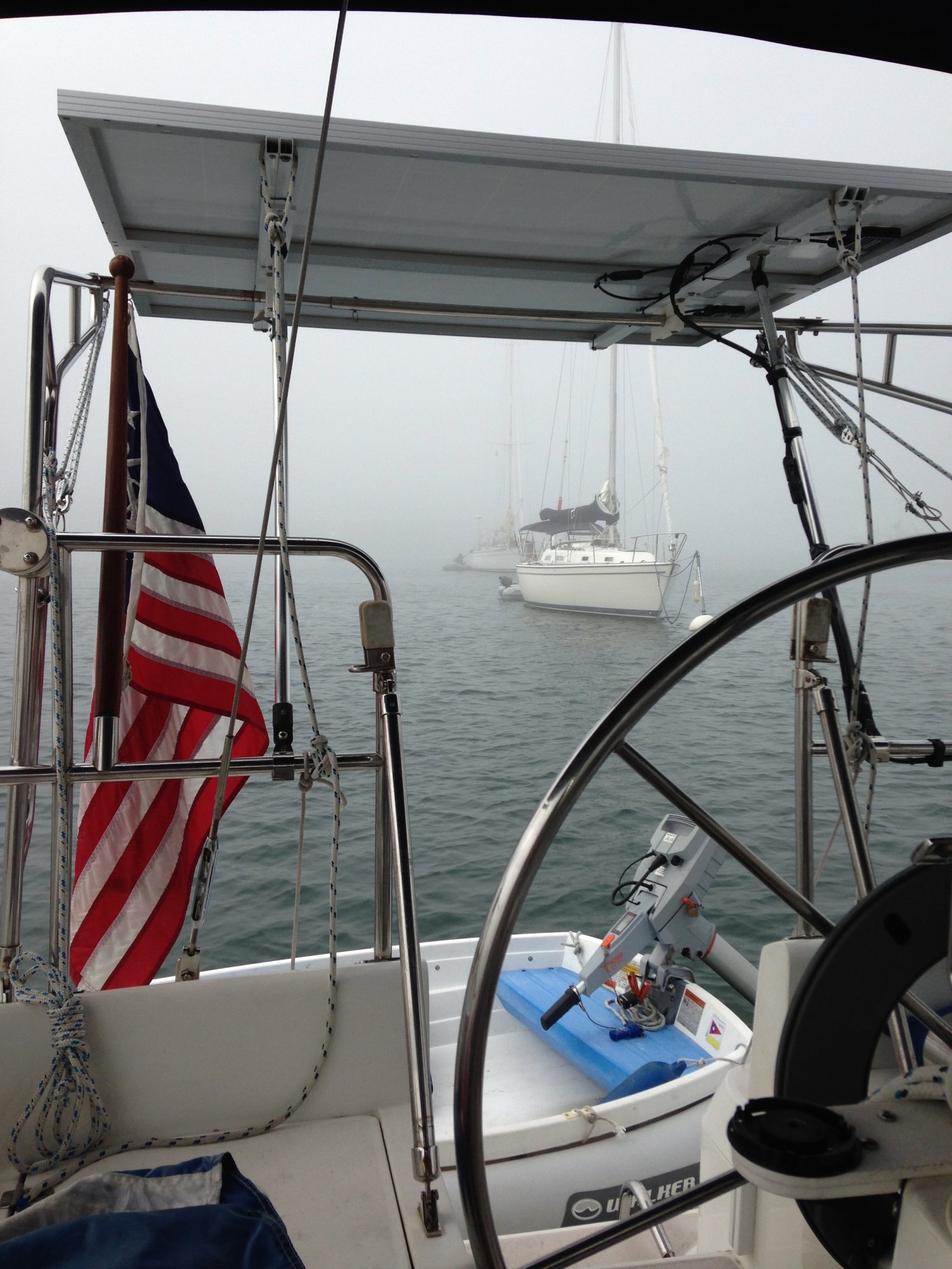

If you zoom in on the Torqeedo in this picture, you can see the small padlock on the retaining pin for the battery. I used a small, braided stainless wire and made a loop through a convenient hole on the leg and nicopressed the loop. I made another loop that would just reach the head of the retaining pin, and put a padlock through the pin and the loop. The pin can still be moved a bit, but not enough to pull it out. Of course, this will not deter someone with tools, but at least a passerby can't walk away with your battery.

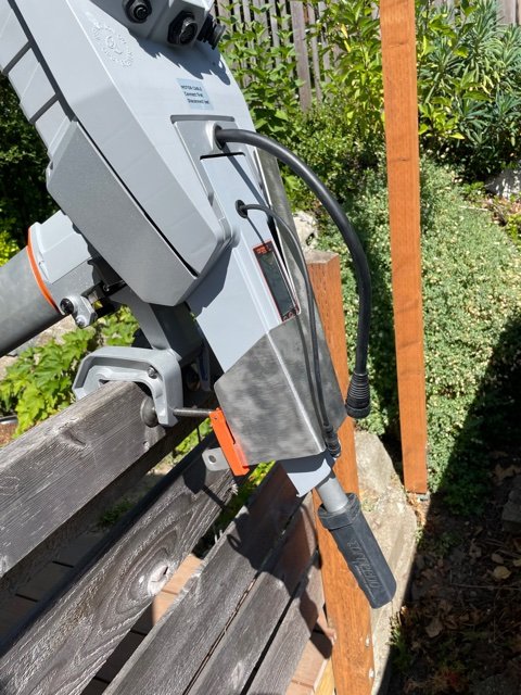

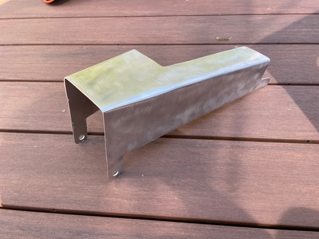

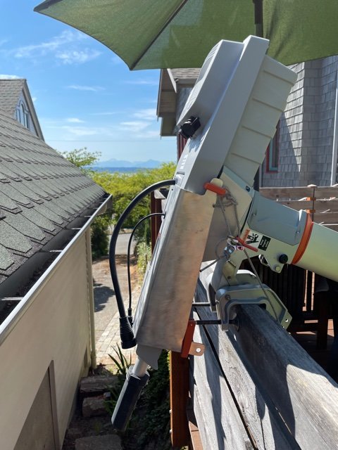

This thread is a bit old but I thought I would post my solution to securing a Torqeedo to the dinghy. I decided to make a metal shroud with tabs that insert into the battery lock and transom clamp arms. It may be perhaps a bit big and clunky but the battery, tiller and motor can all be secured with a shackle lock.
