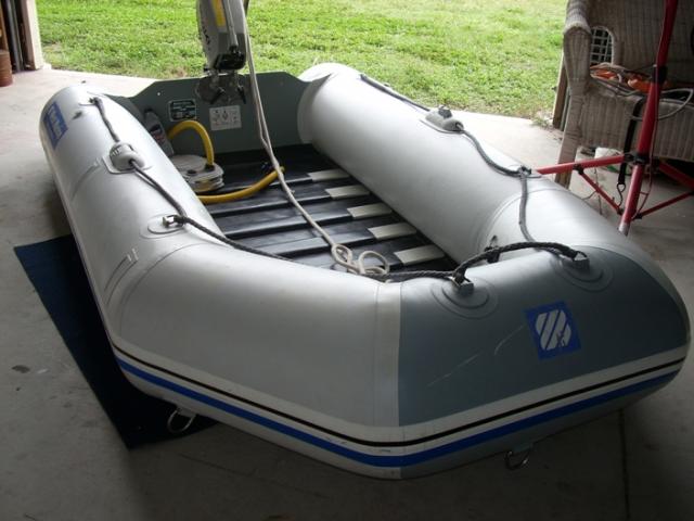

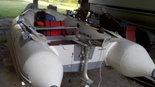

There really isn't a simple fix that will last and 2part glue is the only real fix. PVC dinghy cement on all the joints will typically begin to fail at about 5-7yrs. One repair will then lead to another and another until you've inevitably had the whole thing apart for repair, at which point you will be a joint repair pro(albeit a frustrated pro).
The project dink was an 8'-6" WM special that only needed a couple of spots re-glued(yeah right) including some 5200 joints that need serious attention...now I'm an expert after eventually tearing the whole boat apart to fix the endless problems of aging glue:). live and learn.
Like others here, I found an A/Cd room(NOT IN YOUR HOME), prepped extensively(the true secret), 2part glued, rolled, cured 48-72hrs and at the end of a long smelly brain cell destroying road all was perfect but my confidence in the boat was shot.
Great repair procedure link: http://www.shipstore.com/SS/HTML/INFO/INFOglue.html
Most professional life raft shops won't touch older PVC dinghy joint repairs because they become endless repair headaches. Our shop in Tampa advised me that if I can grab a joint and pull it apart that you should keep pulling until the joint will nearly destroy the tube. In other words it shouldn't come apart by hand without wrecking the dink.
Great professional shop: http://www.solutiononemaritime.com/
I eventually sold my rebuilt WM pvc dink for a nice used Achilles Hypalon version with an easy(now) to fix hole in the floor and life is now predictable. Pic below of old vs new ride. Good luck in your experience, Mike
