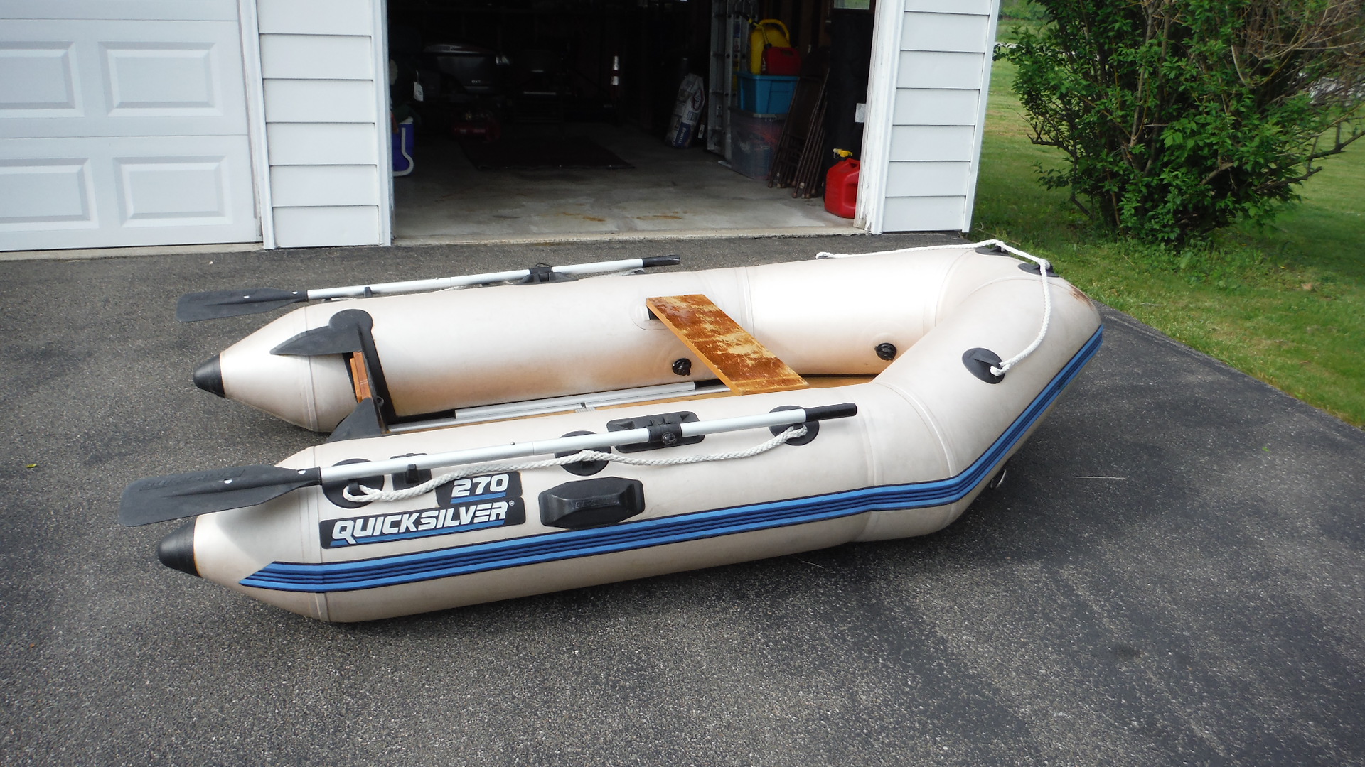

We recently found and purchased a used, well maintained, Quicksilver 270 Dinghy, 900 lb. capacity, with a rigid floor insert and inflation supported v-hull. The admiral made me buy it cause she was troubled getting into our inflatable kayak for shore visits, especially when guests are attending. I am seriously considering acquiring a Lehr propane fueled out board to power. Can anyone tell me if the 2.5 or 5.0 HP model would be sufficient to get the dinghy on plane?
So far the Admiral and Skipper (dog) approve of the acquisition.

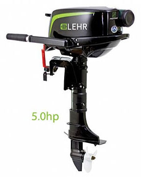

Hey Justin, yep they need only a single Coleman style propane tank which screws into the head of the motor. You can also install a larger cylinder and hose adapter. We already stow multiple canisters on the H30 for the Magma grill. Apparently one canister will propel the boat for 1/2 to 2 hours dependent on throttle. We only make short trips from anchorage to winery and restaurant docks up here. But I do want the dinghy to plane. So pretty much WOT for me. Check out the propane tank in the image below. ECO friendly and four stroke clean. Just need to tote along a few extra canisters each trip.

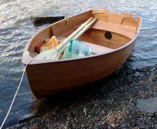

if you want to be eco friendly then get a rowing dinghy and be done with it
'Tis a rowing dinghy, complete with oars and locks? I guess I'm not that Eco-friendly since shoulder surgery...besides the Admiral might whine if I made her rowing dingy captain. Zoom, Zoom!

It may have oars, but I doubt anyone would call it a "rowing dinghy." Those are more specialized usually made of wood or fiberglass, can be more expensive than an inflatable w/ less capacity. Of course, you can get larger ones.
Nov 30, 2015
1,343
Awesome!!! But well beyond my pay grade and stow ability.
