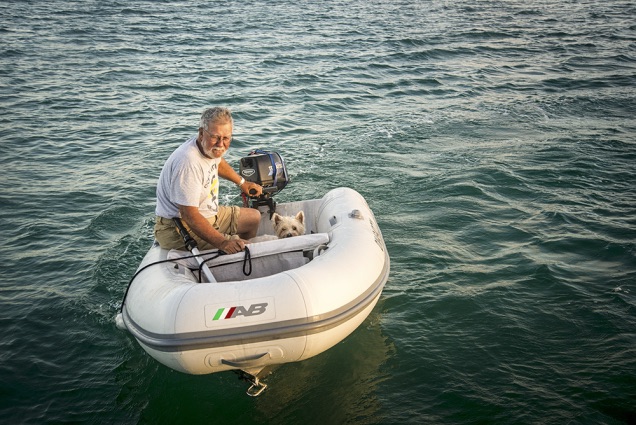

I have the same 6 hp Tohasu engine on a 9' AB RIB with an aluminum bottom. Weighs about 70 lbs. it will not plane. I had the prop "adjusted" from an 8" pitch to a 6" pitch. Lots more pull, gets up on plane if the dinghy is empty and I crawl up to the front. If I add just the 22 lb dog it won't plane.
A few people have complained this motor is over rated on the power, it puts out more like 4 hp instead of 6. Before I had the prop adjusted it did not rev up completely, now I think it hits 5K. In the end I think I'll replace it with a 9.9.
