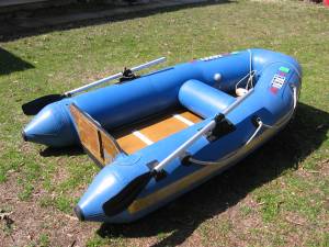

Hi Marc, definitely Hypalon (circa 1987-ish). Great boat.
Any chance this old Achillies dinghy is Hypalon? I'm trying to get a hold of the owner.
Appears to be an '87-ish Achilles LS-4 or LS4GX.
1987 Achilles catalog link [see pages 22 & 23: http://www.achillesinflatables.com/pdf/files/1987achilles_catalog.pdf
There were a few years when Achilles dabbled in Urethane coatd fabric, but only under the Conquest name brand. If a boat says "Achilles" on it, it is Hypalon (or now CSM - Chlorosulfonated Material [which is generic Hypalon]).
Enjoy your boat and your season.
Stephan
