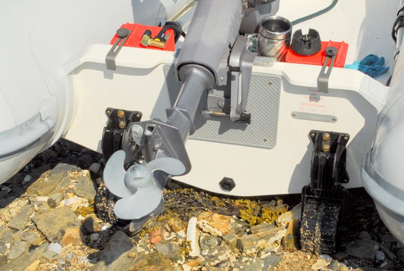

Most of the time unless it is the fast growing short steep stuff... You need a long painter and I also drop my Davis Pellican Wheels to prevent surfing...;) Works like a charm.. They create enough drag so the dink behaves quite well with no surging, snapping or tugging. When going down wind the added drag of the wheels can be useful..

Where are your d rings on the side tubes? top? sides? bottoms?
Ron if the question was to me they are low on the front. You can see them in the picture above. I wouldn't mind towing from the transom, but I'm concerned how to get the lines from back at the transom up to the D rings without exerting a lot of chafing and pressure on the tubes.
I'm thinking I could use a bridle like I have now off of the D rings that comes up to 3 links of chain with a carabiner hooked to the middle link. Then bring the back bridle off the transom forward to that carabiner and hook on there with the tow line. That way the rear lines wouldn't have to go down over the sides to the D rings. The tow bridles working together would I think keep the bow down when the outboard is attached or even when it isn't. The front bridle would center the back one, so that it wouldn't pull the dingy around sideways. The tow line would be hooked mainly to the back line and the front bridle would be there to keep it centered. Sounds like a lot of lines, but once they were setup and using snap hooks they would snap on and off very quickly.
I'm open to suggestions still, but think this will work. Only problem is I won't be able to try it until May or so when we go back out.

I don't think that if you run a line from the transom, through the D rings, it will tow any different than it does now. Mine seems to tow the same either way. But as I stated, I never tow mine with the engine mounted. Put the eyes as far outboard as possible, with some big fender washers for backup. I run the bridle through wrapped around the lifting lines on either side, then through the D rings. Also, my dink has the drain plug above the water line when empty or when towing, and I leave the plug out, except when I forget. This keeps any spray from accumulating in the aft end of the dink. I am not anywhere near the boat now, or would get some pics.

Now that I can figure out which responses are going to any of the multiple questions on this thread... Your d locations are not favorable to the idea to use them as fairleads. On your boat there would be a sideways strain on the d's, which is what you are trying to avoid in the first place. It would help, though and certainly better than just tying to the low d's. Your other, recent, idea sounds good, though.
