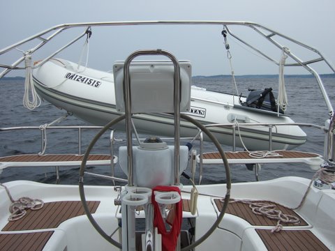

Like Steve we put the Hunter Marine on our 2005 Hunter 38 and have been very pleased with them. They clamp directly onto the arch so there are no issues with having to drill holes in your boat and access to the stern lockers is not restricted. I contacted Hunter directly (customerservice@huntermarine.com) on files by email before I purchased. Bought from out local Hunter dealer and I was able to haggle a bit price. Installed in about an hour with the help of my wife and 2 teenagers.

I like the part about no drilling and a no brainer installing them and look very nice with plenty room it looks like in photo.
I would love it if they fit on my 36,they were pricey if I remember maybe like $2000 yes or no.

Steve and Gordon: You guys help me out here before I make a big Mistake. I THINK you have describe a inflatable dinghy davit system that are hoist attached to the arch so that the dinghy is carried slung and riding securley beneath the arch. If so, in my boat that would be about where my face would be if I were standing at the helm, hands on the wheel. So, either you guys have center-cockpit rigs, or I am missing the big picture in here somewhere. ( and, believe me, I miss that and many other things often). Please clarify. signed, blind eye.

The Hunter series 40 Davit is a system of welded stainless tubing which clamps onto the existing stainless arch and extends aft over the swim platform. Capacity is 250 lbs., sufficient for a 10 ft rib and OB in the under 6 hp range. I hang a Walker Bay 10 from mine and row it everywhere. It incorporates two spreader bars and two blocks for lifting/lowering, raises the Walker Bay enough to access the swim platform for boarding from dockside stern to, and can be secured laterally and fore/aft with lines sufficient to make the Gulfstream crossing. We sat through TS Noel (October/November 2007)with the dink up while riding at anchor in Taylor Creek, Beaufort NC. The only loss was my hat.

Thanks Steve, I've been chasing down a custom design davit system, because I could not figure out how this Hunter 40 system fit the rig. You have convinced my to get more from Hunter on this H 40 davit. If it works out I'll buy you a new hat.
