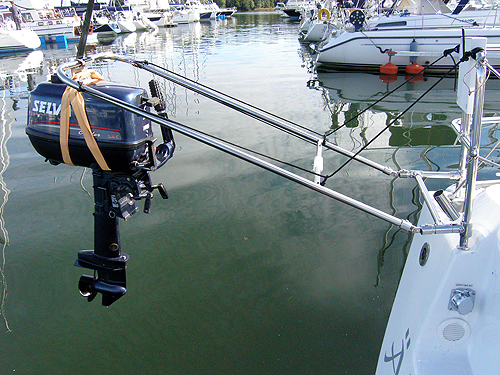

There are hoists for engines that mount to the transom that use a block and tackle to lift the engine.

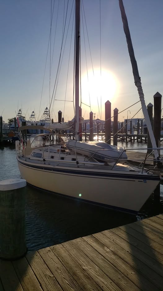

  • Currently I have a Tohatsu 5HP 2-stroke. It weighs ~45lbs with a full tank of gas. and will quickly get my current dinghy up on plane when I am alone.
  • Prior to the 5 horse, I had (and still keep) a Mercury 3.3. It weighs ~30lbs with a full tank of gas. It would also get up on plane, but it took about 30 seconds to do so.
* - Rigid Inflatable Boat - these have either PVC or Hypalon (aka Orca) hulls and tubes. Some have inflatable floors, some have slats, which allow them to roll-up, and some have solid panel floors made of either aluminum, marine plywood, or a combination of the two.
** - Rigid Hull Inflatable Boat - these have either an aluminum or fiberglass hull with inflatable tubes to provide buoyancy and cushioning.
Likes: Timm R Oday25
Aug 19, 2024
9
Hunter 34 Deale
eherlihy thanks for this! From the picture it almost looks like yours is a RHIB? How does it do with a 5 horse when the dinghy is full?

There is a Canadian motor lift that can be attached to the stern of your boat. It is effective at lifting your motor up to a storage point on your stern pulpit.
The sling is like the one in the image below. The motor is not lost to the deep blue.
products
I do not know if this product is still being sold. It is not a complex design. I believe a DIY'er could make their own if not available for purchase.. I have used one and it functions very simply. I use the main halyard, and it easily pulls a motor off the back of a dinghy in the water. The YouTube video shows the process.
products
If you have a gasoline outboard with a transmission (i.e. any motor over 3hp), and use a lifting harness on it, be VERY careful that the harness does not interfere or even touch the shifter linkage. I have a friend that uses a sling to lift his outboard, and I have had to fix it - twice, because using the harness bends his linkage when he lifts the motor.:rolleyes:
I simply grab my outboard by the lifting handle, and step onto the swim platform of my 35. I then lift and place it on the motor mount that I have on the pushpit.
