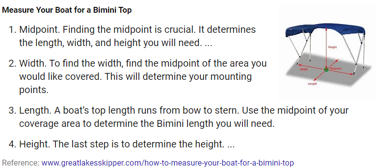

Biminis are not only boat specific but depends on your preference regarding coverage. Below is how you measure for one. Be sure the height does not interfer with the boom. You can also contact on-line bimini manufactures and they will request specific dimensions for coverage. Good luck and let s know how it turned out with pictures!!

Not to mention keeping the bows away from the swing room for the winches, keeping the traveler and mainsheet clear, placing a window so you can see the mainsail and other details.
