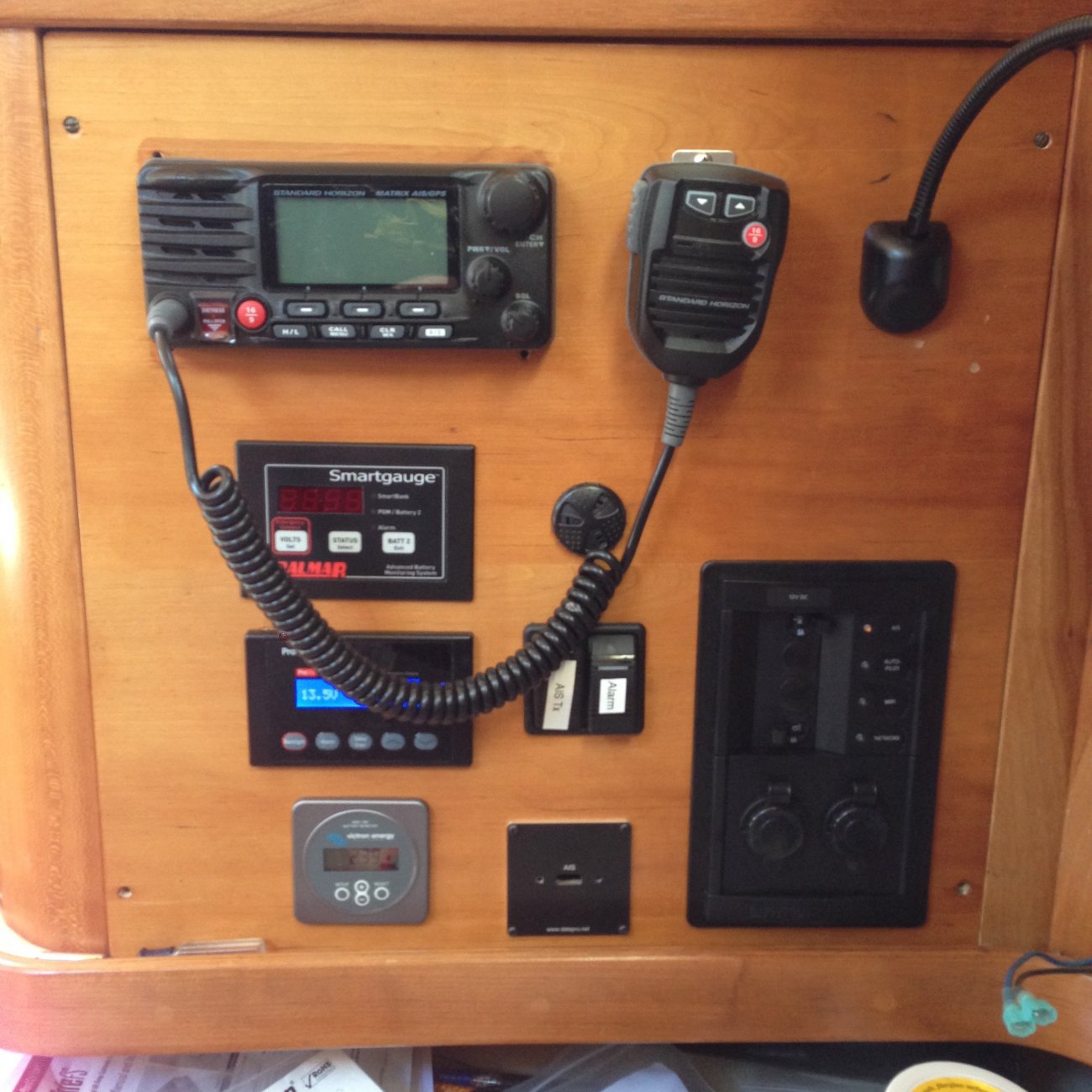

Nah, I went with the SG200 it has prettier lights on it...... but there is an idea I could add the Victron next to it :rolleyes:
