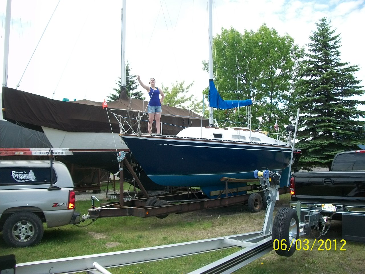

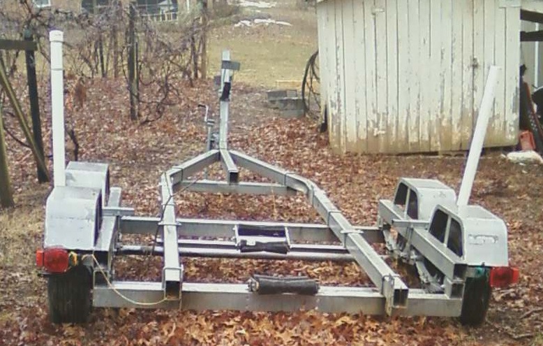

As Squidd suggested, goal posts are a good thing to add, I have them on my H26 trailer... unfortunately, I don't have pics of mh H26 on a trailer but here is a pic of my previous boat and it also had "goal posts". If you get goal posts, make them a lot longer than you think you will need. These here in the pic are too short and were often submerged when I needed them most. Regarding rollers, the trailer pic (second pic below) is for a swing keel boat. I rest the keel on the rollers instead of on a board. You might consider getting something like that instead of the boards..... but I'd only make that mod. if a deeper submersion fails to fix your problem.
Dave says my goal posts are too long. Maybe so but I never lose sight of them.

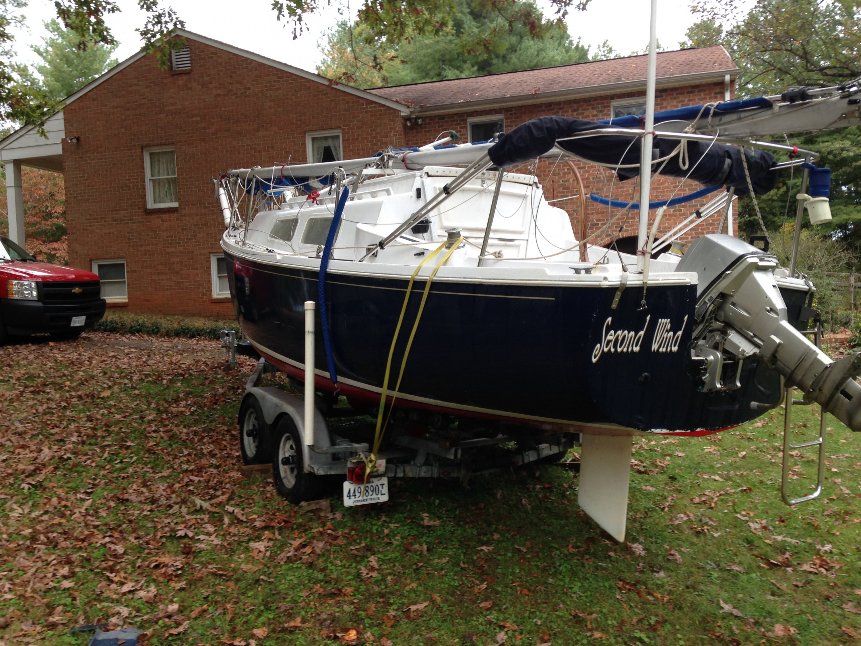

Mine are 10' long...when the back of my 27" trailer is in 6'-7' of water I still have 4'-5' sticking out... Which is just a bit above my freeboard...
They are also angled forward slightly so when the trailer is tilted down the slope of the ramp...they stick straight up.
They are also removable for transport down the road, being stored with the ladder alongside the keel...
They are flexible at that length and will not damage or "force" the boat in place, but by lining up between them, and the winch as a target, I can drive my boat onto the trailer...the keel guides grab and do the final lineup about 6' out and the boat settles "into" the sloped curved bunks...stopping about 18" from the winch...
I hop out of the boat...attach the winch strap and crank in the final 6" till the boat is locked in position...
Then I drive out...the whole thing is done single handedly and only takes minutes... I launch and land my 27', 7000# sailboat in less time then most guys can their 18'-20' fishing boats...

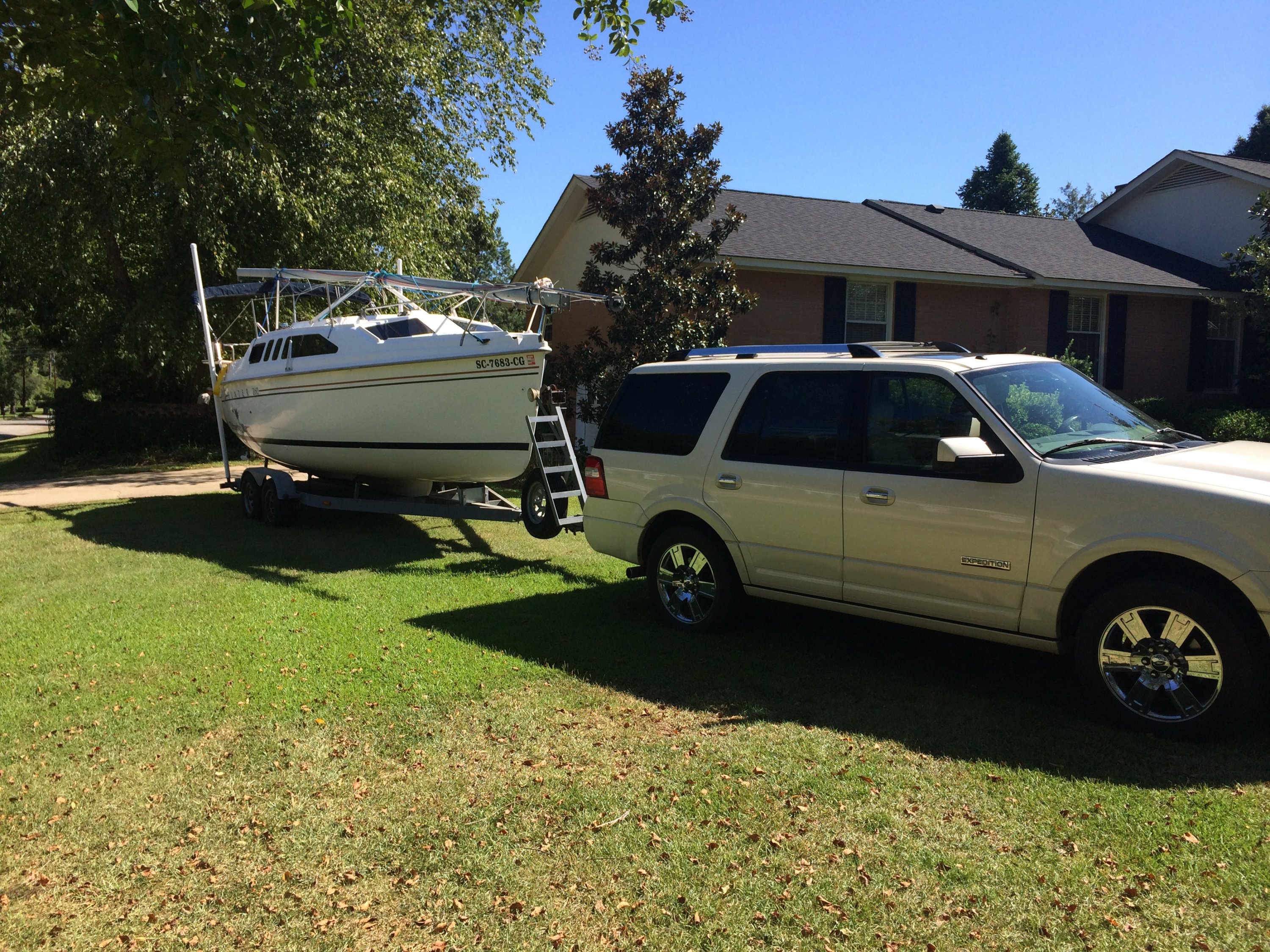

And I'm doing this with a lot bigger
boat than what most of you guys are talking about..
That is strange.... Dave told me I needed longer ones on mine... :wink:
But seriously, I have an issue with the top of my goal posts catching under the gunwale as I start up the ramp. So I think mine need to be about 6" longer.
