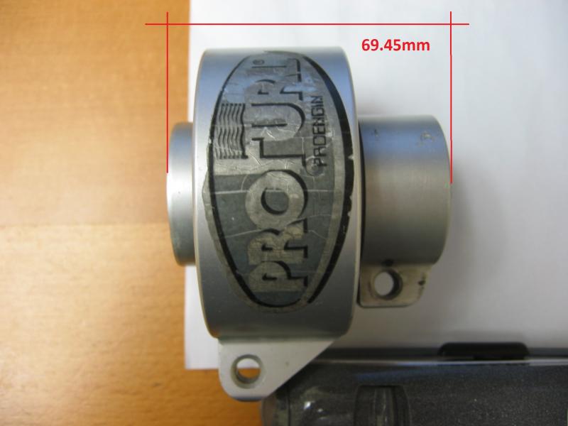

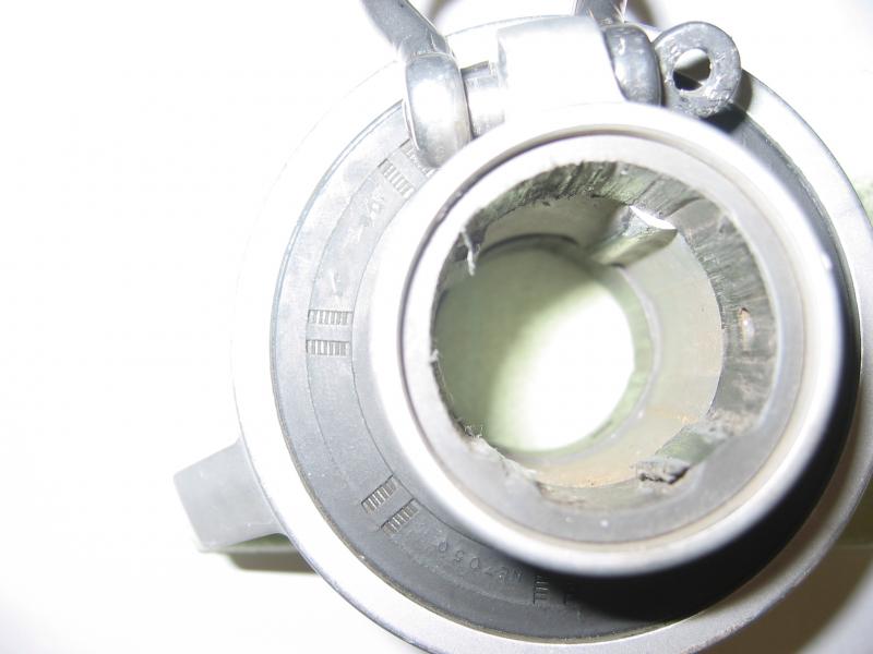

@knot smart
There are 2 bushings in the profurl swivel. These bushings wear. They can be easily replaced. Call Profurl and they can give you the part number. They don't sell direct but they will let you you know of a local distributor from which you can order.
I replaced mine back in 2010 and only cost $10 for a set.

@knot smart
Thanks joker.. I saved that pic .. I really appreciate the info.. god I love this forum!
