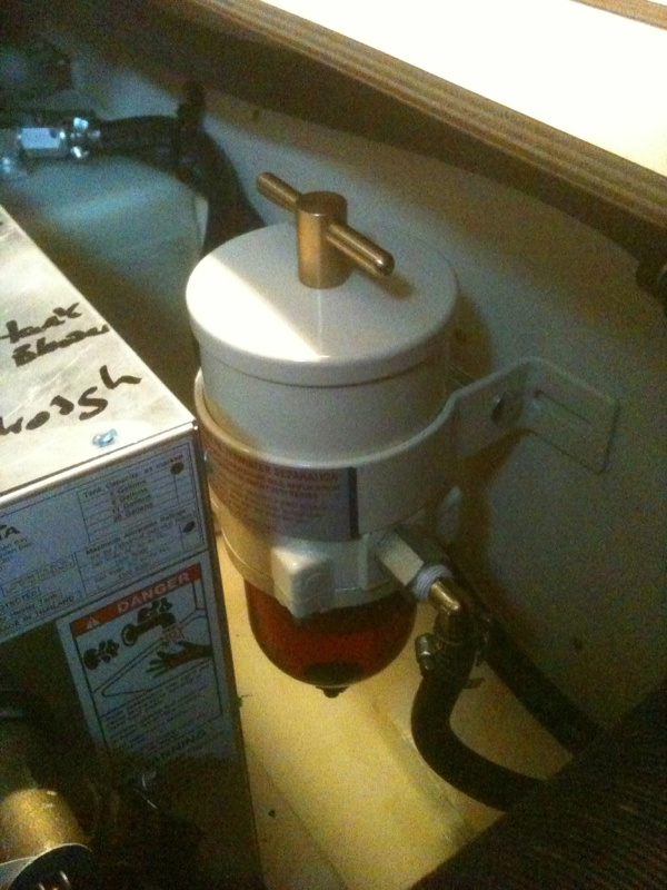

I have a Hunter 376 with a Yanmar3JH2E diesel engine. It came with an enclosed Racor filter unit and I was thinking of replacing it with a clear lower bowl to detect water in the fuel.
Any recommendations?
Not sure if this is relevant to the discussion or not:
http://www.westmarine.com/webapp/wc...d=10001&page=Diesel-Filters-ABYC-Requirements
For Canadian sailors I don't believe Transport Canada requires a metal bowl for diesel engines whether it is located in the engine room or not. At least that's how I read:
http://www.tc.gc.ca/eng/marinesafety/tp-tp1332-section7-2172.htm
In addition, my Yanmar 3YM30 has a plastic container and retaining ring that houses the primary Yanmar fuel filter. This is a standard filter is fitted right on the engine from the manufacturer.
