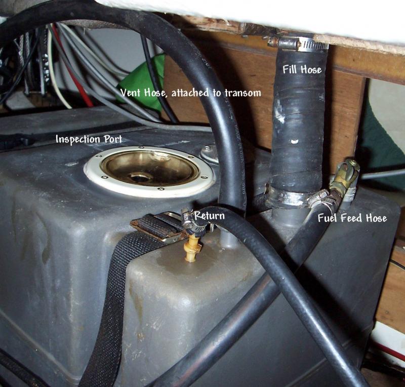

Attached picture of fwd end of our Tempo 11.5 gal diesel tank, installed by Prev/Owner. Apparently he merely punched a hole for the "return" hose, since the other 3 connections were used up. The folks installing my new throttle cable, thought they could pull out the return hose and reconnect it, but in doing so succeeded in making the hole in the tank where it goes in, much bigger, now the source of a chronic leak, as the stain indicates.
My question is whether anyone has any experience, advice, etc. regarding joining this return hose to a T-connector on the Vent hose, just above where it connects to the tank? In that way, I could seal the hole that was punched into the tank, eliminating this leak source.

The fuel return should ideally be extended down into the tank so that it is submerged in the fuel. You have a clean out in the top of the tank. You could drill a bigger hole and install a brass bulk head fitting which would allow you to screw on a fitting to the bulkhead. The tank side of the fitting could have a hose pipe that extends into the tank.

Otherwise, I agree with Jake and you should install a new fitting from the inside.

The only advantage of the return being tubed to the bottom of the tank would be to cut down on foaming, which diesel fuel can do. I don't think your system returns that much flow so I wouldn't be concerned there. Like another member stated, use your clean-out opening and install a bulkhead fitting that will give you a standard thread internally. Easy Peasy Repair!

Your picture shows the vent hose coming off the tank and making almost a 180 degree turn as it heads back to your transome. At that point it would need to rise above the transome vent fitting before connecting to the thru hull vent thereby creating a fuel trap in the middle of the vent line. The vent line needs to be re-run to prevent any traps for fuel to remain in the line. Also, the return line appears to cracked and may need to be replaced.

Yes that vent will be a burper... Also keep in mind that all fuel fittings should be double clamped..

Yes, I was aware of the vent line needing to be better positioned, and the cracked return line. Found a Moeller tank, identical to this one, 12 gal, with a metal return barbed connection added to the sending unit. Have ordered it and will have it installed with new vent line layout. Inspection port also found to be leaking at the thread. Tried new o-ring with silicon grease -- ok as a temp fix, but felt better in replacing tank.
