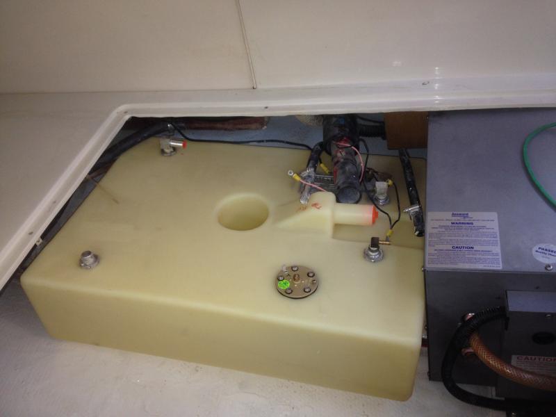

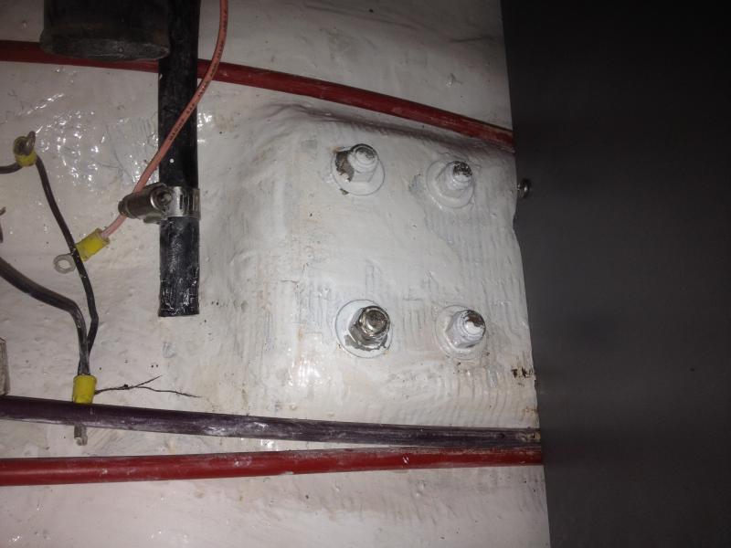

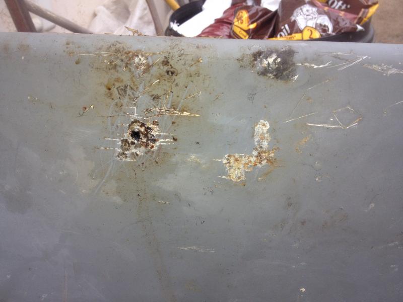

I just replaced my leaking fuel tank of about the same age. Catalina Yachts has exact replacements. Catalina Direct also has aluminum replacements but when I pulled my tank I found that the end nearest the water heater was resting on 4 stainless bolts and electrolysis caused the leak. Still waiting to hear back from Catalina Yachts about this questionable factory install. I found a XLPE (plastic) tank that is 16 gals and fits reasonably well. Let me know if you find the same problem I did.

I had a leak bottom center in my aluminum tank several years ago. I made a 6" x 6" access plate & took the tank to be repaired. But now, I can quickly inspect & easily clean my tank.
However, this brings up another point, mainly what caused the leak. There was a bonding wire attached to a tang on my tank top. Here we go, stray current & aluminum don't mix. The bonding wire is used to dissipate any static charge when filling the tank. On the downside, all your bonding/grounding probably passes thru your engine ground, then along the shaft & into the water. If nearby boats are running electrical systems, this can cause this stray current to enter your system and affect noble materials such as aluminum. This is called Electrolytic Corrosion.
see http://www.ask.com/question/what-is-electrolytic-corrosion.
I removed the bonding wire from my tank tang & added an alligator clip. When fueling, I attach this clip, otherwise no connection to my tank. Let me know if a bonding wire is attached & the hole/s are located center bottom of your tank.
