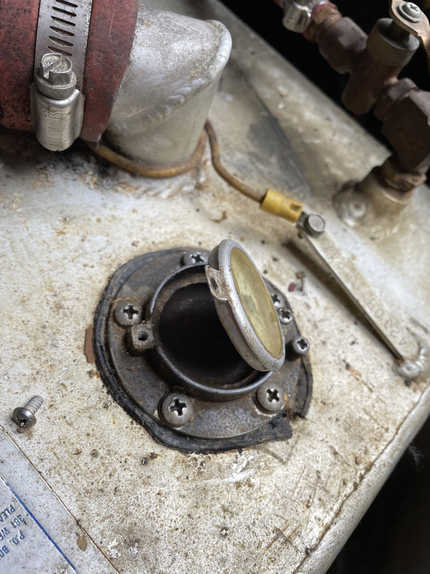

I did my due diligence and search but no luck.
1) the gauge isn’t working. But I don’t see the two wires black and pink that are supposed to be there based on my research
2) how do I check the gas level w/o a functioning gauge
Thx all
xavpil
Sep 6, 2022
376
Jeanneau Sun Odyssey 419 Milwaukee
We’ll I went ahead and unscrewed the whole thing. And the tank is full. And the gauge is mechanical indeed!!!
Thx!
