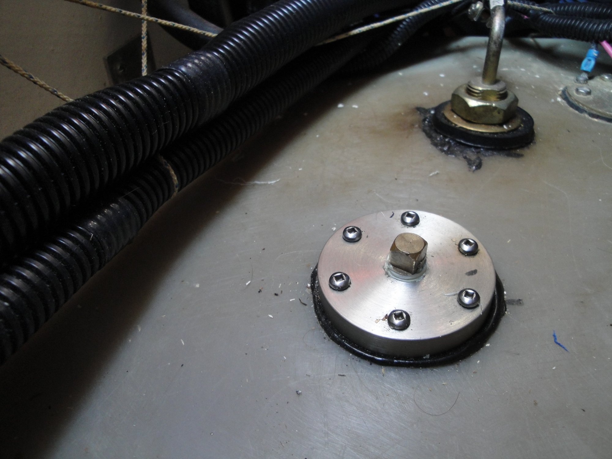

Feeling smug that we've got this solved, (there was zero diesel smell, mind you the tank was down 50 litres from full), we decided to fill up the tank. As soon as we're done re-fueling I check the top of the tank. DAMN IT. There is a trace amount of fuel on top of the tank. ( 1-2 teaspoons max), However at last we find the source..... The fuel sender.
Our boat was fitted with a Wema Fuel Sender from I'm guessing the either the Hunter factory or the tank fabricator. I find the appropriate cork gasket for the sender on amazon for under 10 bucks and order it. A week later it shows up and its time to get back to work. I watched this YouTube Instructional Video for installing Wema Sender, then went to the boat.
3) Fuel Sender Surprises....
There is not enough spare cable to pull the old sender metal arm completely out of the tank and rest it on top of the tank. This sucks as I can not mask the hole shut while cleaning off the old sealant. Either I would need to cut the cable and rewire it later or, be very careful and have my wife hold the sender up as far as the slack allows and clean the area. We chose the latter as it was less work. The diesel had wet this area so many times that most of the old sealant pealed away with very little effort. A rag and a tiny bit of acetone cleaned the rest of it to like new condition. I guess 22 years of bathing in diesel is a good way to soften any RTV sealant. Thankfully nothing fell into the tank while cleaning.
The biggest surprise, which may be of interest to anyone who has a Hunter of this era with a Wema Fuel Sender...THERE WAS NO CORK GASKET INSTALLED! Instead they just gooped lots of RTV Sealant under the cap. This isn't ideal and I have a hunch that anyone who has had a diesel smell in the vicinity of the tank may want to check this out for yourself. The gasket is about as thick as two quarters and won't compress the same way as RTV sealant does. When the cover gets screwed back down it will seat far better against the cork gasket than it will against pure RTV sealant alone. Maybe my boat was a one off on this, maybe not. If you can smell diesel in your boat, and the engine room is 100% leak free, this is worth exploring. Just make sure you have a replacement gasket in hand before removing the sender.
We removed all the old sealant carefully keeping all the waste from dropping in the open hole the sender passes through, then laid a small bead of RTV sealant on both sides of the new cork gasket, and on all the screws and reassembled everything. Because we couldn't easily remove the sender arm we chose to cut a small slit in the gasket to allow it over the sender arm. This slit area received a tiny bit extra RTV sealant on both sides. Other than it was a little awkward getting the first two screws into their threads, it all reassembled easily.
