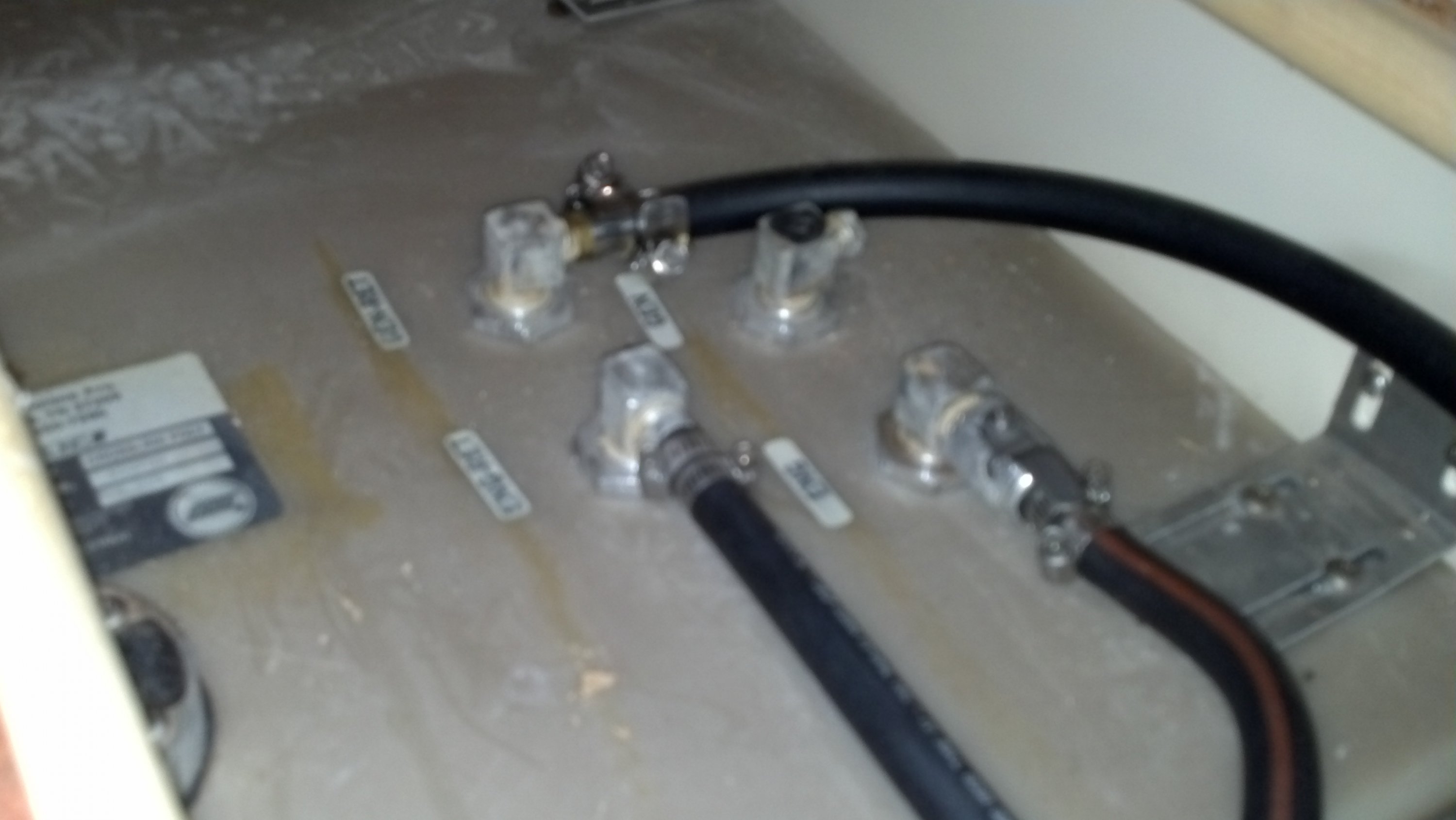

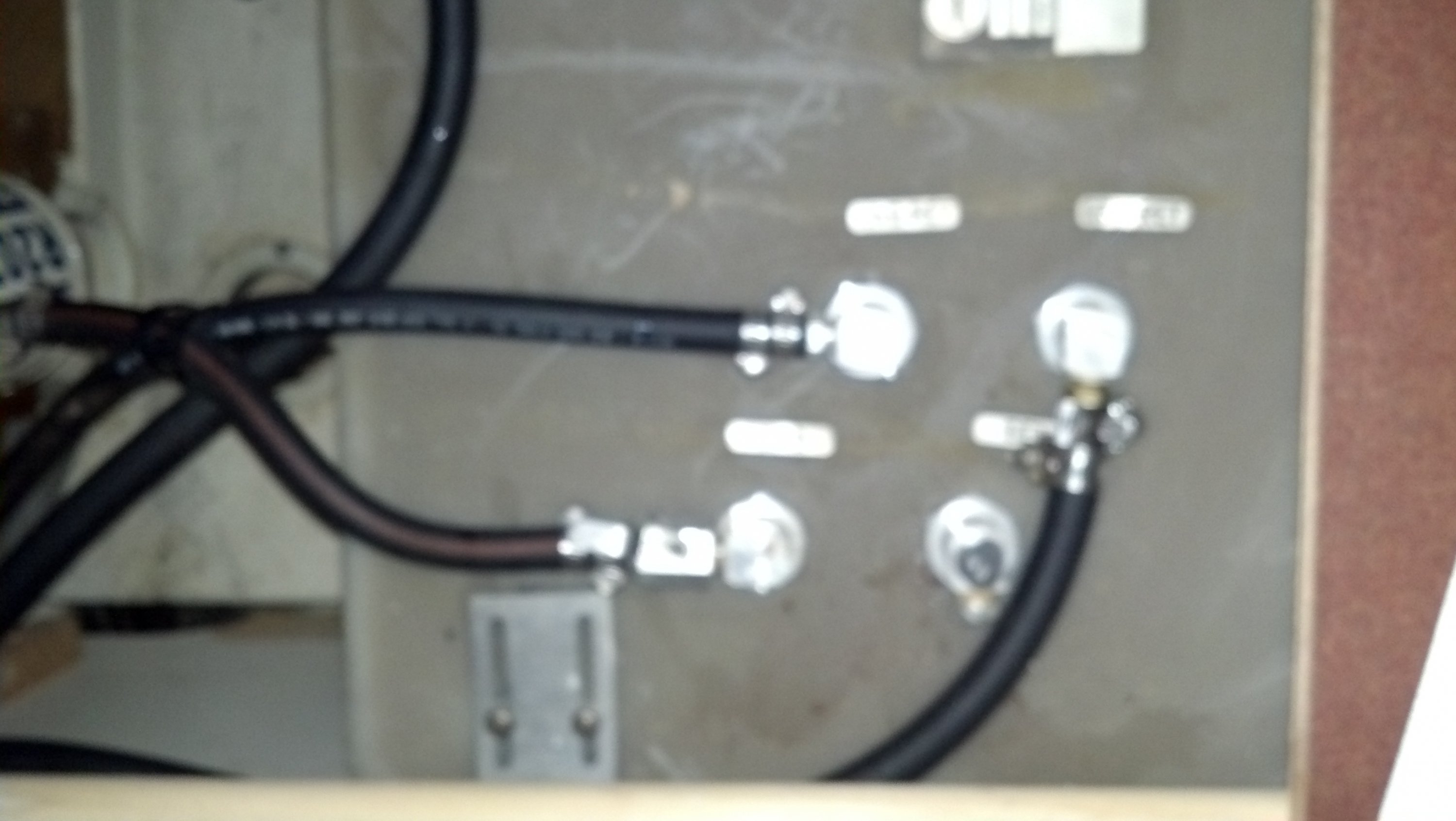

I have a Hunter 356 2002yr, and am trying to find where I am getting diesel smells from. The tank is a Crosslink Poly plastic tank made by Inca.
I have pressure tested the tank and fuel lines using a inflatable dingy pump to about 2psi, but can find no fuel leaks or air leaks using soapy water at all the fuel line connections on top of the tank, or the dry paper towel test on any of the hoses/injectors/fuel pump etc.
I have replaced the fuel return line from the engine which was giving out a slight odour, all the other fuel lines and tank seem to pass the "damp rag test".
The smell seems to be mainly around the aft end of the tank, and worse after the engine has been run for some time.

You didn't mention the tank vent line or whether you plugged it prior to pressure testing.

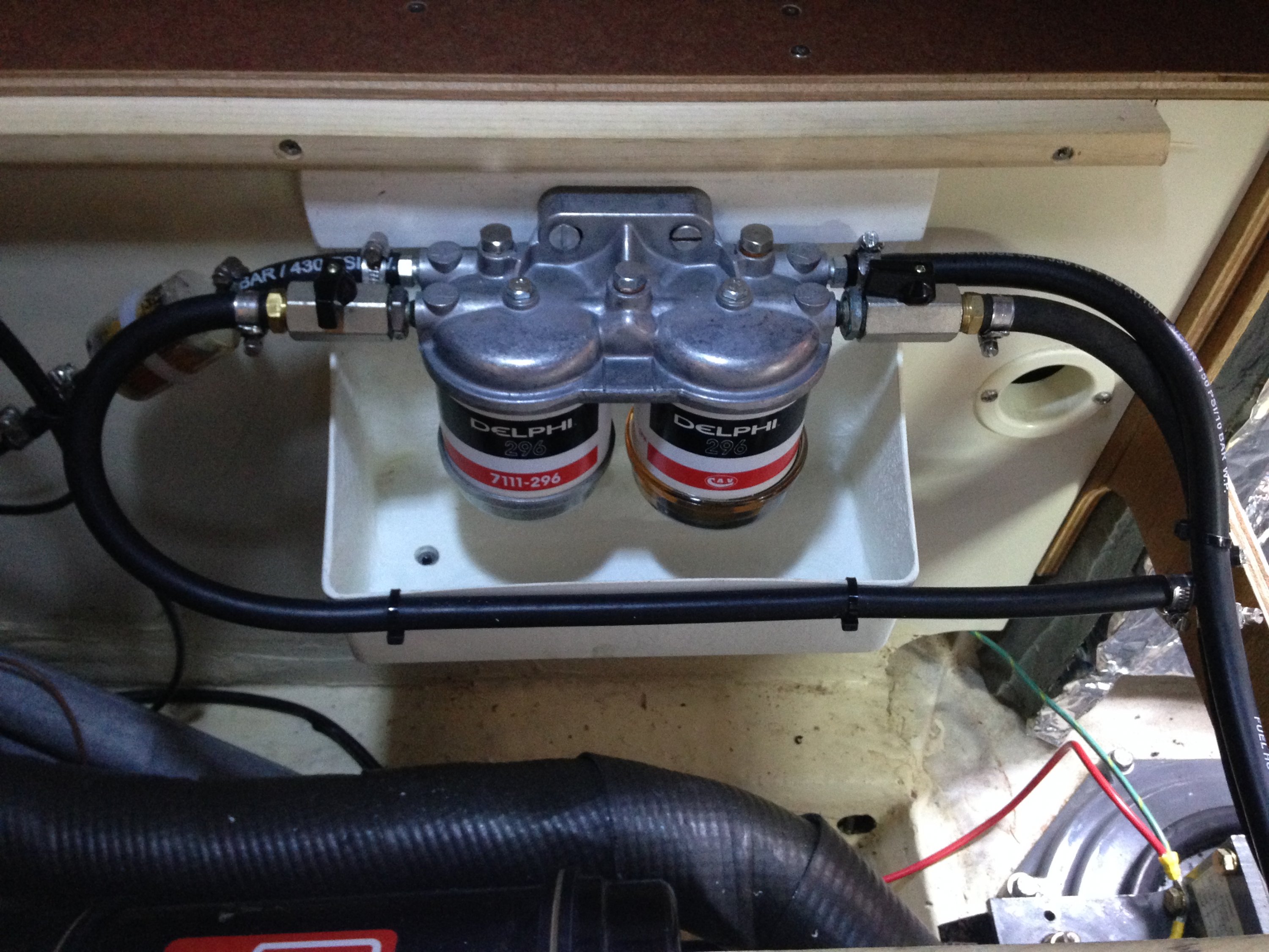

I replaced the Racor filter with a pair of Crossland, I didn't like the silly small space the Racor was fitted in, nor the filter. No smells from them as they are now in an easier access area.
I don't think the Racor filter was ever renewed with the previous owner, as the engine had only done about 50hrs!

The Racor is the fuel filter, on my H356 it was mounted between the tank and the fwd bulkhead just in front of the tank. Very difficult to get to. I prefer the filters that have a glass bowl at the bottom so you can see the fuel condition and any water collecting. So I fitted a double CAV filter assembly plumbed so I can use either filter, this is so I can switch to a fresh filter "on the go" should I get a filter blockage. I made a catch tray to go underneath it so that when changing filters any droplets won't end up in the bilge. The small hole you see in the bottom of the tray is a drain valve.
Thanks for the reply and photo.
