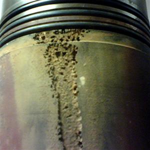

b. Diesels using wet sleeve liners can be prone to cavitation pitting if run at high load factors. This is why there is an ASTM HD coolant spec (D 6210). Non-sleeve engines are less susceptible, but are NOT immune. Many are now recommending OAT (like Dexcool) coolants, because although not HD, they good enough against pitting for non-liner engines and because they are widely available. Of course, always read the manual, since there may be engine-specific factors.
The cavitation is caused by piston slap on the cylinder wall during the down stroke.
