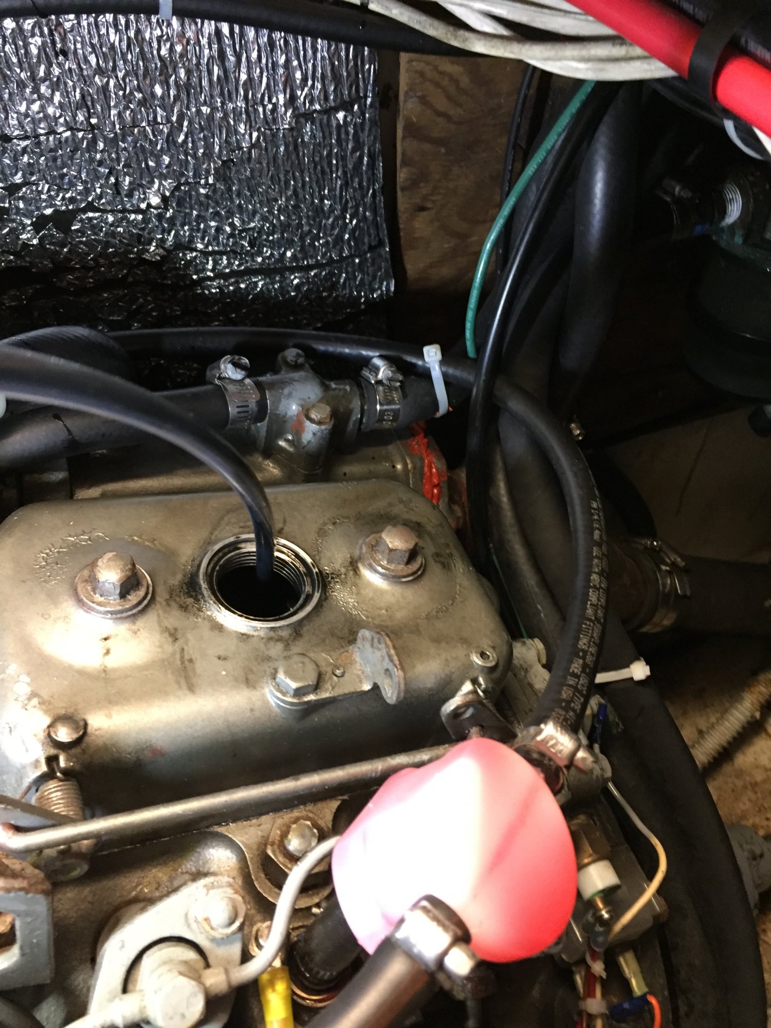

I have mentioned this before, but today I have a photo. Most of us have tried to pump out our crankcase oil through the dip stick port. Depending on the angle that the engine is installed this never results in completely emptying the crankcase. The oil is, of course, at the rear lowest part of the oil pan. The dip stick is in the center. I discovered on my Yanmar 2QM15 that I can easily fish the plastic suction hose down through the oil fill port, into the engine block, through the valve push rod opening and down to the very bottom and rear of the oil sump. This allows me to remove virtually every last drop of oil in the engine. After replacing the filter, refilling the oil, and running the engine, the oil on the dipstick is clean without any black coloring. I suspect that most diesel engines may be similarly emptied of old oil.

I don't think I could get a drain pan low enough and large enough to drain into. If I could, how would I ever get it out without spilling the oil? The fitting looks like it has threads on the inside. First step in adding an electric drain pump maybe? The only way to be sure you're picking up "gunk" at the bottom is gravity drain from the pan
I may try the oil fill cap next time. Judging by how much I remove, the dipstick hole seems to get almost all.
