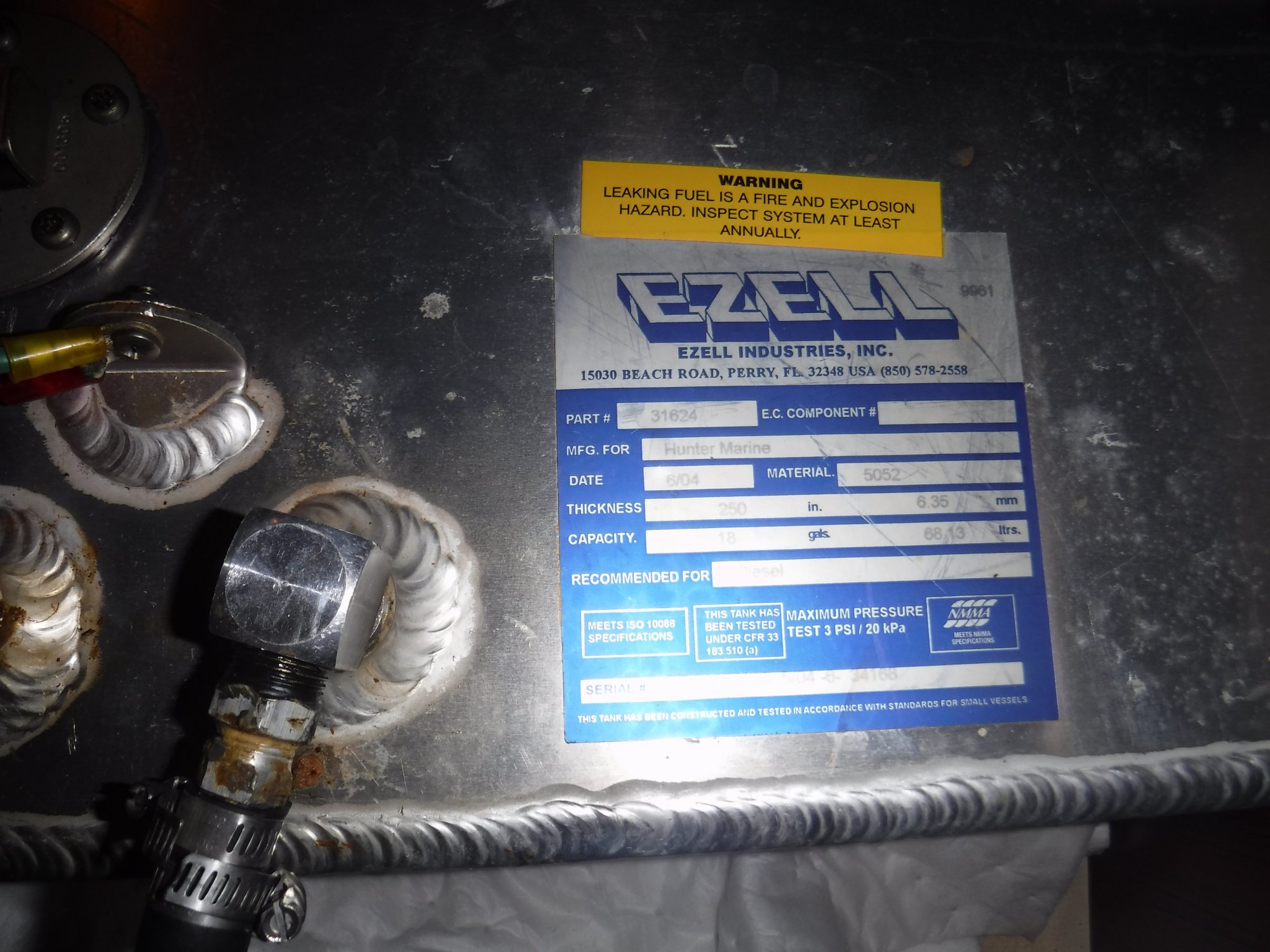

I found the leak. It's on the top of the axillary tank (we did not add fuel to the axillary tank yesterday). What I would call the sending unit has a slight leak. There is a hose between the main 35-gallon plastic tank to the axillary aluminum 18-gallon tank to level excess. The second hose to pump from the axillary tank to the main tank has a petcock, and it's closed. I believe the 18-gallon tank to be original from Hunter. That's just a guess. Solution: 1. Seal the sending unit. 2. Don't overfill in the future. The previous owner had some absorbent towels there. I think this was a known problem.

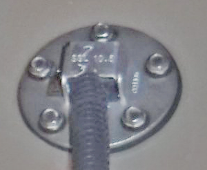

Hard to tell what the flange of the sending unit is sealed with.
From the tidy appearance, it may just be a dry gasket. I suffered the same problem from a first overfill with a weeping fuel leak on a factory original gasket installation.

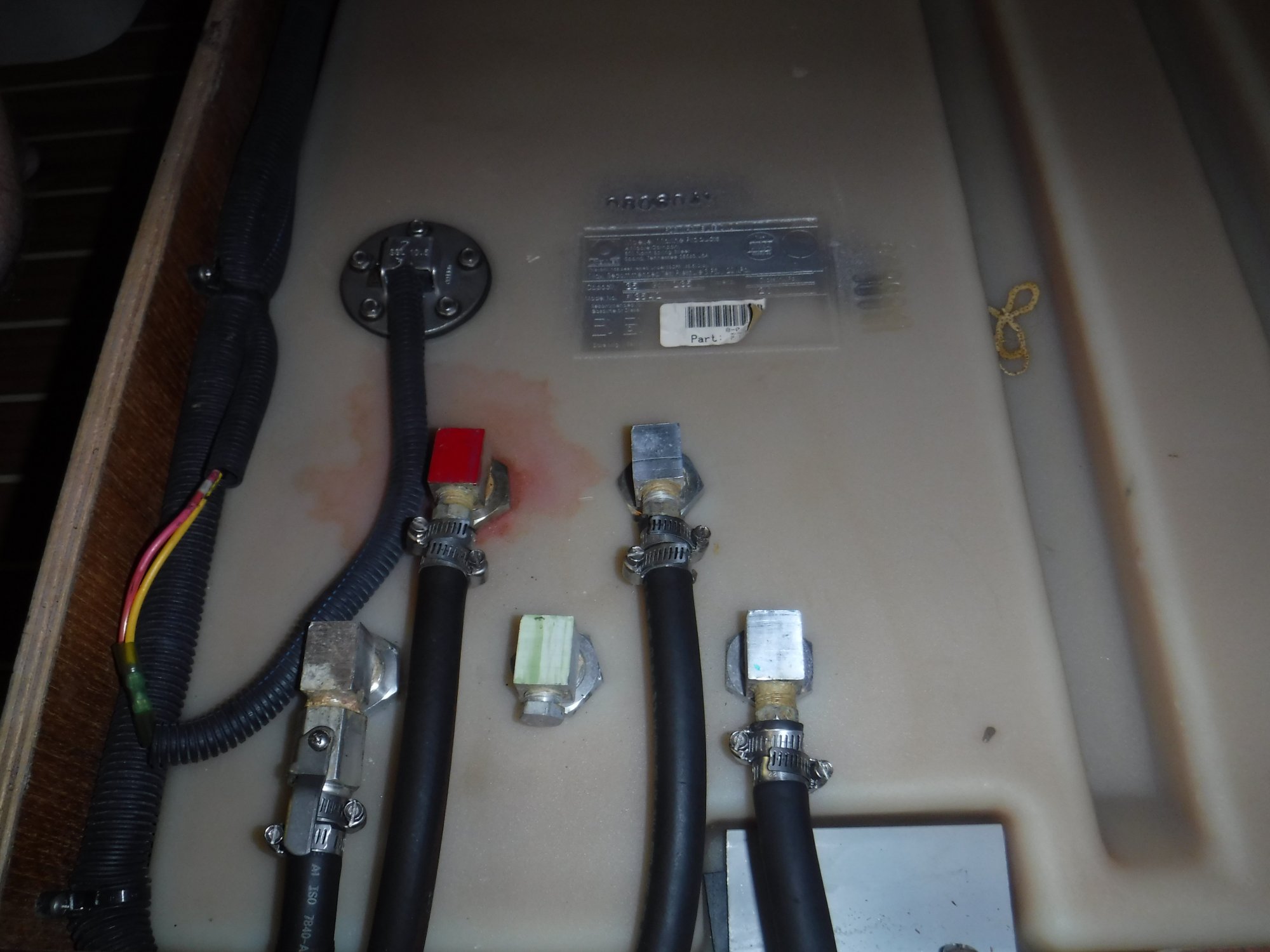

The only thing I've ever seen stick to poytethylene is Permatex #2. It's so bad, it'll leave permanent stains on the boat two berths down from you :yikes: . It's rated for all petroleum fuels.
This was taken after I resealed ALL the fittings on top of the the fuel tank. Slightly overfilled the tank and everything was sealed with not a drop around any fitting.
