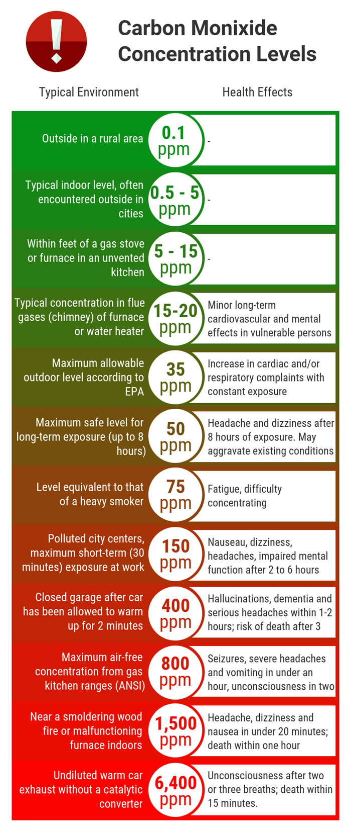

according to the manual, 0-1ppm is normal inside reading. 9ppm is the max according to osha, or whoever comes up with air quality stats. 35ppm is deemed unsafe after 8hrs and 200ppm will give a normal person a headache after 2-3hrs.

if it takes 2-3hrs of breathing 200ppm to create a headache for the average joe i don’t think someone more sensitive breathing 5ppm continuously could get a headache immediately.
