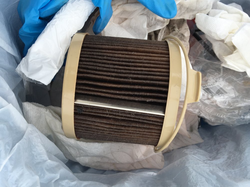

Have you had any issues in the fuel filter? Is it clean?
When you changed the fuel filter did it look like this?
This is what a dirty fuel filter looks like.

Tank is full and clean ,filters both primary and secondary are clean changed season before las haul out and those filters were clean
