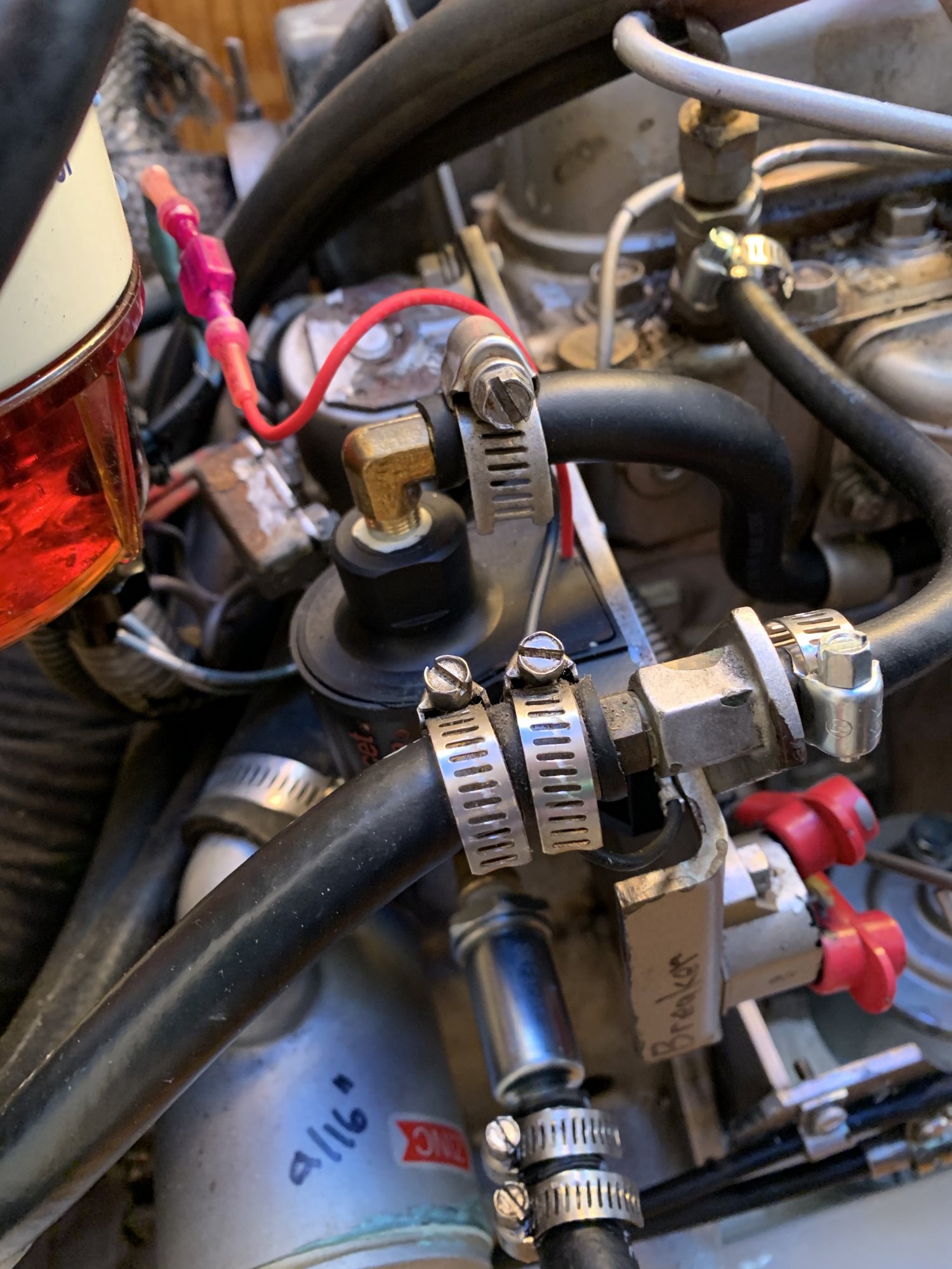

On a similar note-while working on our engine recently I bent and cracked the fuel return line from the injector block. It’s 3/16” ID and I couldn’t find it in A-1-15 anywhere. Apparently that size is used on a lot of outboards. Replacement was easy, once I had the hose. BTW, 1/4” wouldn’t work; leaked no matter how tight the hose clamp was.

The fuel line I’m talking about is a short run (maybe 6-12”?) from the injector block to a barbed fitting at the rear of the engine. The other side of the fitting connects to the 5/16” id line that returns to the tank.
Nov 16, 2012
1,055
Catalina 310, 2000, #31 31 Santa Cruz
Here’s a photo of the small ID line on the right, and the bigger one on the left.
