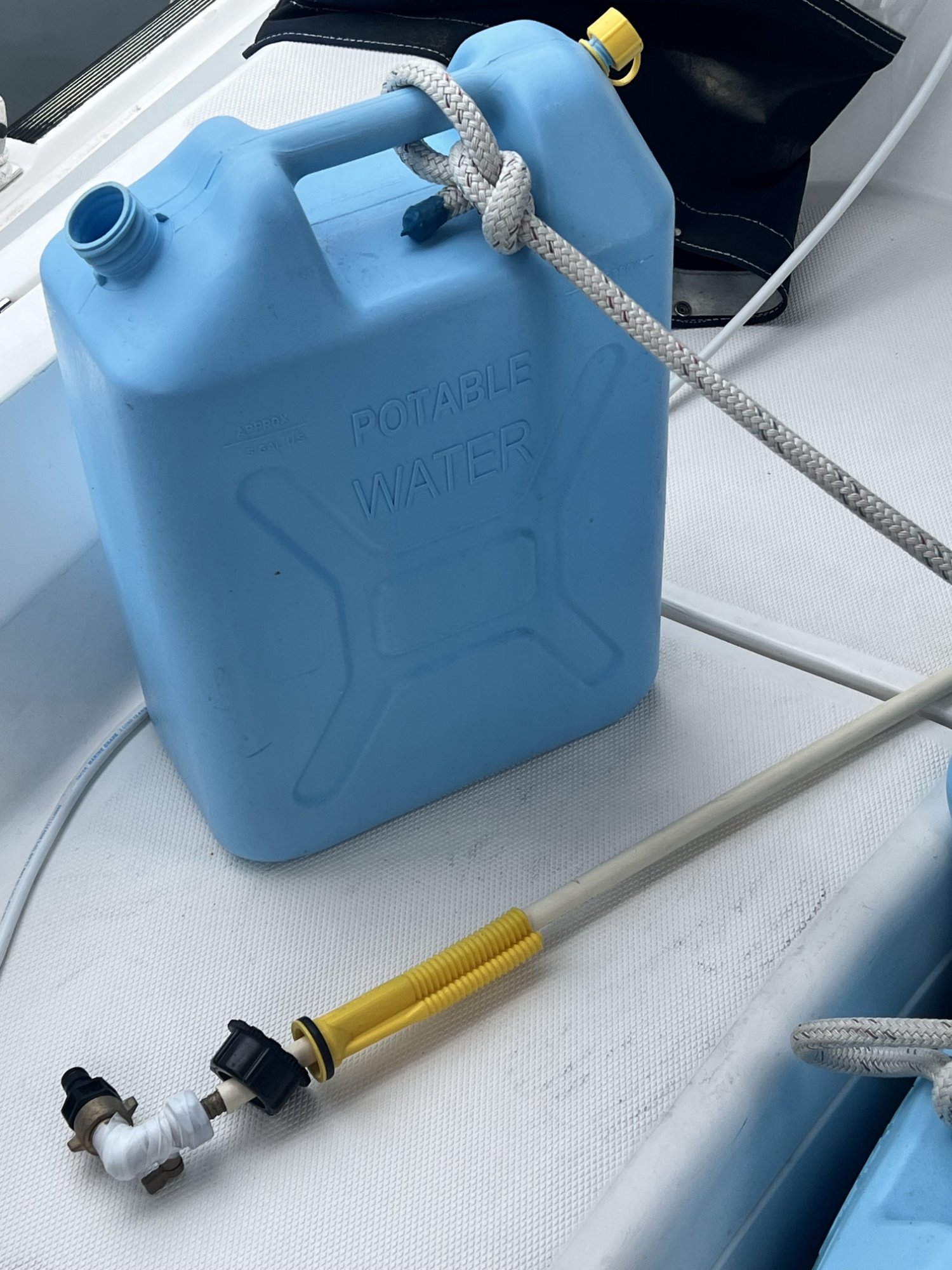

This is what I meant with the term 'spout down' in my earlier post.
This is the setup for my water cans.
For diesel, with the newer AA battery powered transfer pump, it attaches directly to the can so this kind of thing is no longer needed.
I still have the setup for diesel stored away in case I need to do a manual siphon, and also needed it back when I had a different transfer pump that didn't attach directly on the can.
I also use a dewalt-battery-compatible water transfer pump to top up the boat water tanks from the water cans.
It just connects to this, as does the garden hose for filling the cans up shore side.
EDIT: The 90-degree is a regular garden hose fitting and the black thing on it is a regular garden hose 'quick connect'.

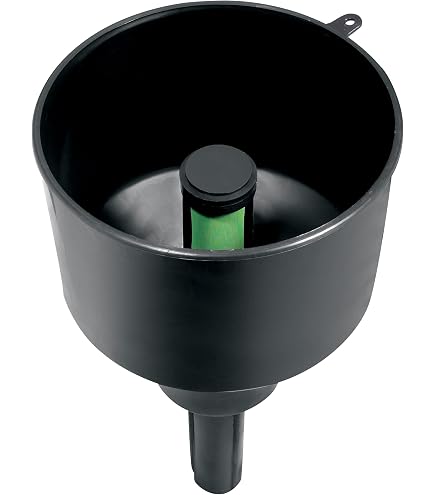

I'm a bit surprised by all this talk of pouring or pumping diesel directly from jugs into the tank. Nothing goes in my diesel tank without first going through a Racor Fuel Filter Funnel:
Do you use this filter when pumping from a dock pump also? How much fuel do you take on when filling your tanks?
