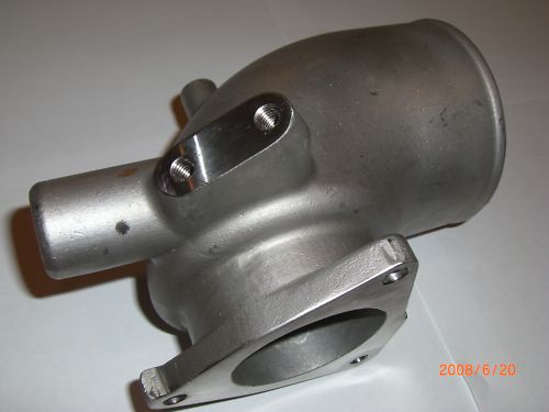

Since my problem cleared up on its own, I am guessing the elbow is not the issue.
